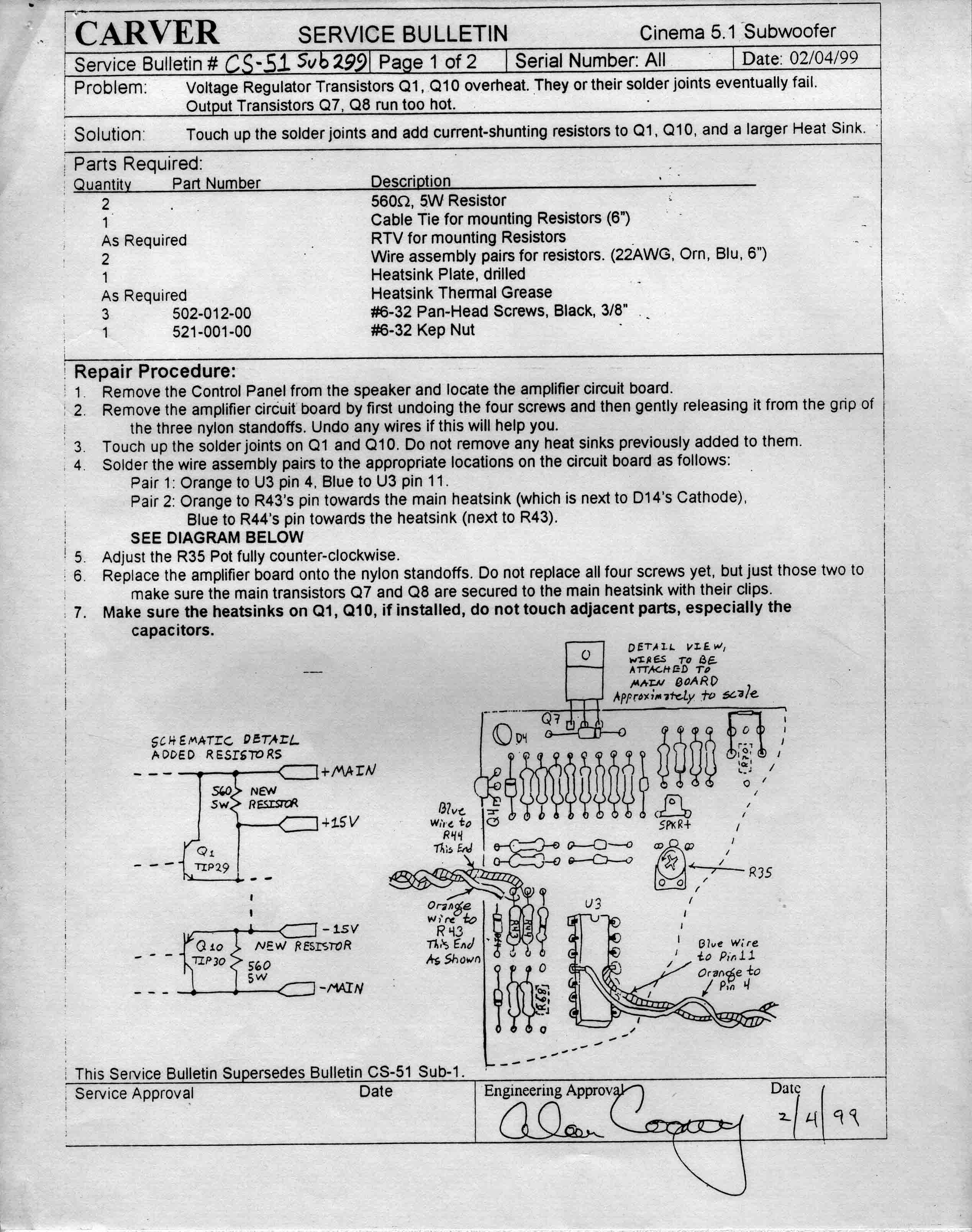

5.1 Subwoofer Woes...
The 5.1's weren't without some issues, however. Probably the most notorious issue was with the Subwoofer. Due to a defect in the design, after a while the built in amplifier in the 5.1 Subwoofer would burn out. Carver had a modification for the amp that solved the problem, but a fair number of these otherwise great Subwoofers either got returned or sent back to Carver for repair. Below you will find the complete factory service bulletin for performing the modification. Its pretty straightforward, but not for the faint of heart. I recently picked up a complete set of 5.1's from Craig's List, and was interested to note that the Subwoofer had already had the modification!

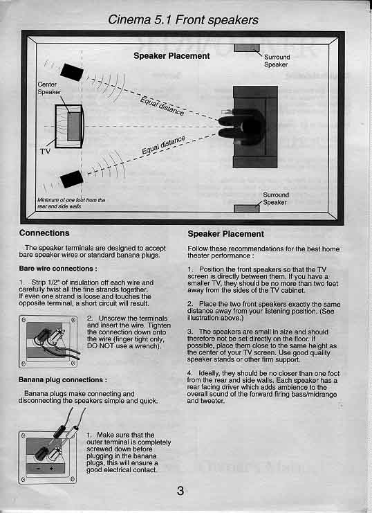

  Carver Cinema 5.1 - Front Channels - Owners Manual
Complete Manual in PDF Format
Page 1
Page 2
Page 3
Page 4

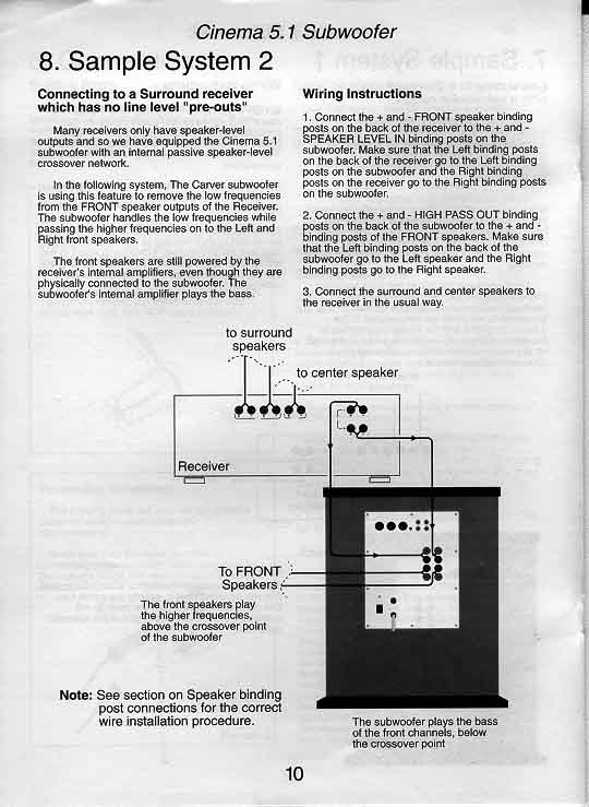

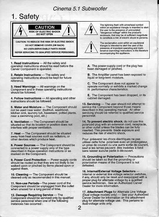

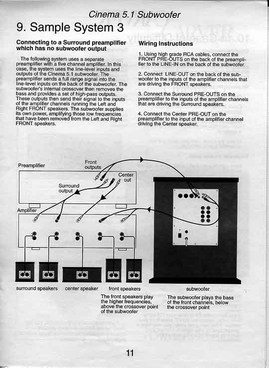

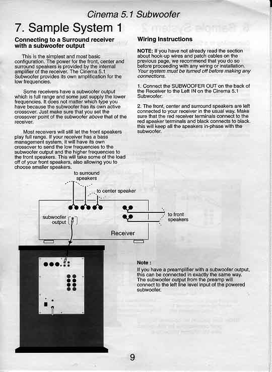

  Carver Cinema 5.1 - Subwoofer Channel - Owners Manual
Page 1
Page 2
Page 3
Page 4
Page 5
Page 6
Page 7
Page 8
Page 9
Page 10
Page 11
Page 12

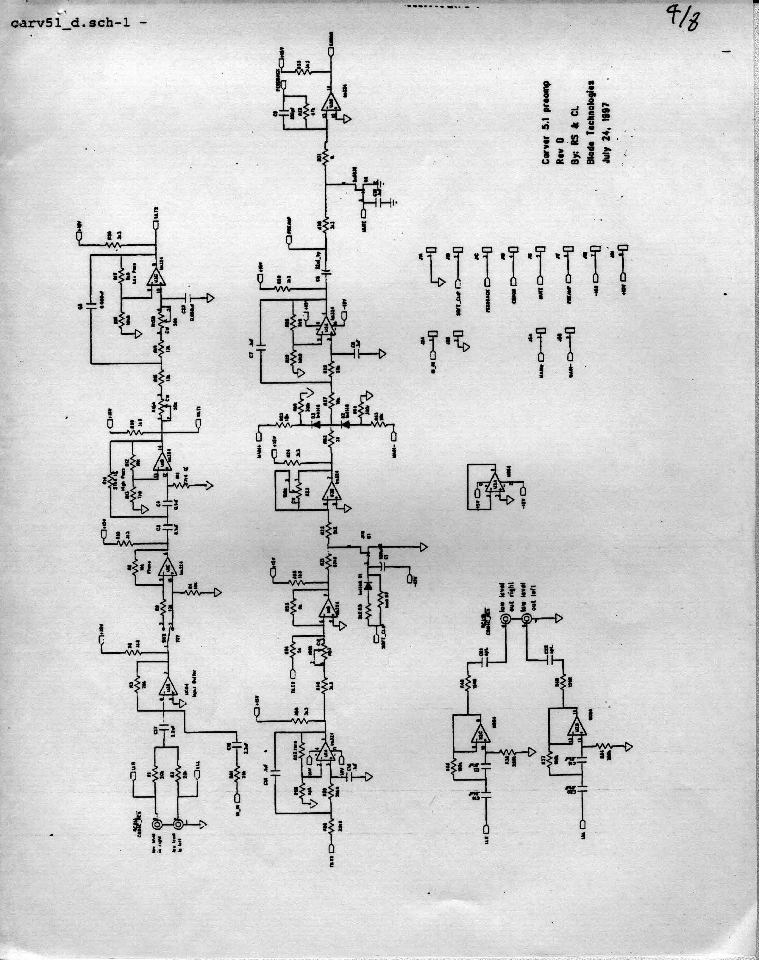

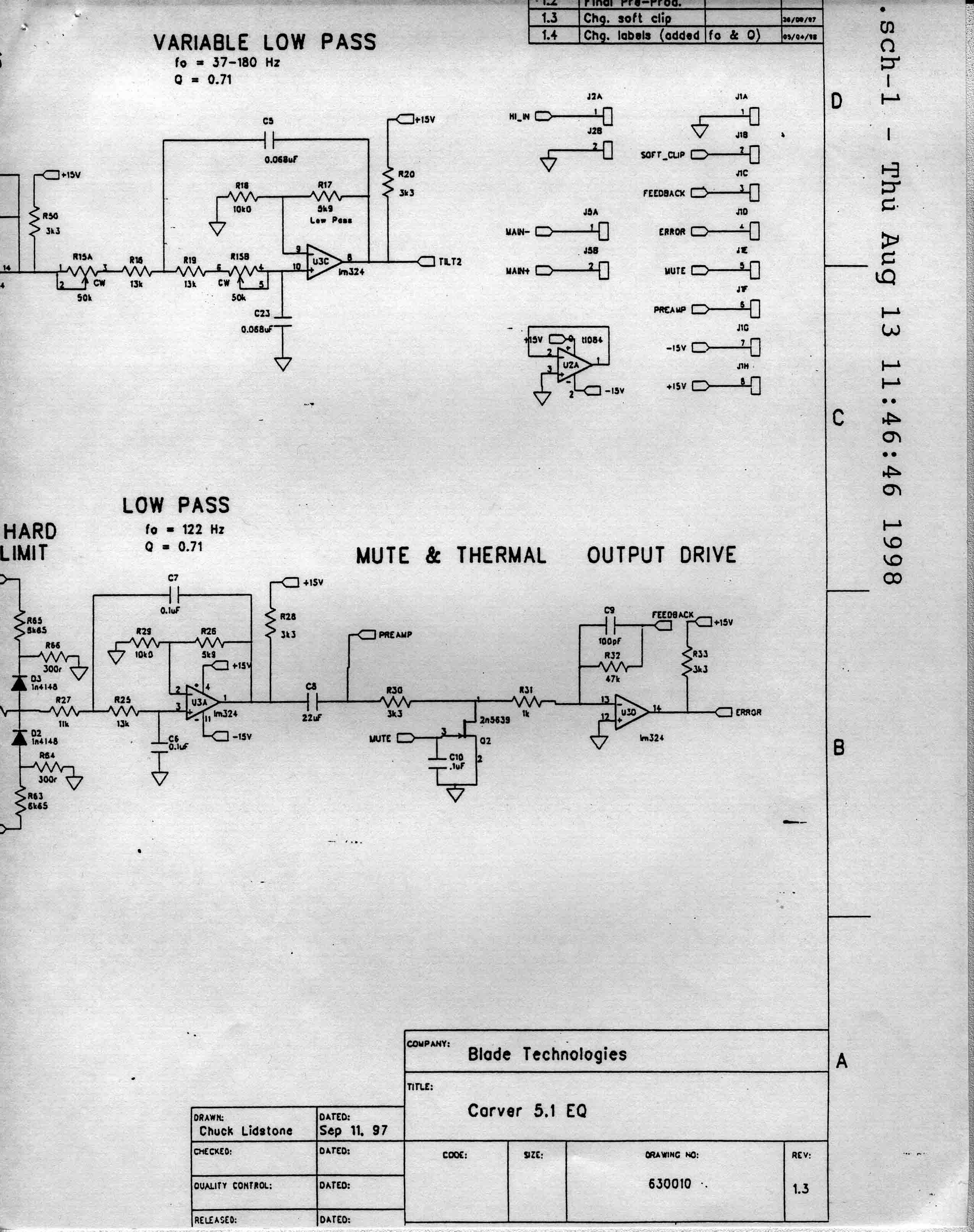

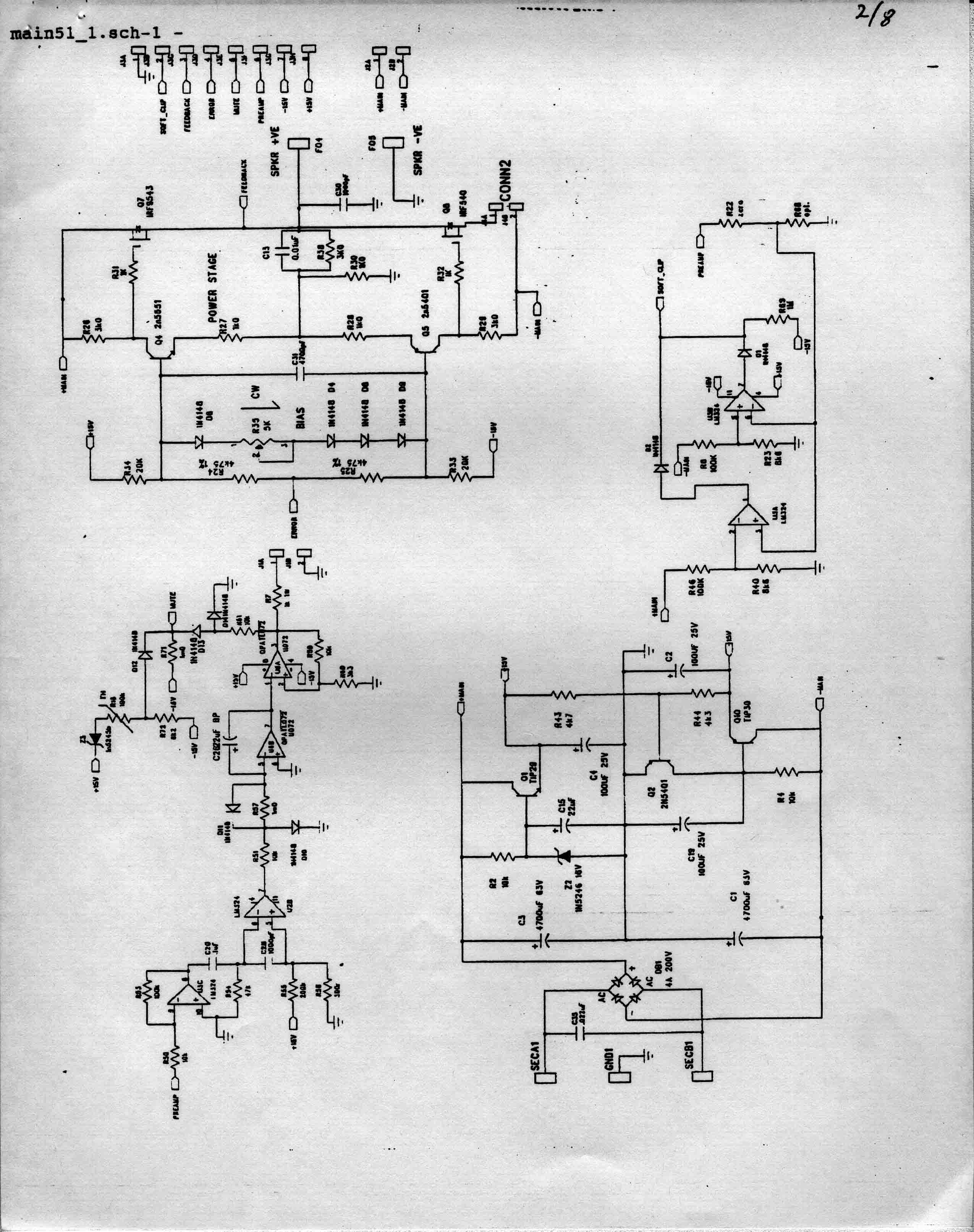

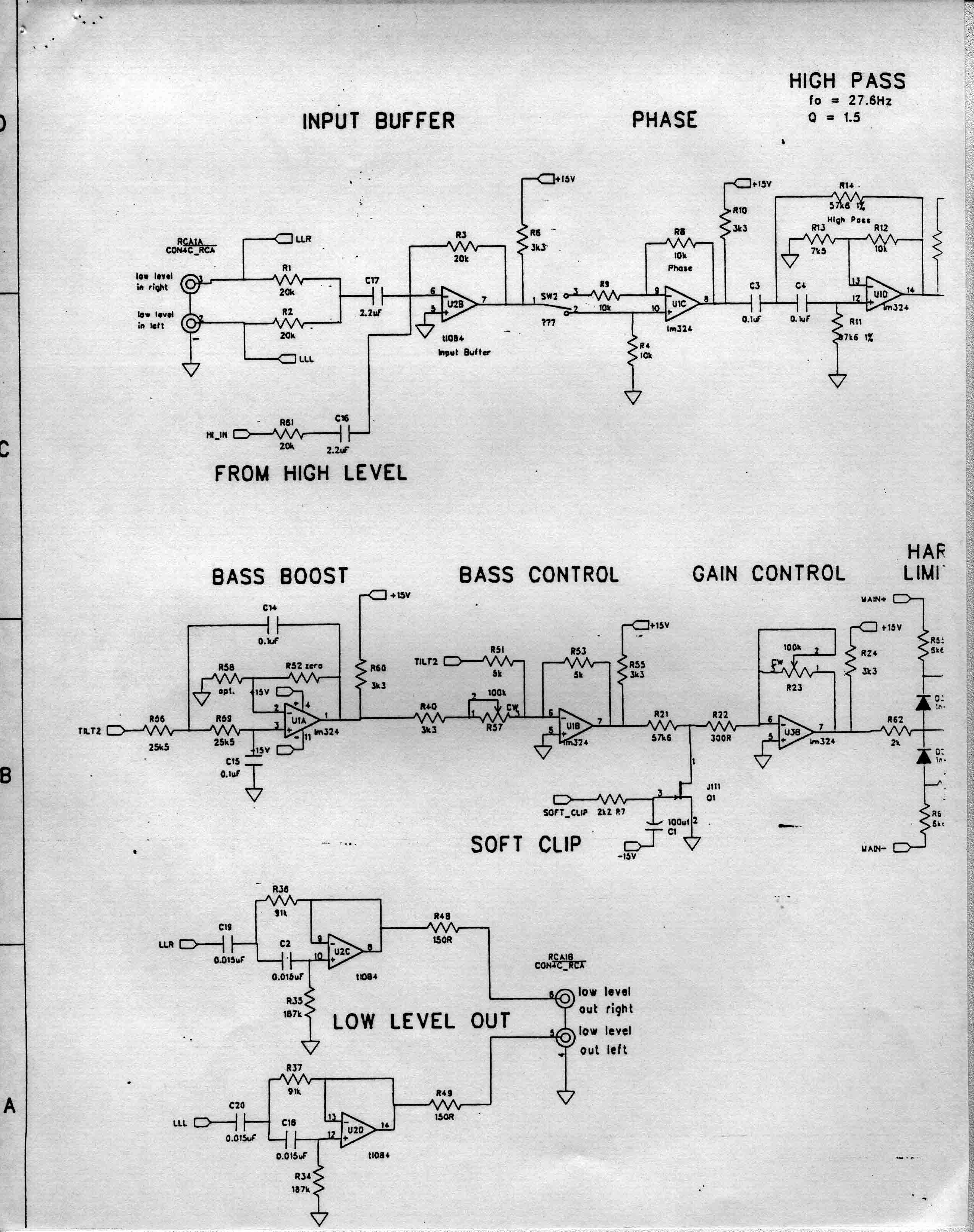

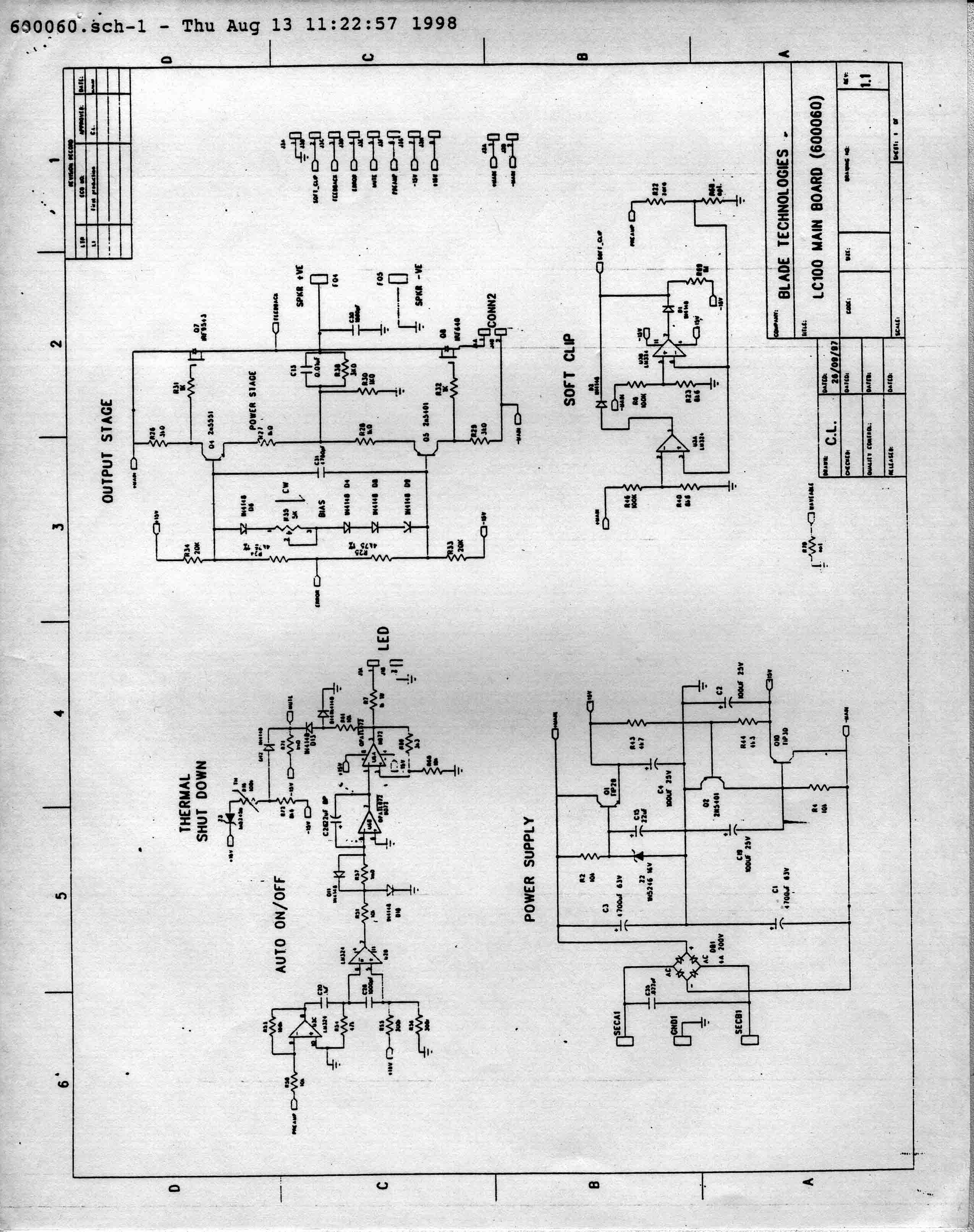

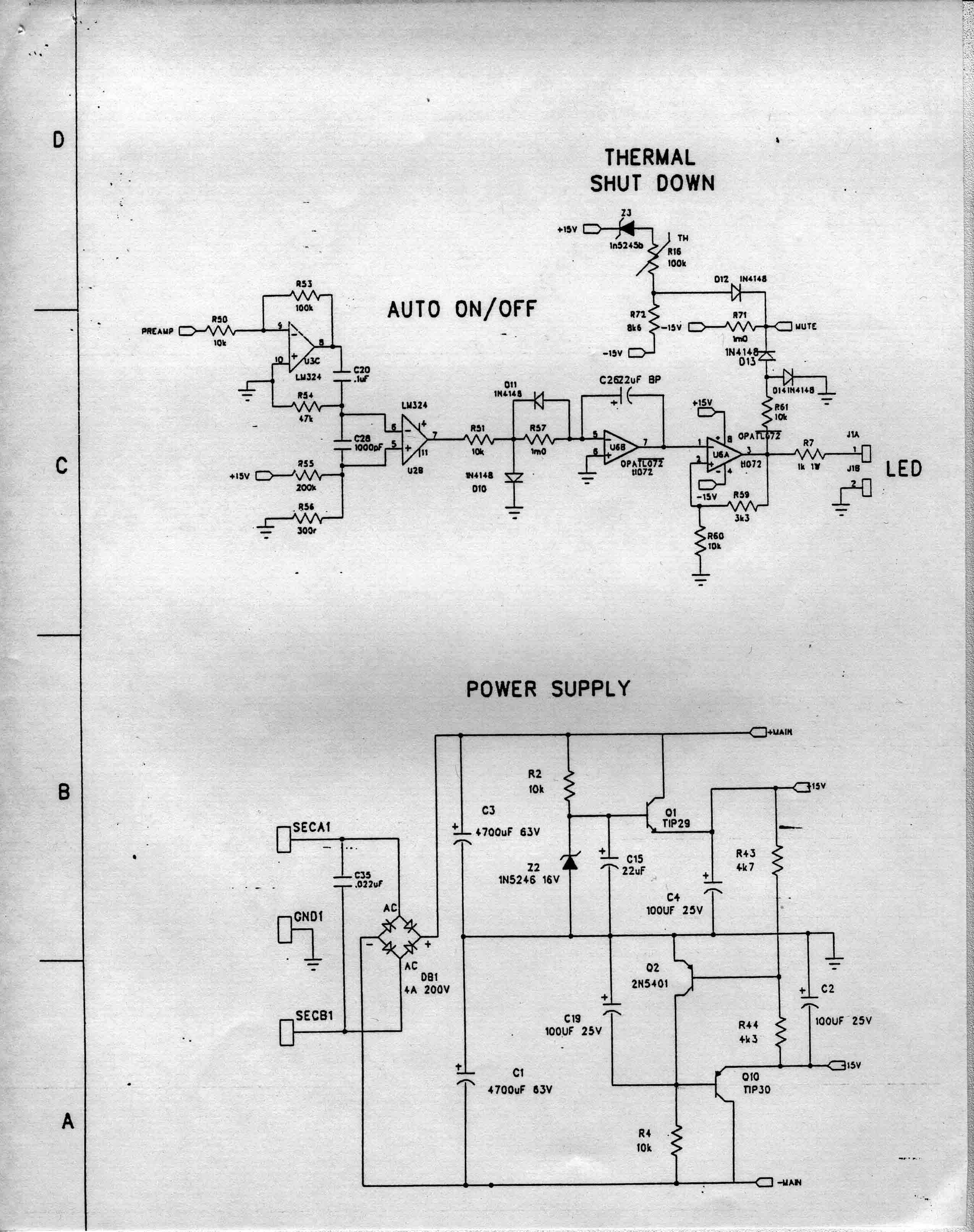

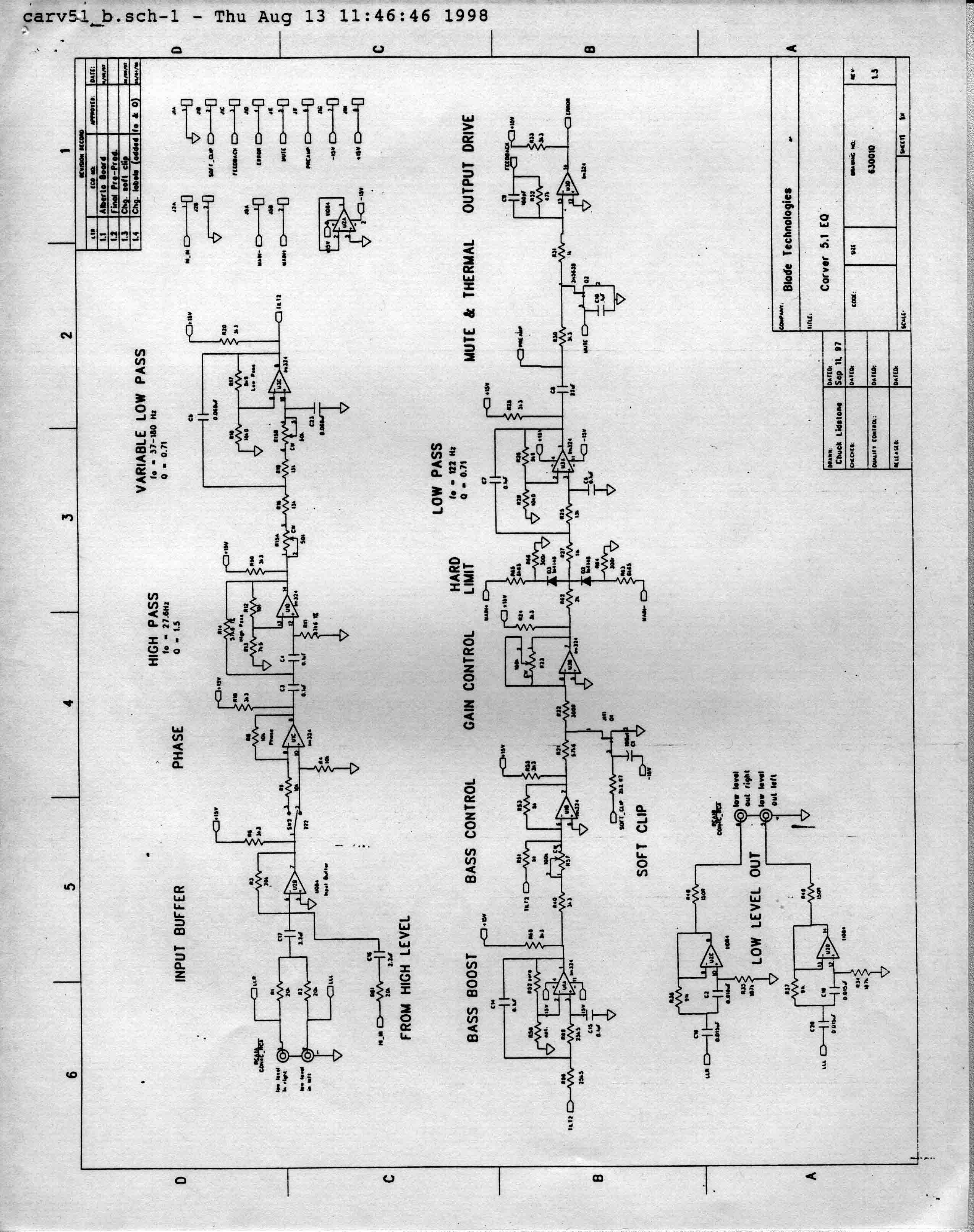

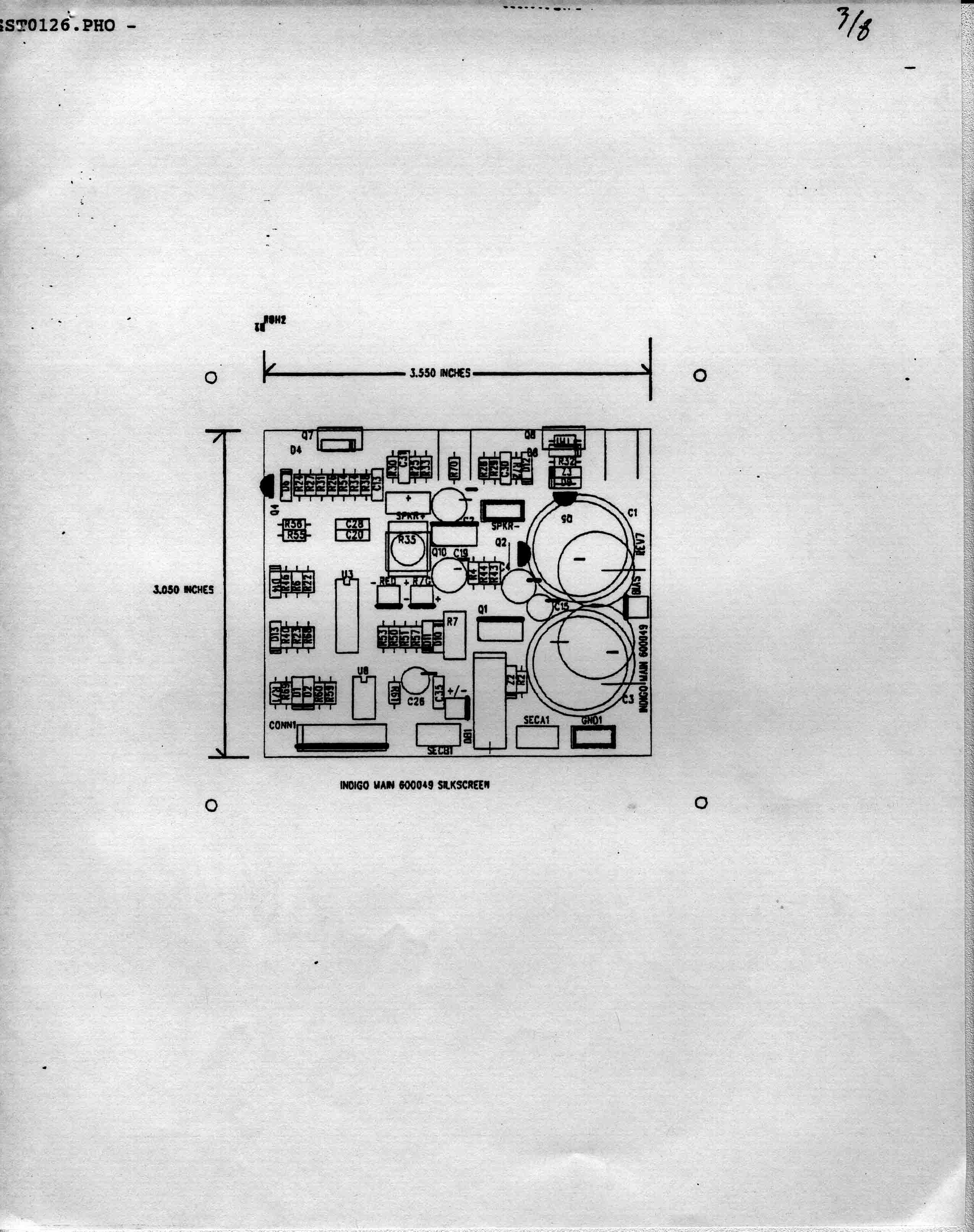

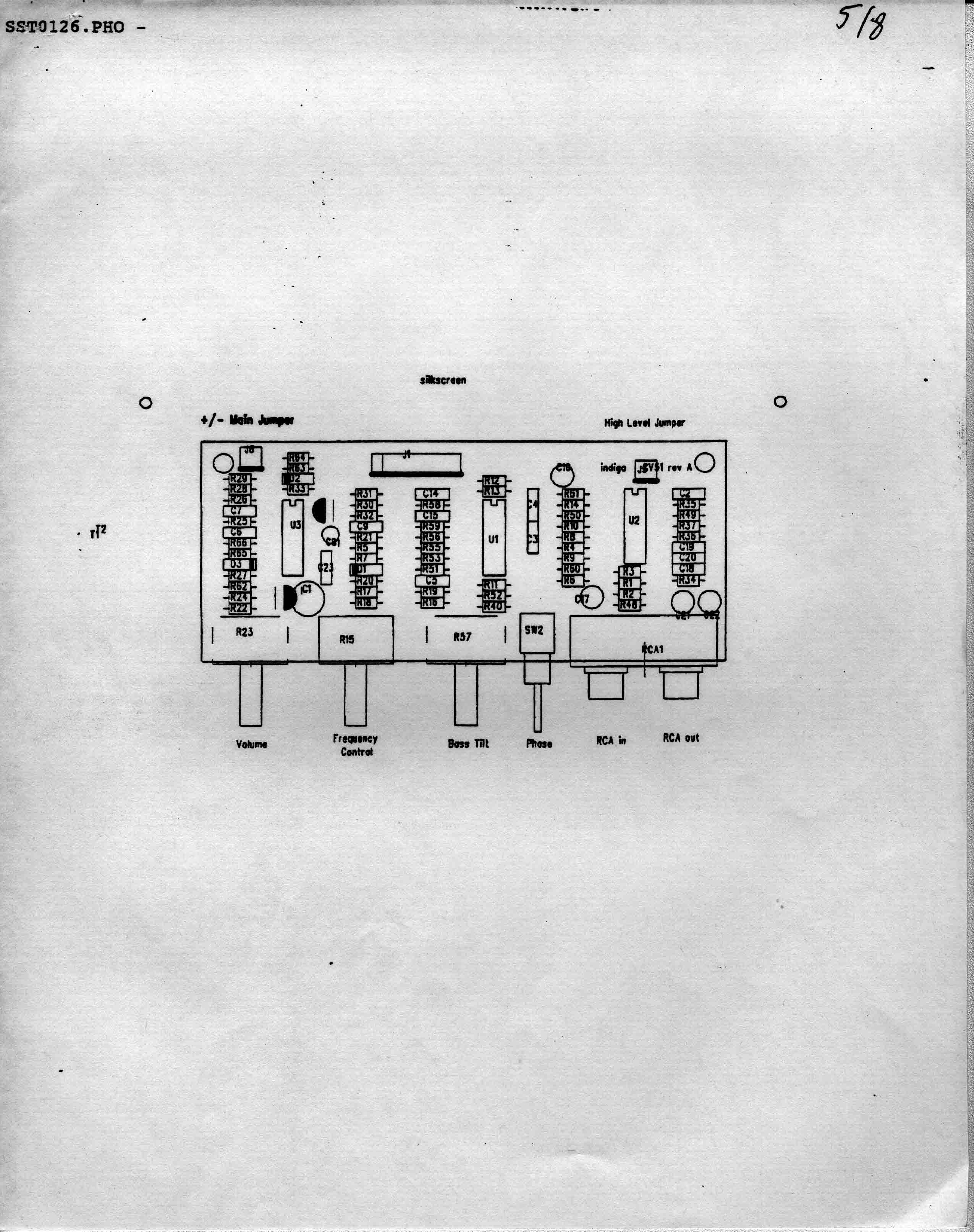

  Carver Cinema 5.1 - Subwoofer Channel - Schematics
Page 1
Page 2
Page 3
Page 4
Page 5
Page 6
Page 7
Page 8
Page 9
Page 10
  Carver Cinema 5.1 - Subwoofer Channel - Service Bulletins 1 and 2
Page 1
Page 2
Page 3

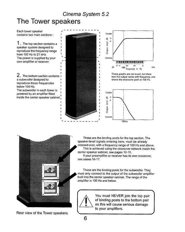

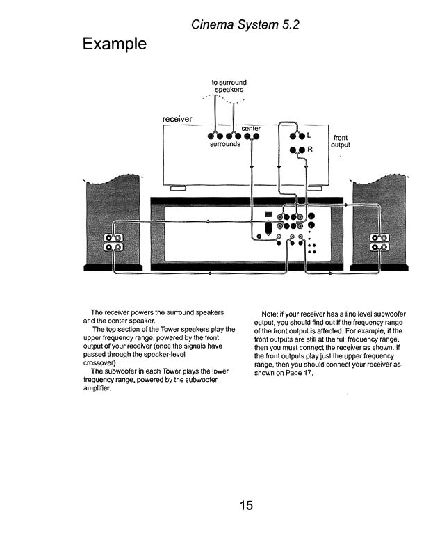

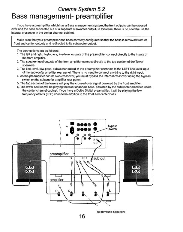

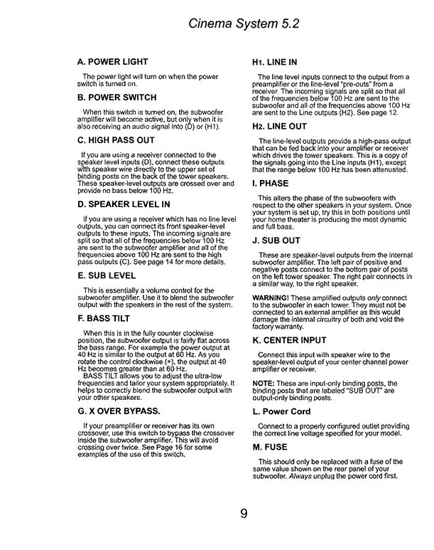

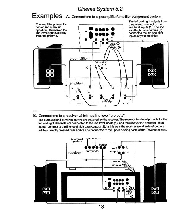

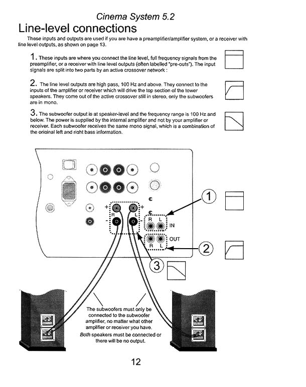

  Carver Cinema 5.2 - Towers and Center - Owners Manual
Page 1
Page 2
Page 3
Page 4
Page 5
Page 6
Page 7
Page 8
Page 9
Page 10
Page 11
Page 12
Page 13
Page 14
Page 15
Page 16
Page 17
Page 18
Page 19

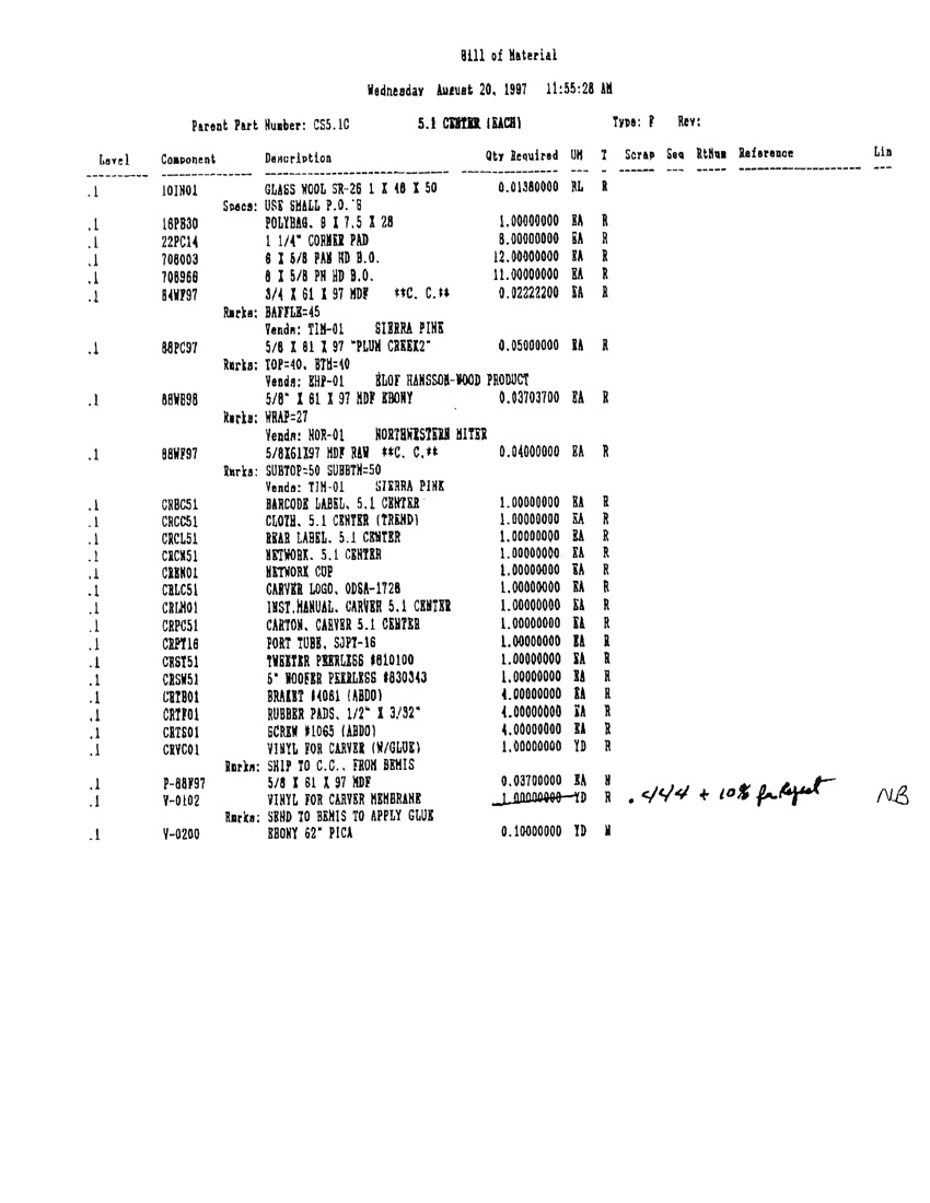

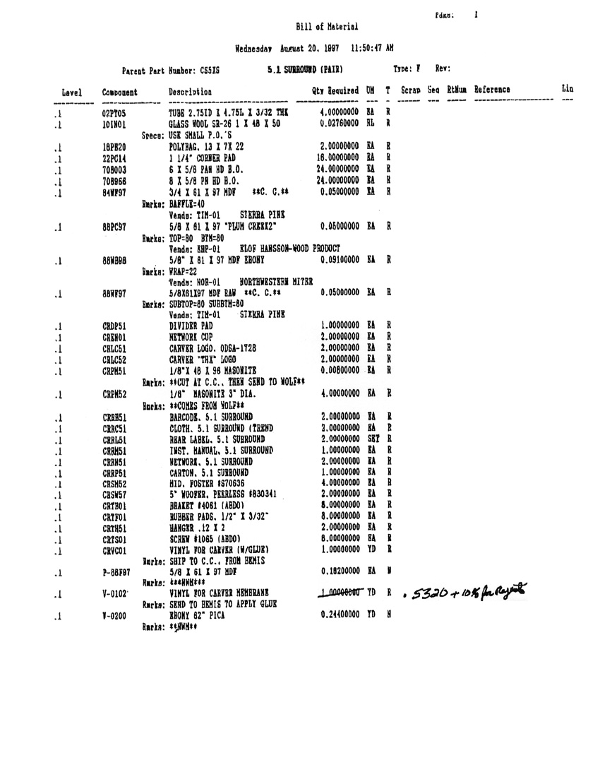

  Carver Cinema 5.1 - Bill of Materials
PDF Format
BOM - Center
BOM - Mains
BOM - Surround
BOM - Sub
JPG Format
BOM - Center
BOM - Mains
BOM - Surround
BOM - Sub
