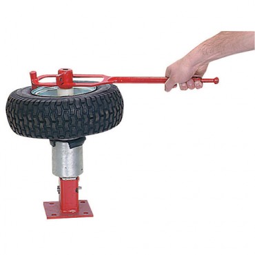

It seems like a week or so back we discussed breaking a bead with a small tire tool from harbor freight... And this week how to install tires on dessors web page. If you offer to send someone a round trip ticket and lodging fees,,, I'll bet someone would take you up on it... The information is out there Boyd Young On Mar 13, 2016 9:08 PM, "Bill Berle" wrote: > > "Carolina Flyer" wrote: And I don't plan I come > to California for any reason . > > OK Joe, I saw the price on the Matronics website. It is a very good price > for a custom wheel and tire set. > > I understand that you aren't happy with the idea of coming to CA to remove > the tires from the wheels when I need to chenge or repair them... so don't > you think you should tell me how I'm supposed to do it myself in the field? > > Once again, with 100% sincere respect, for any tire and wheel combination > that I put on an airplane, I will need to know how to service, repair, or > replace the components. > > I could be wrong, but I would imagine anyone else on this discussion forum > would want to know that too. > > ________________________________________________________________________________

Bill, I use a cheap harbor freight device for putting the tires on, cost $49.95 I think. Rick, The only tires that I sell are these that I have pictures of and they fit on a 8 inch rims -------- Kolb Firestar II 503 C-Box / RK400 Soon to have a Rotax 670 DCDI with a C-Box and RK 400 Clutch Challenger II 503 Tall Drive Location : Buffalo South Carolina Read this topic online here: http://forums.matronics.com/viewtopic.php?p=453737#453737 Attachments: http://forums.matronics.com//files/image_133.jpeg ________________________________________________________________________________

I have three metal tire irons that I carry with me. Less than 1 lb. for the set and with a little water as lubricant they get the tire off a one piece wheel just fine. It's breaking the bead that's the trick and for that I just use a hammer with one iron to get it started. It's not what I'd use at home, but we're talking stranded in the outback with the vultures circling. :-} Rick Girard On Mon, Mar 14, 2016 at 9:16 AM, Charlie England wrote: > > The tires and wheels do look nice, and are likely a good option if flying > close to home. > > However, it seems like you're missing his point. He's talking about real > 'bush' flying, away from airports & service facilities. With conventional 2 > piece wheels, you could break them down with simple hand tools to repair a > flat, and a small hand pump to re-inflate. But with auto-style one piece > wheels, it requires specialized (heavy) tools to break a tire down for > repair. Not likely to be in a tool kit you can carry in a Kolb or other > very light a/c. > > Charlie > > On 3/13/2016 11:19 PM, Carolina Flyer wrote: > m >> > >> >> Bill, I use a cheap harbor freight device for putting the tires on, cos t >> $49.95 I think. >> >> >> Rick, The only tires that I sell are these that I have pictures of and >> they fit on a 8 inch rims >> >> -------- >> Kolb Firestar II >> 503 C-Box / RK400 >> Soon to have a >> Rotax 670 DCDI >> with a C-Box and >> RK 400 Clutch >> >> Challenger II >> 503 Tall Drive >> >> Location : Buffalo South Carolina >> >> > =========== =========== =========== =========== =========== > > -- =9CBlessed are the cracked, for they shall let in the light.=9D Groucho Marx <http://www.goodreads.com/author/show/43244.Groucho_Marx> ________________________________________________________________________________

From: Richard Girard <aslsa.rng(at)gmail.com>
you could also try this. I've never used it, can't make a recommendation. https://www.zoro.com/3m-flexible-foam-nvh-08463/i/G0406463/?gdffi=047ada9 98cf641fa93e55ae8579df863&gdfms=5EA4232146CF4B229C255AAAF651CF33&gclid= CPW8-dyLw8sCFQYIaQodCZwIjw&gclsrc=aw.ds Lots of Youtube videos about using urethane foam to fill tires, too, but it doesn't remain flexible so it'll crush up over time and make a mess in something like an aircraft tire. Rick On Mon, Mar 14, 2016 at 1:08 PM, Bill Berle wrote: > > Here's a potential game-changer solution right here... > > http://www.goldspeedproducts.com/shop/tire-blocks/ > > These are foam inserts that allow you to run lower pressure and even run > safely when punctured flat. > > I'll bet that these foam blocks weigh less than the three piece tire iron > set that was mentioned earlier, or the can of flat tire repair goop :) > > > Bill Berle > www.ezflaphandle.com - safety & performance upgrade for light aircraft > www.grantstar.net - winning proposals for non-profit and > for-profit entities > > -------------------------------------------- > On Mon, 3/14/16, Larry Cottrell wrote: > > Subject: Re: Kolb-List: Re: Tires for your Firestar > To: "kolb-list(at)matronics.com" > Date: Monday, March 14, 2016, 10:37 AM > > " > I > will have a small lightweight tool kit with me, and a tire > pump. Even on a certified172 I can take the wheel off the > airplane with a medium Crescent wrench, take the wheel apart > with three 1/4 inch bolts, replace an inner tube or patch a > tire, and get it back together to fly back > home." > > I just > carry a can of "spare tire" wrapped in bubble wrap > in the back of my plane. > Larry > On Mon, Mar 14, 2016 > at 10:56 AM, Bill Berle > wrote: > Bill Berle > > > Yes, I want to make it clear that I'm not trying to > hassle or trash-talk anyone or their product. I do prefer > not having to wrestle with someone just to get an answer to > my question, but regardless of the effort it takes to get > that answer my motives and agendas are positive and not > negative. > > > My situation is that I want to fly extreme-STOL up in the > mountains and desert. I've been scouting several > locations in my 172, and believe it or not most of them are > actually within 50 or 60 miles of the "big city" > limits. So it's not like I'm going out Grizzly bear > bow hunting in the Aleutian Islands or anything... but > it's still way too far for me to just "walk into > town" with a tire and wheel in my hands. > > > I will have a small lightweight tool kit with me, and a tire > pump. Even on a certified172 I can take the wheel off the > airplane with a medium Crescent wrench, take the wheel apart > with three 1/4 inch bolts, replace an inner tube or patch a > tire, and get it back together to fly back home. > > > Bill Berle > > -------------------------------------------- > > On Mon, 3/14/16, Richard Girard > wrote: > > > Subject: Re: Kolb-List: Re: Tires for your Firestar > > To: "kolb-list(at)matronics.com" > > > Date: Monday, March 14, 2016, 9:29 AM > > > I have three metal > > tire irons that I carry with me. Less than 1 lb. for the > set > > and with a little water as lubricant they get the tire off > a > > one piece wheel just fine. It's breaking the bead > > that's the trick and for that I just use a hammer > with > > one iron to get it started. It's not what I'd use > at > > home, but we're talking stranded in the outback with > the > > vultures circling. :-} > > Rick Girard > > On Mon, Mar 14, 2016 > > at 9:16 AM, Charlie England > > wrote: > > > Charlie England > > > The tires and wheels do look nice, and are likely a good > > option if flying close to home. > > > However, it seems like you're missing his point. > > He's talking about real 'bush' flying, away > from > > airports & service facilities. With conventional 2 > piece > > wheels, you could break them down with simple hand tools > to > > repair a flat, and a small hand pump to re-inflate. But > with > > auto-style one piece wheels, it requires specialized > (heavy) > > tools to break a tire down for repair. Not likely to be in > a > > tool kit you can carry in a Kolb or other very light > > a/c. > > > Charlie > > > On 3/13/2016 11:19 PM, Carolina Flyer wrote: > > > Flyer" > > > Bill, I use a cheap harbor freight device for putting > the > > tires on, cost $49.95 I think. > > > Rick, The only tires that I sell are these that I have > > pictures of and they fit on a 8 inch rims > > > -------- > > > Kolb Firestar II > > > 503 C-Box / RK400 > > > Soon to have a > > > Rotax 670 DCDI > > > with a C-Box and > > > RK 400 Clutch > > > Challenger II > > > 503 Tall Drive > > > Location : Buffalo South Carolina > > > ========== > > > br> > > fts!) > > > r> > > > > > href="http://www.buildersbooks.com" > > rel="noreferrer" > > target="_blank">www.buildersbooks.com > > > rel="noreferrer" > > target="_blank">http://www.matronics.com/contribution > > > -Matt Dralle, List Admin. > > > ========== > > > -List" rel="noreferrer" > > target="_blank">http://www.matronics.com/Navigator?Kolb-List > > > ========== > > > FORUMS - > > > eferrer" > > target="_blank">http://forums.matronics.com > > > ========== > > > b Site - > > > -Matt Dralle, List Admin. > > > rel="noreferrer" > > target="_blank">http://www.matronics.com/contribution > > > ========== > > > -- > > =9CBlessed > > are the cracked, for they shall let in the light.=9D > Groucho > > Marx > > > ========== > > br> > fts!) > > r> > > > w.buildersbooks.com" rel="noreferrer" > target="_blank">www.buildersbooks.com > > rel="noreferrer" > target="_blank">http://www.matronics.com/contribution > > -Matt Dralle, List Admin. > > ========== > > -List" rel="noreferrer" > target="_blank">http://www.matronics.com/Navigator?Kolb-List > > ========== > > FORUMS - > > eferrer" > target="_blank">http://forums.matronics.com > > ========== > > b Site - > > -Matt Dralle, List Admin. > > rel="noreferrer" > target="_blank">http://www.matronics.com/contribution > > ========== > > > -- > The older I get, the less tolerant I am of > those who are intolerant. > If you forward this email, or any part of > it, please remove my email address before sending. > > =========== =========== =========== =========== =========== > > -- =9CBlessed are the cracked, for they shall let in the light.=9D Groucho Marx <http://www.goodreads.com/author/show/43244.Groucho_Marx> ________________________________________________________________________________
