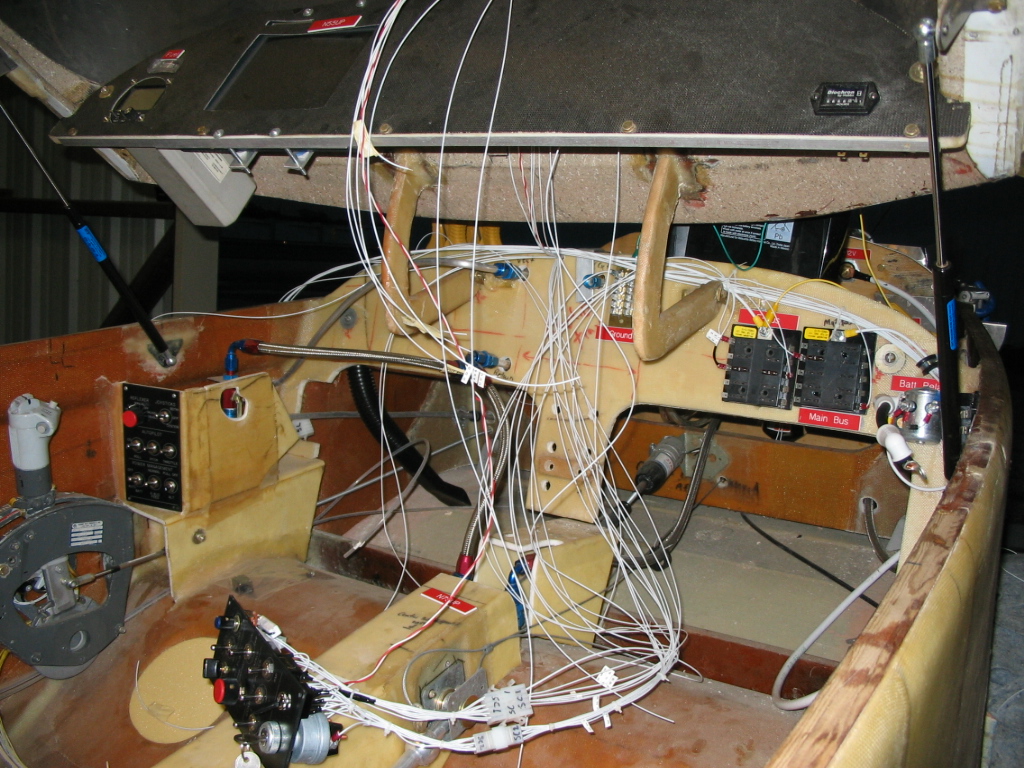

I've got a throttle quadrant from an F-100 and I'm going to use one of the
switches on top of the handle for my starter switch. That way I don't have
to take my hands off the throttle or stick to do an in-flight restart. The
key switch on the ignition is just for the ignition, and the starter won't
run with the key off either, but you don't turn the key to crank the starter.
http://www.davemorris.com/Photos/Dragonfly%20Electrical/WiringTheCenterSwitchPanel.jpg
Dave Morris
