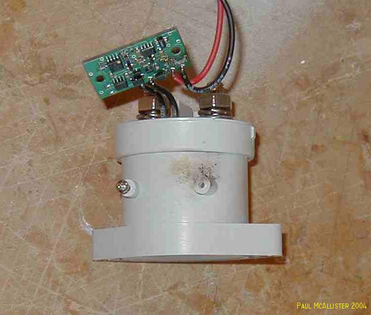

Yup, the S702-1 and it's close cousins have slain these
dragons too. Contact spreading velocity is fast enough to
keep arcing to a satisfactory level and transients were
never a threat to contactors . . . but the S702-1 comes
with it's spike catcher built right in.

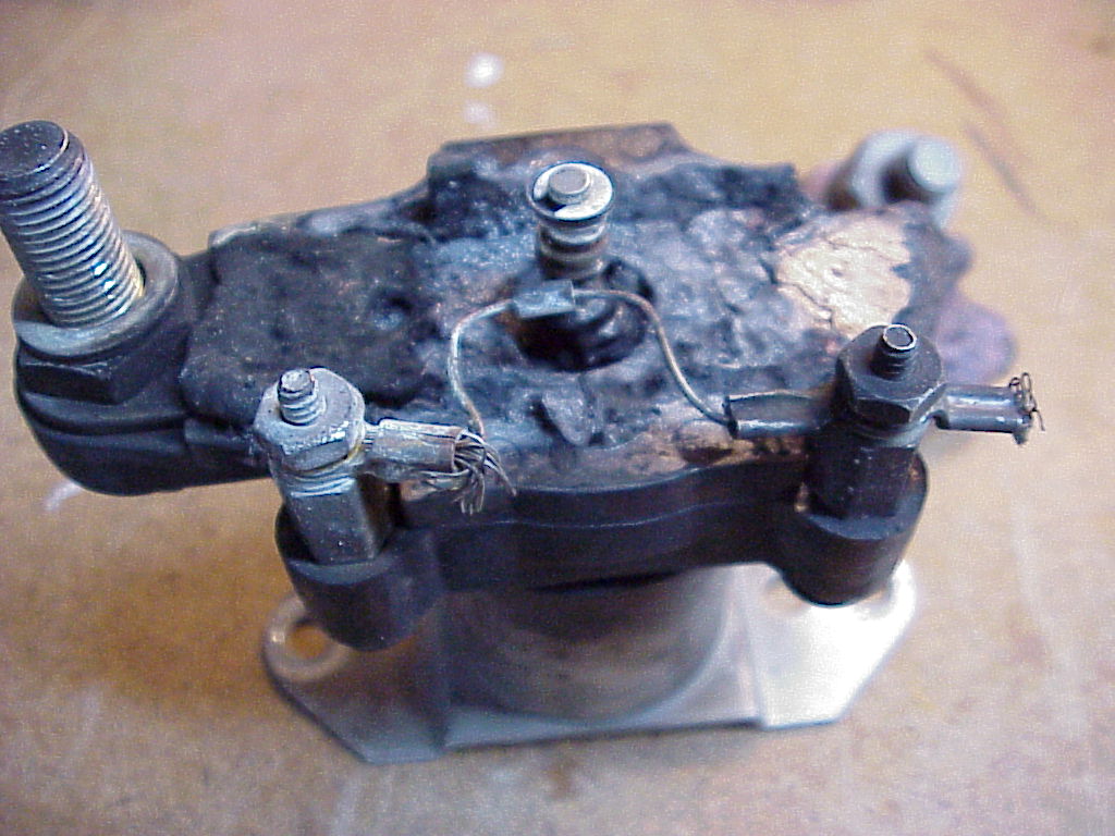

The Kilovac and 6041H contactors are truly fine devices
and there are cases where their application makes good
sense . . . but they to0 have their vulnerabilities
and limitations. See:
http://www.aeroelectric.com/Pictures/Failures/6041_Contactor_Failure.jpg
http://www.aeroelectric.com/Pictures/Failures/Kilovolt_Contactor_Lightning_Damage.jpg
