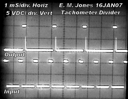

| Subject: | Tachometer Adapter |
For one of my loyal and wise customers, I designed a built a device to adapt a
three-pulse-per-rev output to a 1.5 pulse per rev RPM display. I am totally ignorant
of what demand there is for such a device. If you are interested I will
either make these or sell kits or release the design in the common good.
O'scope shot attached.
