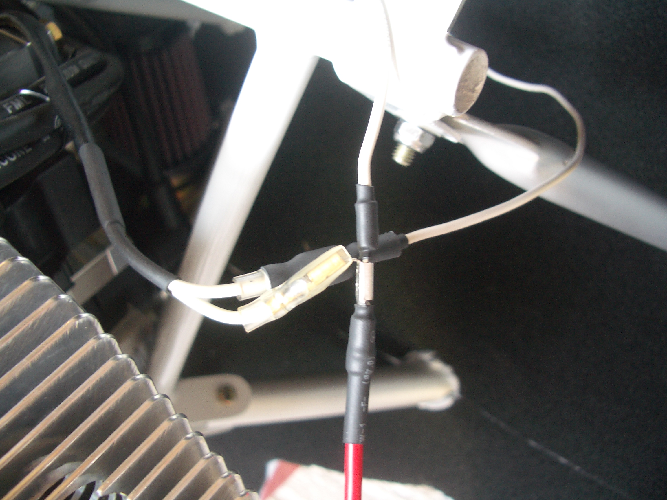

Hi all,
I've just fabricated the link from one of my Jab dynamo leads, connecting this
to pin 1 of the regulater and to a 3A in-line fuse, which will eventually go the
tach of my EIS. I've posted a picture of how I've linked the 3 wires together
and wanted your opinion on whether it's safe or is there a better way to do
this? In the picture the white wires on the left are from the dynamo, the white(?)
on the right go to the voltage regulater and the red wire at the bottom
is the 3A in-line fuse. Am I ok with the piggy-back connector that I've used?
Thanks for your time.
Ian
