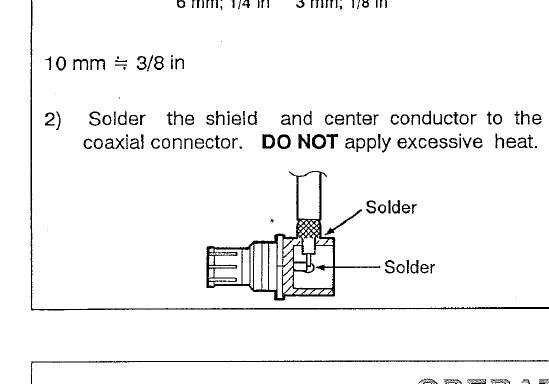

| Subject: | Re: LOOKING FOR RIGHT ANGLE BNC CONNECTOR |
My 10 cents is that the 9-30-10 is not an adaptor. The item in the A200 installation
picture attached is a 9-30-10 from lanepilot.com. $25.00 with shipping.
(or $52 from ICOM)
This part was a supplied item with the A200. They stopped when they came out with
the A210.
Now a question.
I have soldered the connection in two places as shown.
When I solder the antenna connector on the other end. Should I also solder the
braid to the connector body or should I separate the braid and ground it to the
airframe or should I trim it back and not solder it anywhere. (I soldered braid
to connector body)
Reason I'm asking is that all I'm getting from the speaker is a hissing sound.
To keep it simple I started by hooking up the speaker only. nothing else. I suspect
my coaxial wire (RG58 A/U) because when I pull the coax out of the A200
the noise is unchanged..Geoff
http://forums.matronics.com/viewtopic.php?p=277493#277493

Geoff -
The insulating and jacketing materials used in RG-58 are vulnerable to
the temps encountered in soldering operations. RG-400 is much better
suited to this application.
When using coax to feed an antenna, the shield must be electrically
connected at both ends. On antennas that employ a BNC-type connector,
the connector shells provide the circuit path from the radio case ground
to the aircraft skin, which serves as the antenna ground plane. Whether
the braid is soldered or clamped to the shell with some sort of threaded
or crimped fastener is determined by the particular connector design.
It is quite possible that the heat of soldering was sufficient to melt
the foam insulation separating the center conductor and the braided
shield. If the two get together, things don't work so good, and
transmitting could damage the radio's RF output circuit.
Finally, if you haven't checked/adjusted the radio's squelch setting, it
may be set low enough that the hiss you're hearing is normal white
noise. Tighten the squelch and see if the hiss goes away.
Neal
N8ZG

Now a question.
solder the braid to the connector body or should I separate the braid
and ground it to the airframe or should I trim it back and not solder it
anywhere. (I soldered braid to connector body)
sound. To keep it simple I started by hooking up the speaker only.
nothing else. I suspect my coaxial wire (RG58 A/U) because when I pull
the coax out of the A200 the noise is
unchanged=C3=A2=82=AC=C2=C3=A2=82=AC=C2..Geoff
Correct. It's a specialized connector.
>Now a question.
Why are you using a soldered connector on this end?
Crimped is MUCH easier to install for reliable connector.
http://www.aeroelectric.com/Pictures/Connectors/Coax/BNC_Cable_Male.jpg
> Should I also solder the braid to the
> it back and not solder it anywhere. (I soldered braid to connector body)
???? I'm not aware of any connector design (other than
the arcane UHF series) that calls for soldering to the
braid. If you use a connector designed for crimping
as above, then the braid attaches under the sleeve.
The only BNC connector I've ever soldered was this
style:
http://www.aeroelectric.com/Pictures/Connectors/Coax/BNC_Solder_Cable_Male.jpg
and soldering was to the center conductor only. The
shield gets captured under the shield clamp. Installation
instructions . . .
http://www.aeroelectric.com/Pictures/Connectors/Coax/BNC_Install_1.jpg
> getting from the speaker is a hissing sound. To
> speaker only. nothing else. I suspect my
> coax out of the A200 the noise is unchanged..Geoff
I would not necessarily expect the no-signal noise
levels to change by simple adding or deleting an antenna
connection. You need to check first with a hand-held as
an external signal source. Then check on your local
ground services, approach control or ATC radar sector
frequency for traffic with other aircraft.
