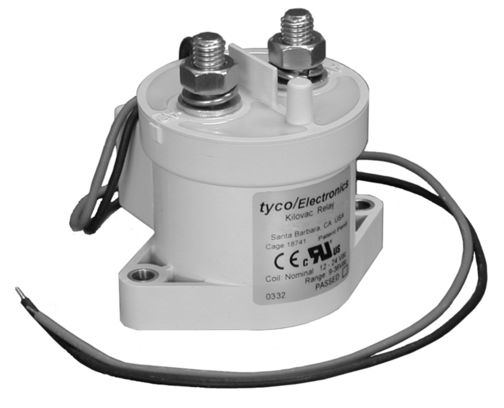

I would like to follow up with the idea that
on a TC aircraft, there are NO plain nuts or
combinations of plain nuts and lockwashers used.
Non-locking, threaded fasteners are often supplied
on accessories from the outside world . . .
http://www.aeroelectric.com/Pictures/Contactors/Kilovac_EV200_contactor.jpg
http://www.aeroelectric.com/Pictures/Contactors/s701-2.jpg
http://aeroelectric.com/Pictures/Switches/Toggle_Switch_with_Mold-Captured_T
http://aeroelectric.com/Pictures/Switches/Flap_Switch.jpg
Every time the system integrator picks up such
devices, there's supposed to be an evaluation of
risk due to "loose hardware". If the risks are
deemed great enough, non-locking fasteners will
be replaced with locking devices -or- doped with
Loc-tite on final assembly.
The tree-visible-threads rule has much more to do
with strength of the assembled fastener (indicates
that the screw is long enough) than with anti-
loosening. The same rule applies to all threaded
fasteners including the locking style nuts and
nutplates.
Where locking threads are not possible or practical,
consider still longer screws with a jamb-nut installed
on top of the structural nut. Further, a thread locker
that can be easily disassembled can go a long way
toward insuring joint integrity. Super-glue works
nice. It's thin and wicks into an already assembled
set of threads.
jpg
ed_T
nutplates.
set of threads.

Message 13
| Subject: | Re: Downed EAA Plane |
I'm no engineer, & don't even plan to stay in *any* motel at S&F, but it
will take more than a web site to convince me those instructions are
correct. If I'm following their instructions correctly, the preload on
the bolt will only be 25-50% of design (could easily wind up being even
less) & the only spot with 100% of the preload will be the threads
between the nuts.
The deal on that bridge will need to be a lot better to get my
attention. :-)
Charlie
On 3/30/2010 7:01 AM, Jay Hyde wrote:
> --> AeroElectric-List message posted by: "Jay Hyde"<jay@horriblehyde.com>
> An interesting thing about jamb-nuts; if we are thinking of the same thing
> here. We call them 'half-nuts'; usually people place the full sized nut
> under the half or jamb nut- I used to as well. However, the correct way is
> to put the thin nut first - see
> http://www.boltscience.com/pages/twonuts.htm
> Jay
> -----Original Message-----
> From: owner-aeroelectric-list-server@matronics.com
> [mailto:owner-aeroelectric-list-server@matronics.com] On Behalf Of Robert L.
> Nuckolls, III
> Sent: 13 March 2010 11:02 PM
> To: aeroelectric-list@matronics.com
> Subject: Re: AeroElectric-List: Downed EAA Plane
> --> AeroElectric-List message posted by: "Robert L. Nuckolls, III"
> <nuckolls.bob@aeroelectric.com>
> Jon followed up later with:
> Hi all,
> I have confirmed the cause of my power failure last weekend. Long story
> short - it was builder error. When you install a locknut on a bolt, you
> MUST ensure that there is at least a thread or two coming all the way
> thru the nut. If not, it will eventually vibrate free.
> <snip>
> I have changed my mounting method and now have nutplates inside this "box".
> Please; learn from other's mistakes cause you don't have enough time to
> make them all yourself!!
> nutplates.
> set of threads.
> Bob . . .
Message 14
At 03:16 PM 3/30/2010, you wrote:
<ceengland@bellsouth.net>
it will take more than a web site to convince me those instructions
are correct. If I'm following their instructions correctly, the
preload on the bolt will only be 25-50% of design (could easily wind
up being even less) & the only spot with 100% of the preload will be
the threads between the nuts.
I read the article with interest and a sense
of mystery. Slicing and dicing distribution of
total loads between two nuts, one of which
ISN'T INTENDED TO BE STRUCTURAL gives one pause
to ponder.
Consider the host of anti-loosening technologies
including toothed lock washers, winged lock washers
keyed to a shaft and bent up to capture flats of the
installed nut, distorted diameters designed to
multiply friction between nut and bolt, locking
goos and gunks, plastic or fiber inserts on the
nuts or even the bolts, cotter keys through drilled
or castellated nuts, and finally the lowly hunk
of safety wire.
The laws of physics including a study of basic machines,
coefficients of friction and sliding forces tending
to move down an inclined plane will show that no
threaded fastener torqued to design values will rotate
on its mate unless for some reason tension on the
bolt is relaxed or strong but transient forces
vibrations) tend to overcome the breaking coefficient
of friction in the threads is overcome.
None of the cited prophylactics against inadvertent
loosening of a threaded couple take any part
whatsoever in the structural task assigned to
the threaded fasteners. Hence I find it curious
that one takes the time to put up such an explanation
about some seemingly critical function of jam nuts
on the structural integrity of the joint.
I've never seen a jamb nut installed anywhere
but on top of the nut it is intended to restrain.
Further, I'll bet that installation torque values
