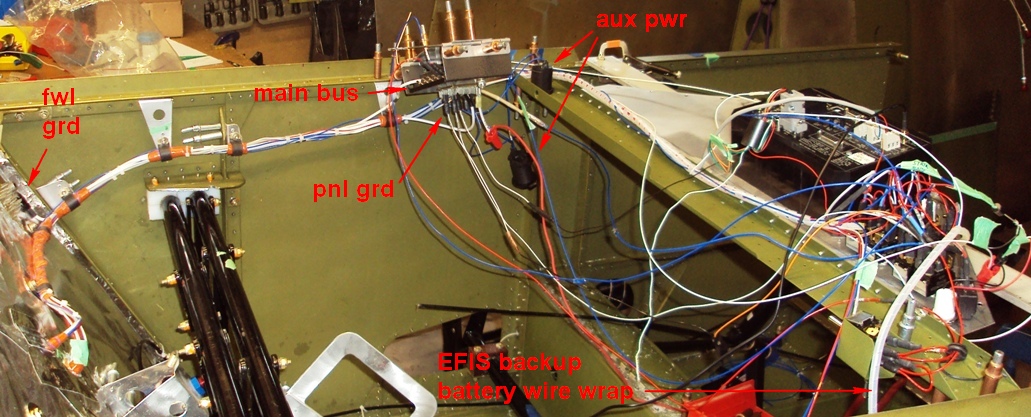

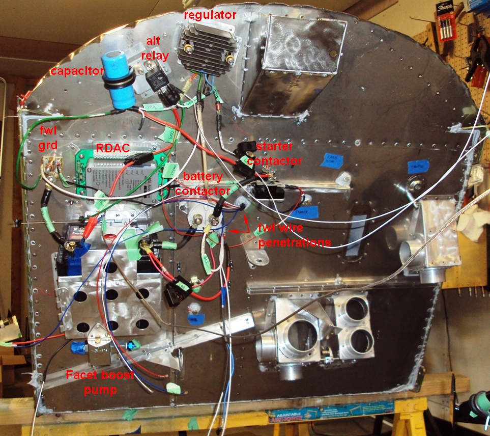

At 11:20 PM 7/16/2010, you wrote:
>Hi!
>I'm finishing up my electrical wiring and am wondering about noise.
>I'm not sure what types there are, nor do I know all the sources. I
>have heard the alternator and the transmitting radio can cause
>problems. Also heard that anything with a pulsing signal could also
>be a source.
<snip>
>How does this look to you? Thanks again for taking your time helping me :-)

A single point ground for all the instrument
panel mounted goodies and paying attention
to the manufacturer's installation instructions
goes a long way to crafting a noise free future.
