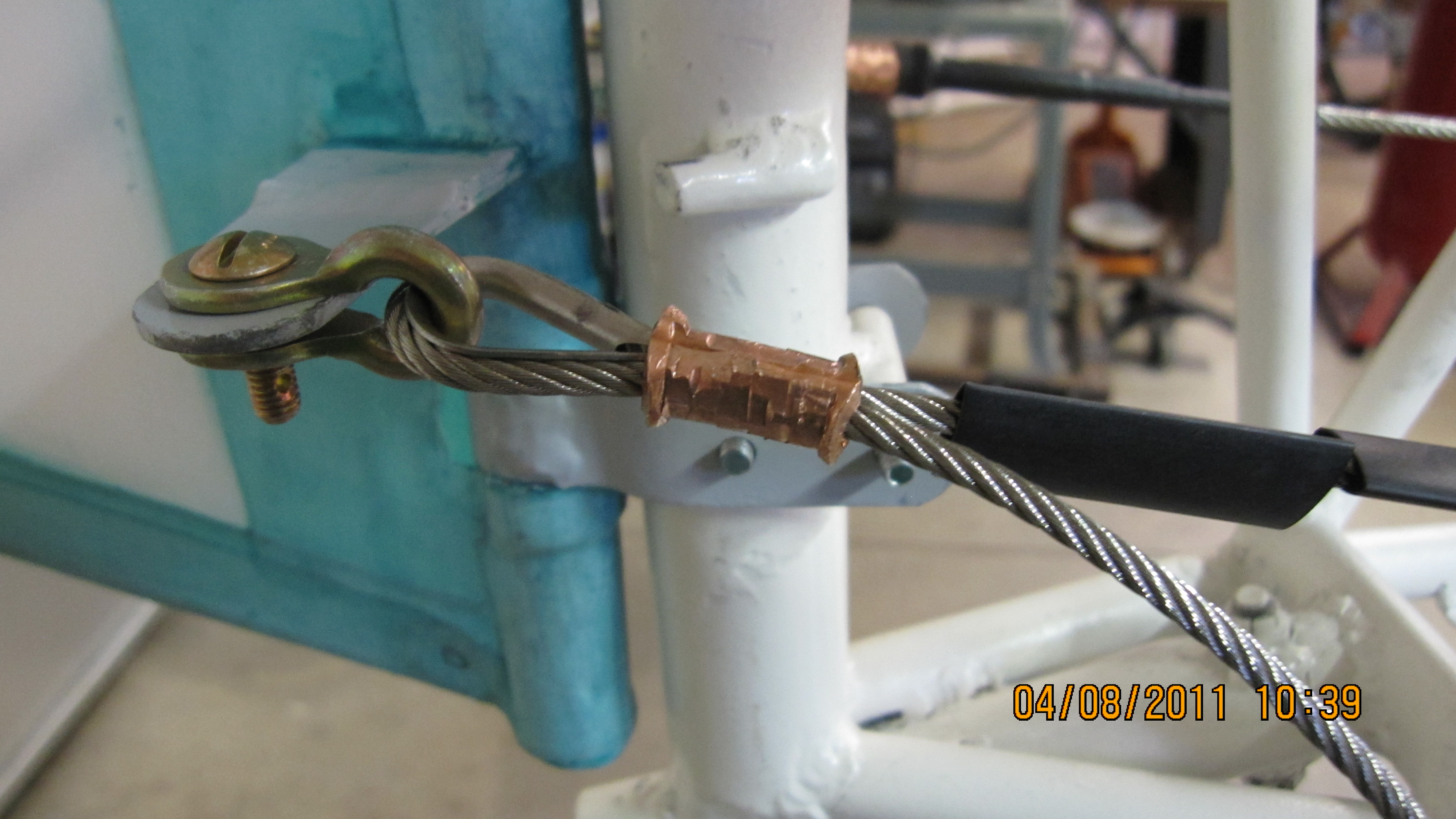

Richard,
Thank you so much for your thoughtful opinion and generous offer to redo my work.
I can see you are worried and can relieve your concerns. First, the crimps
pass the go-no go gage. Second, the picture should show you the work is solid.
Thanks again for your concern.
http://forums.matronics.com/viewtopic.php?p=341186#341186
http://forums.matronics.com//files/rudder_cable2_112.jpg
