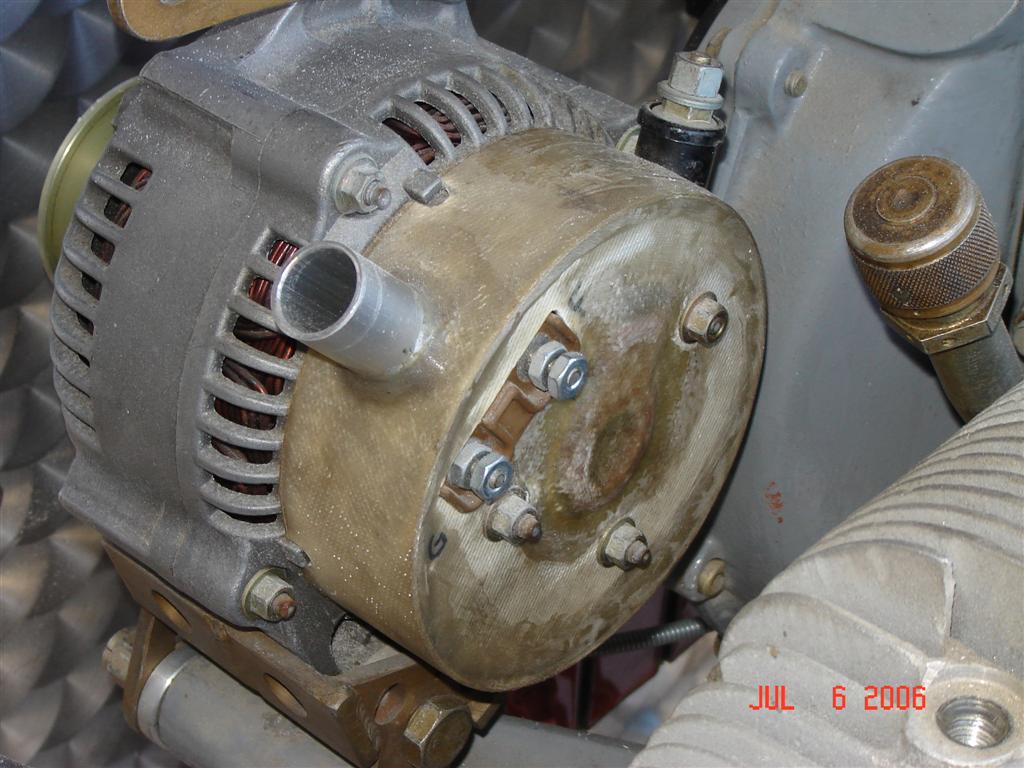

Jurgen,
I've attached a photo of a possible solution. I had the same concerns as you because
I have a plenum capturing all the cooling ram air and directing it through
the cylinders. My engine installation is battery/electrical system dependent
(fuel pumps, EFI & ignition) so I wanted a little insurance for my reversed-fan
alternator.
I fabricated the alternator diode plate plenum in the picture from fiberglass and
vinyl-ester resin. The resin will withstand 220 deg before going plastic. Epoxy
resin systems will also work. Just check to see that the transition temp
meets your needs.
You can use the stamped cooling shroud as a mold for your part.
Connect to ram air source with SCAT tube size of your choice. I used 3/4".
Good luck,
John
http://forums.matronics.com/viewtopic.php?p=381152#381152
http://forums.matronics.com//files/franklin_alternator_001_large_129.jpg
