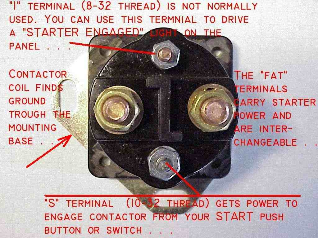

As far as monitoring the starter contactor rather than the terminals on the starter,
I have to say I followed an old drawing I had from the aeroelectric.com
site. It was
http://www.aeroelectric.com/Pictures/Contactors/Starter_Contactor/s702wire.jpg
When I search for it now, I find I am not able to access it. It was a picture of
an auto style start contactor with two large posts and two small posts. The
small posts were labelled S and I. The picture said the I post could be used
for a starter monitoring light. I'll agree the starter would be a better device
to monitor. THanks for the tips.
> terminals on the starter, I have to say I followed an old drawing I
> had from the aeroelectric.com site. It was
it's still there. it got filed under "Starter Contactors"
http://tinyurl.com/o5turon
>a picture of an auto style start contactor with two large posts and
>two small posts. The small posts were labelled S and I. The picture
>said the I post could be used for a starter monitoring light. I'll
>agree the starter would be a better device to monitor. THanks for the tips.
The wiring suggested in S702wire.jpg might make more
sense if you saw the schematic . . .
Actually, the "I" terminal is just fine . . . that's a THIRD
stationary contact within the S702-1 contactor that duplicates
the connections between the two FAT terminals thusly . . .
