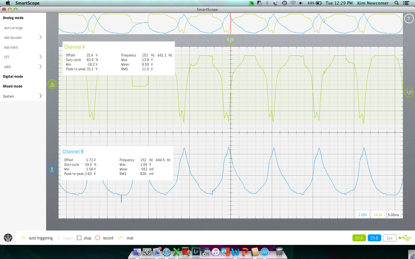

A brief problem description: I changed from a fried Key West voltage regulator
on the front of my firewall to a Rotax VR on the back of my firewall. (Kitfox
w/ 912ULS.) Now the music input to my intercom (SLA-400 TSO) is muted because
of noise coming into the intercom via the IC-200 radio. So far I've shielded the
input all the way to the VR, tried a noise filter right in front of the DC
bus, and a faraday cage over the VR. I've improved the problem to the point that
I can hear the music up to about 3000 rpm, then it mutes. So I bought an oscilloscope
and took some measurements today. I'm seeing a weird 20Hz 360mv spike
downstream of the VR, and the VR input (generator output) looks terrible. (I
thought it was a kind of square wave.) I can't seem to find what the 912 generator
output is supposed to look like online. Any ideas? Any ideas what the downstream
voltage spikes are?
