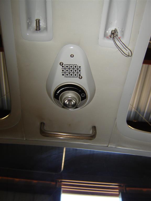

I used an AVEO EyeBeam-mini in my Glasair. A bit pricy, but the design is beautiful
and functional. The eyeball lets you put light wherever you need it and it
has capacitive integral switch/dimmer/red light.
I had/have an interference problem with my specific installation that AVEO engineers
had never encountered. When I key my mike, the light starts flashing and
the capacitive on/off switch becomes in op until power is physically disconnected.
After unsuccessful attempts to fix it with ferrite toroids, I installed
a small on/off/dimmer switch on the housing and in the power feed to fix it.
