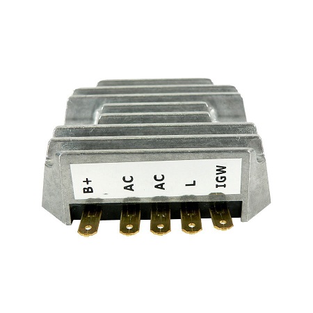

Can you post a picture of your John Deere regulator?
If it looks like this one, B+ terminal goes to a 30 amp fuse that is connected
to the downstream side of battery contactor.
The AC terminals connect to Rotax permanent magnet generator (yellow wires)
L is for a lamp. Usually not used.
IGW connects to a switch (labeled "Alternator") which gets 12 volts from a 3 amp
fuse on the main power bus.
Be sure to mount regulator using heat conductive grease between aluminum surfaces.
