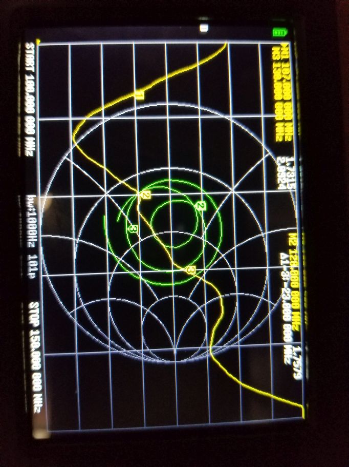

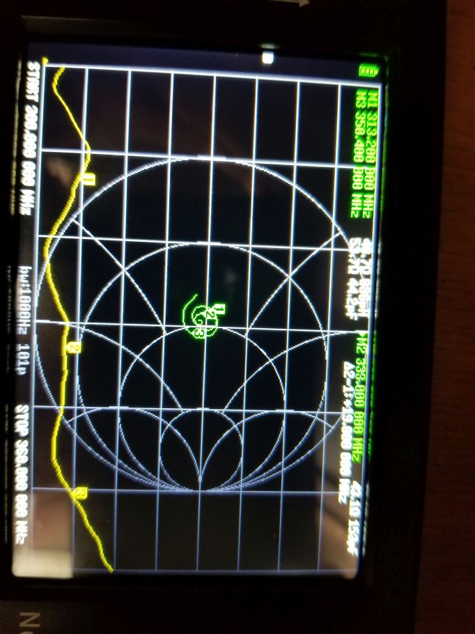

Bob,
Just took a couple photos of my antenna. I did two calibrations, one for Glide
slope and one for Localizer.
Not sure how the photos will come out. These are attached.
I don't remember the length I initially used for antenna. I bench tested and it
looked OK. After install the freqs changed, most likely due to frame proximity.
There are some wire and and ferrites between the connector and the foil. This
will take up some length. I had to cut the foil to get in the freq range.
Merle

Message 5
| Subject: | Re: DIY LOC/VOR_G.S. Antenna |
At 12:04 PM 7/18/2020, you wrote:
><wagnermerle@gmail.com>
>Bob,
>for Glide slope and one for Localizer.
>tested and it looked OK. After install the freqs changed, most
>likely due to frame proximity. There are some wire and and ferrites
>between the connector and the foil. This will take up some length. I
Interesting. I'm wondering if the 'short' elements
are not really functioning as resonant radiators, rather
reactive elements that influence the uhf characteristics
of the overall assembly.
We know that the basic 1/2-wave dipole offers
significantly effective performance at odd
harmonics of the fundamental. If memory serves,
LOC/VOR transmitters operate in the 108 to 118 Mhz
range. 3x these numbers are 324 to 354 . . . more
than the 328 to 336 bandwidth occupied by the
contemporary GS transmitters.
This means that your barefoot LOC/VOR antenna
is quite capable of providing GS signals to
your ILS receiver. For many years, GS
receivers have been installed using band-pass
couplers on the LOC/VOR thus allowing one
STOCK, LOC/VOR antenna to service both VORNAV
and ILS systems.
The attached photo is one of what must be
dozens of examples for this kind of device.
I'm thinking that if you removed the little
'stubs' from the array, your swr plots over
the two band widths of interest would not
be significantly different . . . indeed
both acceptable for the task at hand.
Given the VHF antenna's propensity for acceptable
performance at third harmonic, it is almost a
certainty that the observably 'too small' size
of these stubs is of no benefit to the antenna's
performance.
