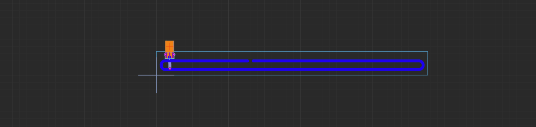

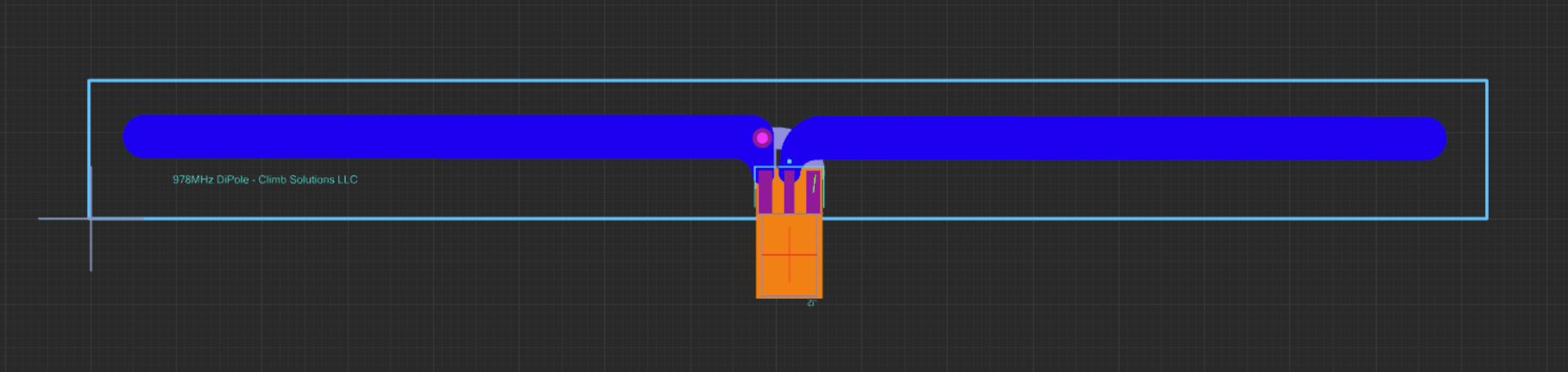

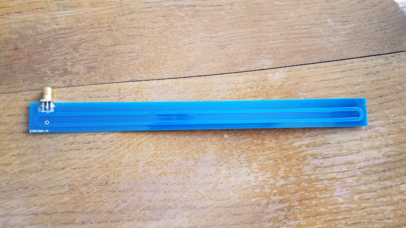

      So, all this chatter about the ELT antennas got me thinking about the ADS-B antenna
      I made. I dove into the math, made some estimates, and designed two on Upverter
      and had parts made. I got luck in that my SlimJim ADS-B antenna has picked
      up airborne traffic over 100 miles away connected to a Stratux (I have both
      SDR radios tied into a single antenna - criminal - I know, but it works and
      it's small and light.)
      Attached are the layouts of the two antennas and links to the actual designs on
      Upverter.
       I had 5 of each made. Anyone interested in testing and sharing data - maybe make
      this a shared design as well. Cost is just a few bucks.
      Slim Jim: https://upverter.com/eda/#tool=pcb,designId=1d1c59be761e9901
      DiPole: https://upverter.com/eda/#tool=pcb,designId=9eb3fbd043861e96
      (Upverter is a pretty awesome cloud based schematic and layout tool that allows
      collaboration on designs, etc... Think Google Docs for circuit design.)
