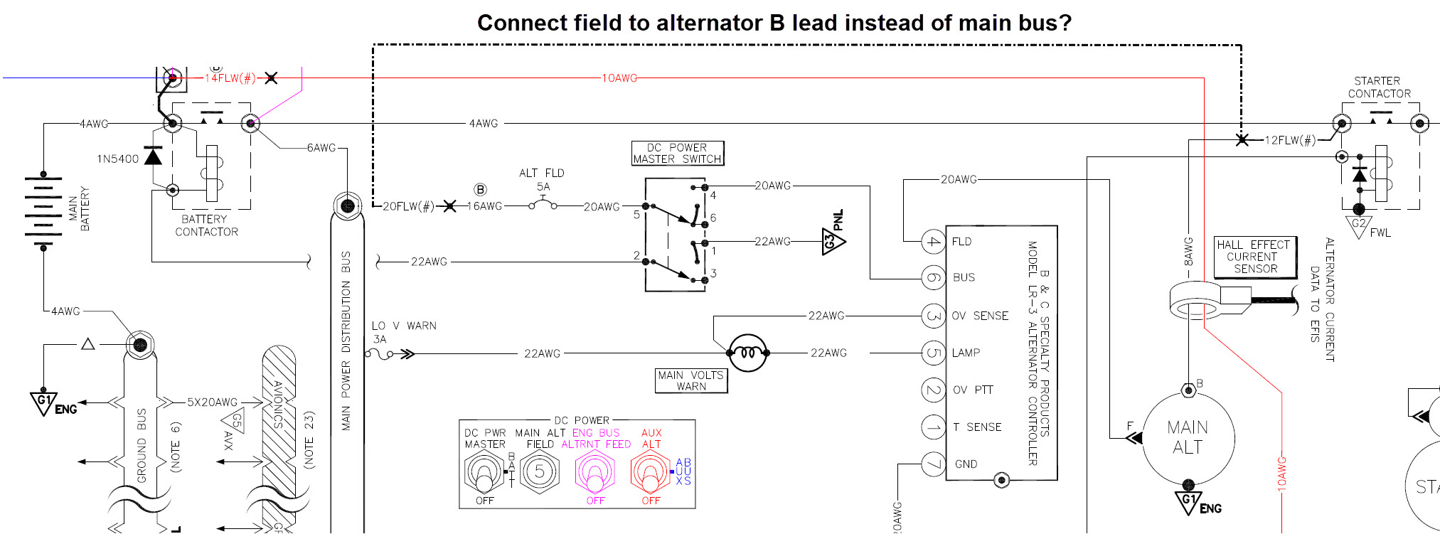

Hi Bob,
Someone in my sphere suggested getting field current from the B lead instead of
from the main bus.
This way if the B lead shorts to ground and the fuselink opens, the field will
be de-energized.
Marked up snip of Z101B attached.
Comments?
John Bright, RV-6A, at FWF, O-360
Z-101 single batt dual alt SDS EM-5-F.
john_s_bright@yahoo.com, Newport News, Va
https://drive.google.com/drive/folders/1u6GeZo6pmBWsKykLNVQMvu4o1VEVyP4K
