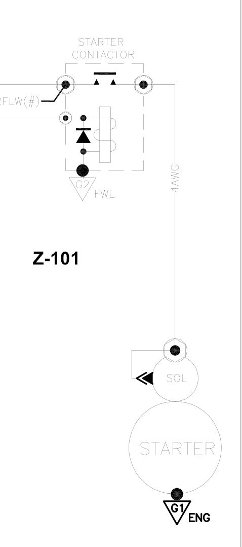

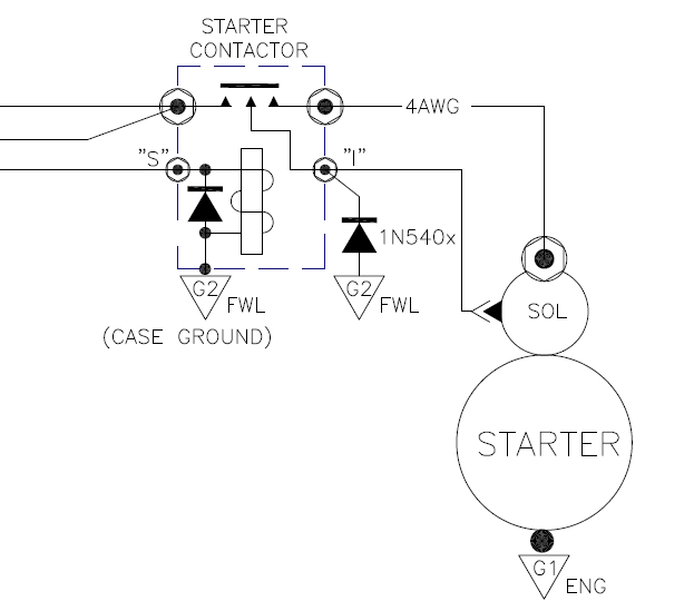

    Good afternoon, I'm working on a schematic for my RV-10 based on the Z-101 architecture and have come up with a couple questions about contactors... First, about the starter contactor. The Z-101 shows a single conductor connecting the contactor to the starter with a jumper at the starter. I found another discussion from 2015 with an alternative arrangement (attached) for permanent magnet starters. I'm planning to use a B&C starter. Should I be using the extra wire & diode? Second, I'm adding an external power outlet per Z-31A. I've made sense of most of this drawing but I'm unsure why there is no diode shown across the coil in the Z-31A diagram? The B&C continuous contactor includes an external diode already. Should it be removed? Thanks for taking the time to read my perhaps basic questions! Read this topic online here: http://forums.matronics.com/viewtopic.php?p=501905#501905 Attachments: http://forums.matronics.com//files/facdd36_721_432.jpg http://forums.matronics.com//files/z101_697.png

    Z-31A does not require a diode because the over-voltage module provides arc suppression. No, do not remove the B&C installed diode. It does not hurt anything. -------- Joe Gores Read this topic online here: http://forums.matronics.com/viewtopic.php?p=501909#501909

    At 02:10 PM 5/13/2021, you wrote: ><andrew.lumley@sympatico.ca> > >Good afternoon, > >I'm working on a schematic for my RV-10 based on the Z-101 >architecture and have come up with a couple questions about contactors... > >First, about the starter contactor. The Z-101 shows a single >conductor connecting the contactor to the starter with a jumper at >the starter. I found another discussion from 2015 with an >alternative arrangement (attached) for permanent magnet starters. >I'm planning to use a B&C starter. Should I be using the extra wire & diode? By 'extra wire' are you talking about the jumper from contactor "I" terminal to the starter's "S" terminal? Yes, wire as shown and including the diode is a good thing. The starter contactor from B*C will include a built in diode on its coil. >Second, I'm adding an external power outlet per Z-31A. I've made >sense of most of this drawing but I'm unsure why there is no diode >shown across the coil in the Z-31A diagram? The B&C continuous >contactor includes an external diode already. Should it be removed? Wouldn't hurt but not necessary assuming you can get a B*C crowbar ov module. Are those available? I though those were out of production. >Thanks for taking the time to read my perhaps basic questions! That's what this organization is here for my friend . . . folks that already know everything don't need us! Bob . . . Un impeachable logic: George Carlin asked, "If black boxes survive crashes, why don't they make the whole airplane out of that stuff?"

    Thanks to you both for the quick feedback. I'll include the jumper from the contactor "I" terminal to the starter with the extra diode. You are correct that B&C no longer sells the crowbar module so I was going to build my own from your crowbar schematics. Thanks again, I'm sure I'll have lots more questions... Read this topic online here: http://forums.matronics.com/viewtopic.php?p=501914#501914
