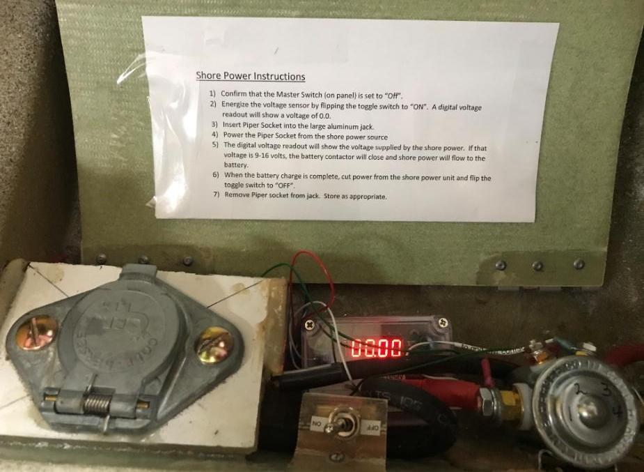

    Bob's write up made this a fun little project, now easily accessed while hidden away under a rear seat. -------- PBK3 PA-12, BD-4, RV6a, gliders Read this topic online here: http://forums.matronics.com/viewtopic.php?p=502101#502101 Attachments: http://forums.matronics.com//files/shore_power_926.png
