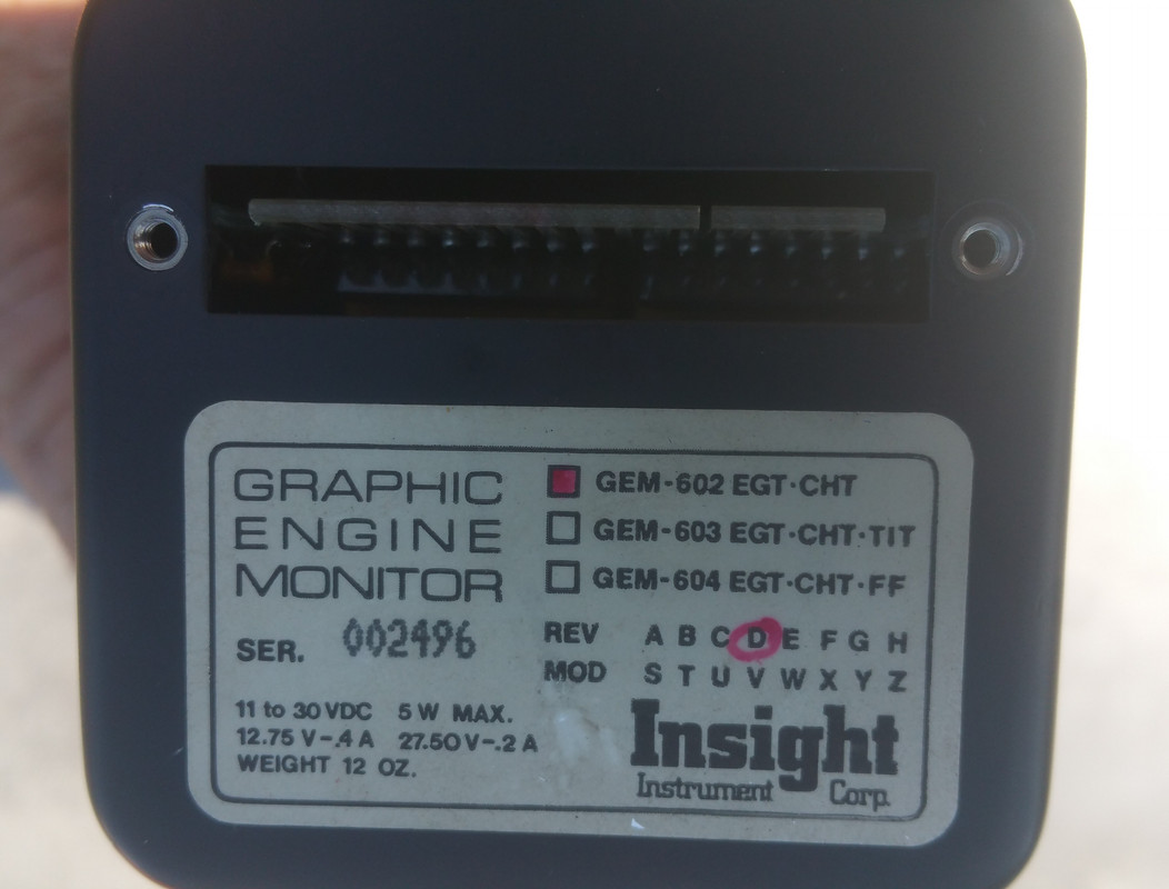

---------------------------------------------------------- AeroElectric-List Digest Archive --- Total Messages Posted Sat 05/28/22: 7 ---------------------------------------------------------- Today's Message Index: ---------------------- 1. 09:53 AM - Molex connector needed for my Insight GEM 602 (Charles Kuss) 2. 01:08 PM - Re: Molex connector needed for my Insight GEM 602 (Robert L. Nuckolls, III) 3. 01:14 PM - Re: Re: Power-Sonic LiFePO4 (Hypersport) (Robert L. Nuckolls, III) 4. 01:43 PM - Re: Molex connector needed for my Insight GEM 602 (Charlie England) 5. 06:11 PM - Re: Molex connector needed for my Insight GEM 602 (Charles Kuss) 6. 06:21 PM - Re: Molex connector needed for my Insight GEM 602 (Charles Kuss) 7. 06:37 PM - Re: Molex connector needed for my Insight GEM 602 (Charles Kuss) ________________________________ Message 1 _____________________________________ Time: 09:53:26 AM PST US From: Charles Kuss Subject: AeroElectric-List: Molex connector needed for my Insight GEM 602 I need to buy the Molex connector for my Insight GEM 602. It is a 15/30 pin edge connector with a 0.100" pitch between contacts. It also has a notch in the card to prevent the connector being installed backwards. Any idea what the part number I need is and where I could buy it? There is no info regarding this in the documentation I received with the unit. It also appears that this series [4338 ??] of connector has been deemed obsolete by Molex. Charlie Kuss PS I tried to attach a photo of the rear of the unit, but this forum does not allow jpg attachments. ________________________________ Message 2 _____________________________________ Time: 01:08:42 PM PST US From: "Robert L. Nuckolls, III" Subject: Re: AeroElectric-List: Molex connector needed for my Insight GEM 602 At 11:15 AM 5/28/2022, you wrote: > >I need to buy the Molex connector for my Insight GEM 602. It is a >15/30 pin edge connector with a 0.100" pitch between contacts. It >also has a notch in the card to prevent the connector being >installed backwards. Any idea what the part number I need is and >where I could buy it? There is no info regarding this in the >documentation I received with the unit. It also appears that this >series [4338 ??] of connector has been deemed obsolete by Molex. Check out the Molex data page on my website: https://tinyurl.com/7t6jjsc Data there includes descriptions and photos of the 4338 series connectors and pins. Yeah, been out of production for a long time. Over the years I've had some luck finding connectors at surplus electronics shops but those opportunities are growing really skinny too. I do have a few pieces of work-around left over from the last few times I had your problem. You'll see some pictures on the website where a builder cut two larger connectors and spliced them together with JB Weld to achieve the proper pin-count. Sorry, not gold plated. Not crimped either . . . ran out of those pins about 15 years ago. However, I've used this technique at least twice to get one of these vintage radios up and running. You're welcome to a 1-1/2 12-pin connectors (pictured) to take a whack at this fix. Keeping half of a connector on hand will allow me to offer this fix at least one more time. Bob . . . Un impeachable logic: George Carlin asked, "If black boxes survive crashes, why don't they make the whole airplane out of that stuff?" ________________________________ Message 3 _____________________________________ Time: 01:14:40 PM PST US From: "Robert L. Nuckolls, III" Subject: Re: AeroElectric-List: Re: Power-Sonic LiFePO4 (Hypersport) > >That doesn't necessarily make them all appropriate for aviation use. >Just food for thought. Just be wary of the term 'SVLA equivalent' . . . I went toe-to-toe with major players in the lithium market a couple decades ago. When the battery is your sole energy source for comfortable termination of flight there is no SLVA equivalent. Capacity is capacity is capacity . . . That capacity should be defined by design goals and periodically TESTED to insure that such goals are maintained. Bob . . . Un impeachable logic: George Carlin asked, "If black boxes survive crashes, why don't they make the whole airplane out of that stuff?" ________________________________ Message 4 _____________________________________ Time: 01:43:13 PM PST US Subject: Re: AeroElectric-List: Molex connector needed for my Insight GEM 602 From: Charlie England On 5/28/2022 3:07 PM, Robert L. Nuckolls, III wrote: > At 11:15 AM 5/28/2022, you wrote: >> >> >> I need to buy the Molex connector for my Insight GEM 602. It is a >> 15/30 pin edge connector with a 0.100" pitch between contacts. It >> also has a notch in the card to prevent the connector being installed >> backwards. Any idea what the part number I need is and where I could >> buy it? There is no info regarding this in the documentation I >> received with the unit. It also appears that this series [4338 ??] of >> connector has been deemed obsolete by Molex. > > Check out the Molex data page on my website: > > https://tinyurl.com/7t6jjsc > > Data there includes descriptions and photos > of the 4338 series connectors and pins. Yeah, > been out of production for a long time. > > Over the years I've had some luck finding > connectors at surplus electronics shops > but those opportunities are growing really > skinny too. > > I do have a few pieces of work-around left > over from the last few times I had your > problem. You'll see some pictures on the website > where a builder cut two larger connectors and > spliced them together with JB Weld to achieve > the proper pin-count. > > Sorry, not gold plated. Not crimped either . . . ran > out of those pins about 15 years ago. However, > I've used this technique at least twice to get > one of these vintage radios up and running. You're > welcome to a 1-1/2 12-pin connectors (pictured) > to take a whack at this fix. Keeping half of > a connector on hand will allow me to offer this > fix at least one more time. > > Bob . . . > Ebay is always worth a look. Molex edge connector My permanent solution, for experimental applications, is a soldering iron, some milspec wire, and a subD connector. ;-) Charlie -- This email has been checked for viruses by Avast antivirus software. https://www.avast.com/antivirus ________________________________ Message 5 _____________________________________ Time: 06:11:09 PM PST US From: Charles Kuss Subject: Re: AeroElectric-List: Molex connector needed for my Insight GEM 602 Bob, Thanks for the ideas and the web link. Friday morning I was searching and came across these. Correct number of terminals, but no indication as to pit ch. I need 0.100" [aka 2.54mm] Any comments regarding what I've found? https://twistywristarcade.com/edge-connectors/772-15-30-pin-edge-connector- sec.html https://www.mikesarcade.com/cgi-bin/store.pl?sku=CECM30 I found a few more, but they were all .156" pitch. Charlie Kuss On Saturday, May 28, 2022, 07:53:13 PM EDT, Robert L. Nuckolls, III wrote: At 11:15 AM 5/28/2022, you wrote: --> AeroElectric-List messageposted by: Charles Kuss I need to buy the Molex connector for my Insight GEM 602. It is a 15/30pin edge connector with a 0.100" pitch between contacts. It also hasa notch in the card to prevent the connector being installed backwards.Any idea what t he part number I need is and where I could buy it? Thereis no info regardin g this in the documentation I received with the unit.It also appears that t his series [4338 ??] of connector has been deemedobsolete by Molex. =C2- Check out the Molex data page on my website: https://tinyurl.com/7t6jjsc =C2- Data there includes descriptions and photos =C2- of the 4338 series connectors and pins. Yeah, =C2- been out of production for a long time. =C2- Over the years I've had some luck finding =C2- connectors at surplus electronics shops =C2- but those opportunities are growing really =C2- skinny too. =C2- I do have a few pieces of work-around left =C2- over from the last few times I had your =C2- problem. You'll see some pictures on the website =C2- where a builder cut two larger connectors and =C2- spliced them together with JB Weld to achieve =C2- the proper pin-count. =C2- Sorry, not gold plated. Not crimped either . . . ran =C2- out of those pins about 15 years ago. However, =C2- I've used this technique at least twice to get =C2- one of these vintage radios up and running. You're =C2- welcome to a 1-1/2 12-pin connectors (pictured) =C2- to take a whack at this fix. Keeping half of =C2- a connector on hand will allow me to offer this =C2- fix at least one more time. =C2- Bob . . . =C2- Un impeachable logic: George Carlin asked, "If blackboxes =C2- survive crashes, why don't they make the whole airplane =C2- out of that stuff?" ________________________________ Message 6 _____________________________________ Time: 06:21:59 PM PST US From: Charles Kuss Subject: Re: AeroElectric-List: Molex connector needed for my Insight GEM 602 Here is a link to what the rear of the GEM 602 looks like Insight-GEM-602-rear-view-20220527-154618 Charlie On Saturday, May 28, 2022, 07:53:13 PM EDT, Robert L. Nuckolls, III wrote: At 11:15 AM 5/28/2022, you wrote: --> AeroElectric-List messageposted by: Charles Kuss I need to buy the Molex connector for my Insight GEM 602. It is a 15/30pin edge connector with a 0.100" pitch between contacts. It also hasa notch in the card to prevent the connector being installed backwards.Any idea what t he part number I need is and where I could buy it? Thereis no info regardin g this in the documentation I received with the unit.It also appears that t his series [4338 ??] of connector has been deemedobsolete by Molex. =C2- Check out the Molex data page on my website: https://tinyurl.com/7t6jjsc =C2- Data there includes descriptions and photos =C2- of the 4338 series connectors and pins. Yeah, =C2- been out of production for a long time. =C2- Over the years I've had some luck finding =C2- connectors at surplus electronics shops =C2- but those opportunities are growing really =C2- skinny too. =C2- I do have a few pieces of work-around left =C2- over from the last few times I had your =C2- problem. You'll see some pictures on the website =C2- where a builder cut two larger connectors and =C2- spliced them together with JB Weld to achieve =C2- the proper pin-count. =C2- Sorry, not gold plated. Not crimped either . . . ran =C2- out of those pins about 15 years ago. However, =C2- I've used this technique at least twice to get =C2- one of these vintage radios up and running. You're =C2- welcome to a 1-1/2 12-pin connectors (pictured) =C2- to take a whack at this fix. Keeping half of =C2- a connector on hand will allow me to offer this =C2- fix at least one more time. =C2- Bob . . . =C2- Un impeachable logic: George Carlin asked, "If blackboxes =C2- survive crashes, why don't they make the whole airplane =C2- out of that stuff?" ________________________________ Message 7 _____________________________________ Time: 06:37:17 PM PST US From: Charles Kuss Subject: Re: AeroElectric-List: Molex connector needed for my Insight GEM 602 Bob, Thank you for your kind offer. However, I don't think it will work. The co nnectors you show have a 3.96mm [.156"] pitch. My GEM 602 needs 2.54mm [.10 0"] pitch connector. Charlie On Saturday, May 28, 2022, 07:53:13 PM EDT, Robert L. Nuckolls, III wrote: At 11:15 AM 5/28/2022, you wrote: --> AeroElectric-List messageposted by: Charles Kuss I need to buy the Molex connector for my Insight GEM 602. It is a 15/30pin edge connector with a 0.100" pitch between contacts. It also hasa notch in the card to prevent the connector being installed backwards.Any idea what t he part number I need is and where I could buy it? Thereis no info regardin g this in the documentation I received with the unit.It also appears that t his series [4338 ??] of connector has been deemedobsolete by Molex. =C2- Check out the Molex data page on my website: https://tinyurl.com/7t6jjsc =C2- Data there includes descriptions and photos =C2- of the 4338 series connectors and pins. Yeah, =C2- been out of production for a long time. =C2- Over the years I've had some luck finding =C2- connectors at surplus electronics shops =C2- but those opportunities are growing really =C2- skinny too. =C2- I do have a few pieces of work-around left =C2- over from the last few times I had your =C2- problem. You'll see some pictures on the website =C2- where a builder cut two larger connectors and =C2- spliced them together with JB Weld to achieve =C2- the proper pin-count. =C2- Sorry, not gold plated. Not crimped either . . . ran =C2- out of those pins about 15 years ago. However, =C2- I've used this technique at least twice to get =C2- one of these vintage radios up and running. You're =C2- welcome to a 1-1/2 12-pin connectors (pictured) =C2- to take a whack at this fix. Keeping half of =C2- a connector on hand will allow me to offer this =C2- fix at least one more time. =C2- Bob . . . =C2- Un impeachable logic: George Carlin asked, "If blackboxes =C2- survive crashes, why don't they make the whole airplane =C2- out of that stuff?" ------------------------------------------------------------------------------------- Other Matronics Email List Services ------------------------------------------------------------------------------------- Post A New Message aeroelectric-list@matronics.com UN/SUBSCRIBE http://www.matronics.com/subscription List FAQ http://www.matronics.com/FAQ/AeroElectric-List.htm Web Forum Interface To Lists http://forums.matronics.com Matronics List Wiki http://wiki.matronics.com Full Archive Search Engine http://www.matronics.com/search 7-Day List Browse http://www.matronics.com/browse/aeroelectric-list Browse Digests http://www.matronics.com/digest/aeroelectric-list Browse Other Lists http://www.matronics.com/browse Live Online Chat! http://www.matronics.com/chat Archive Downloading http://www.matronics.com/archives Photo Share http://www.matronics.com/photoshare Other Email Lists http://www.matronics.com/emaillists Contributions http://www.matronics.com/contribution ------------------------------------------------------------------------------------- These Email List Services are sponsored solely by Matronics and through the generous Contributions of its members.
