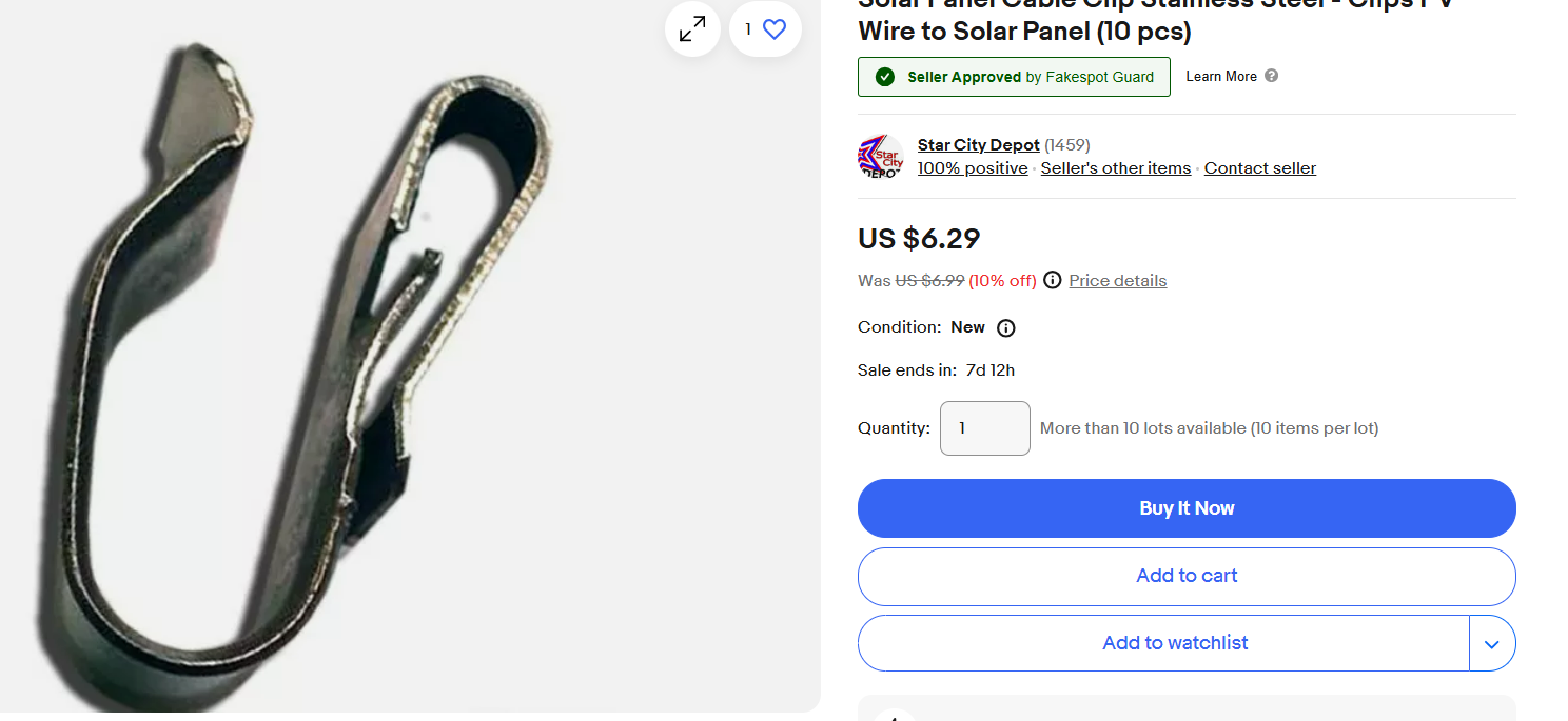

I think the originals were made of leather. And yes, you could probably replace
that piece with something more modern.
Or, could you adapt something like these, adding your own securing device for the
wire?
https://www.ebay.com/itm/335627821505?
Lots of similar hardware designed for securing solar wiring to framework.
Ron
