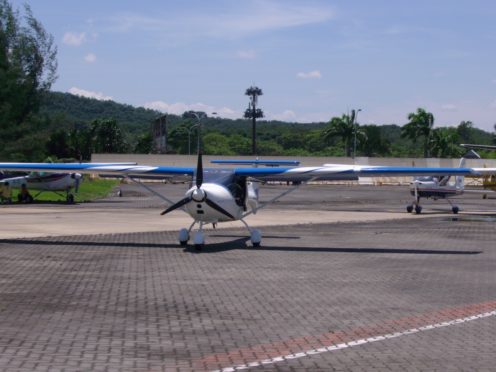

We fly an Allegro 2000 100hp in Thailand with temperatures around 28 to 35 degrees
(82 to 96F). It would overheat within 10 mins of startup at 2200 rpm and needed
very gentle climbouts.
We fitted EvansCool and opened a circular hole in the lower cowling and enlarged
the oil cooler opening about 3 times. (See picture)
The oil runs too cool now and once a day we have to get the oil temperature over
100C (250F) - Rotax say this must be done to avoid condensation problems in
the oil system.
The additional oil cooling and reduction in cyl head temp with the extra airflow
is now acceptable and it never goes over 130C. (Max 150C) We checked the senders
in boiling water - they were underreading on the guage by about 10F.
The best solution is probably to fit the Rotax cooling baffle. I have a friend
with an 80hp who has it fitted and the opening is only about 1.5 in diameter but
it never overheats. The problem is that the baffle is very expensive.
