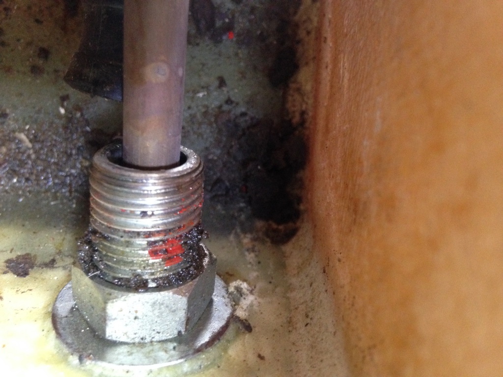

2) My CFI and I smelled fuel in the cockpit at slow flight. After further investigation
I found a puddle under the floor board originating from the fuel tank
outlet connection assembly. Attached below are photos of the assembly and a piece
of what looks like the remnant of a nylon compression gasket. Of course I
have no drawings of how this assembly goes together and no list of parts. This
fuel leak may have simply come from a deteriorated compression gasket. The gascolator
and filter in the gascolator are in good condition and very clean. Please
let me know if there is a nylon compression gasket that should fit up against
the screwed fitting coming out of the fuel tank. Also, in retracting the
fuel pick up tube from the tank, I'm not able to get it completely out. I assume
there is a filter of some sort at the end of the pick up tube which locates
at the low point in the fuselage tank. This will have to be disassembled to
install a new nylon gasket if that is in fact the arrangement that is needed.
Please advise me on how to correct this serious fuel in the cockpit issue.
