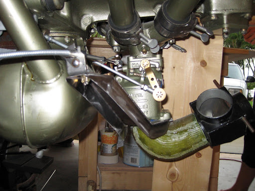

      Peter,=0A=0AMine comes in from the passenger side also. Check out this pict
      ure: http://3.bp.blogspot.com/_EJudOzvIdUA/Shs7qdwwf2I/AAAAAAAAAY0/g8-gPpQf
      dZI/s1600-h/Carb+Inlet+Elbow-15.jpg=0A=0AKevin=0A=0A=0A=0A_________________

      Kevin,
      Thanks, looking at the picture I can see I have a different mixture lever.
      If I can find out what number I need I can order one.
      Many thanks
      Peter
