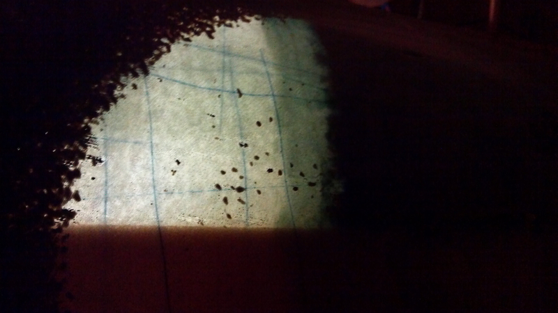

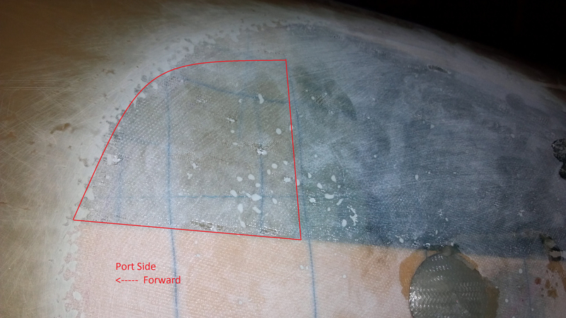

Message 3
| Subject: | Re: Heavy Landing on Tri Gear. |
After reading this post I went to my Europa, which is in the middle of a tri-gear
conversion, and took some pictures of the belly in the area shown in your photos
and was a little surprised. I used a light, put in the hole for the spar,
and shined it down and back towards the landing gear layups. What I noticed
is there is an 1/4 of an area that isn't as reinforced as the rest of the 10"
circle around the LG hole.
This may be the reason for the buckle/dent in the skin. I also have not put the
bottom layup on the belly yet but noticed that the skin can dent inwards with
little pressure.

Message 4
Hello Phil.
Many thanks for taking the trouble to look,
Heavy landing does not sound good as i don,t think i have made one,maybe i should
have just labeled it Dent, although its really a little crease.
However i am reasonable satisfied that all is well as i have made a number of landings
now.
I have been keeping an eye on it and can see nothing of concern, I am not a builder
but maybe one day i will put a piece of bd glass on the inside to push it
out. Yes it is thin in that area , Bird hit ?? , i think the Crow hit the Starboard
Tail Stab, which seem to be my bone of contention, and will be get back
to the forum for more discussion and feed back with Bud and all i hope.
All the best Alan
