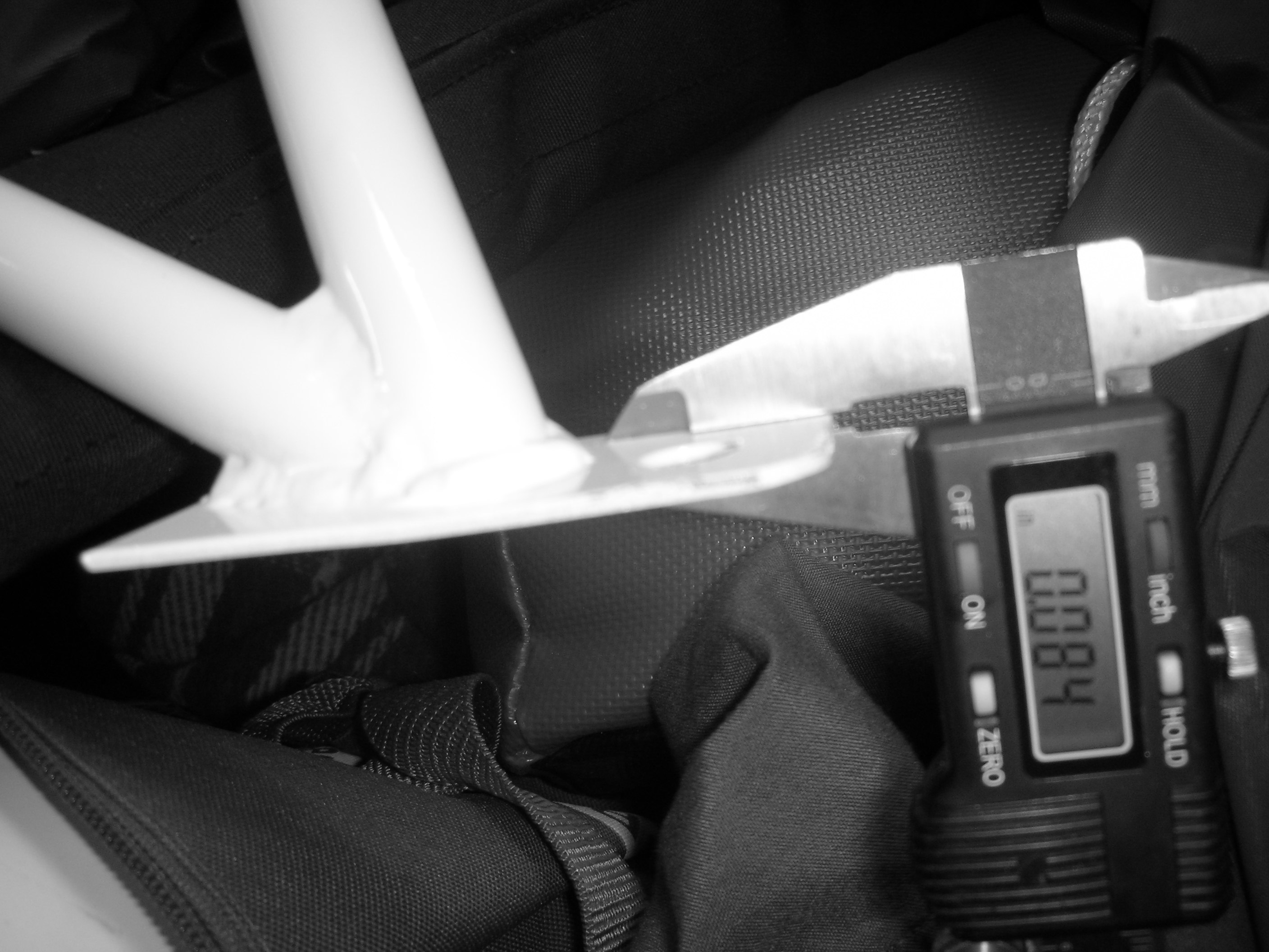

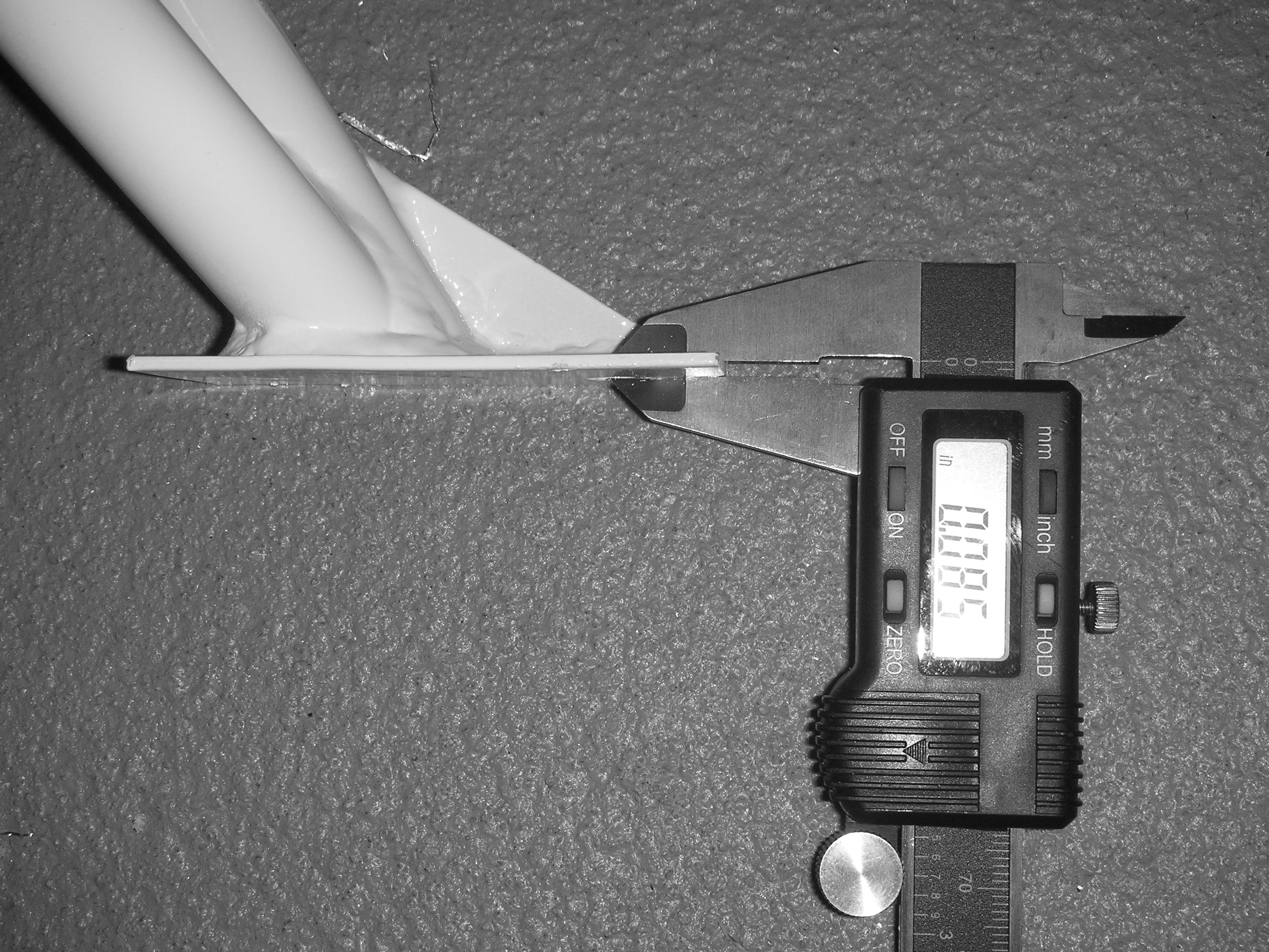

Here are some pics of the suspect Engine mount
http://forums.matronics.com/viewtopic.php?p 2269#202269
http://forums.matronics.com//files/dscn2582_303.jpg
http://forums.matronics.com//files/dscn2572_725.jpg
http://forums.matronics.com//files/dscn2574_235.jpg

Not sure what the problem is , I suspect just the thickness of the powder
coating and nothing more, it is highly unlikely that someone has use
different thickness materials.

The problem is that the plate should be 0.125" [1/8] thick and they are only 0.080"
[3/64]thick. [ they are painted only] They used the wrong thickness material.Received
an email from Jab USA stating that their welder does not use 0.080".I
wonder where they then got this Engine Mount from? [Rolling Eyes]
http://forums.matronics.com/viewtopic.php?p 2389#202389

Looking at my 3300A mount it seems thick. Like .090. Both sides are the
same....
Possibly the botton plates are .060. ????
These mounts should not be powder coated.
Cracks can develop and with powder coatings might not be seen.....
I know many builders do powder coat but Jabiru suggests not....

Your probably right. I was guessing at the thickness.....
I got my mount from Jabiru West.
It looks beefy....
