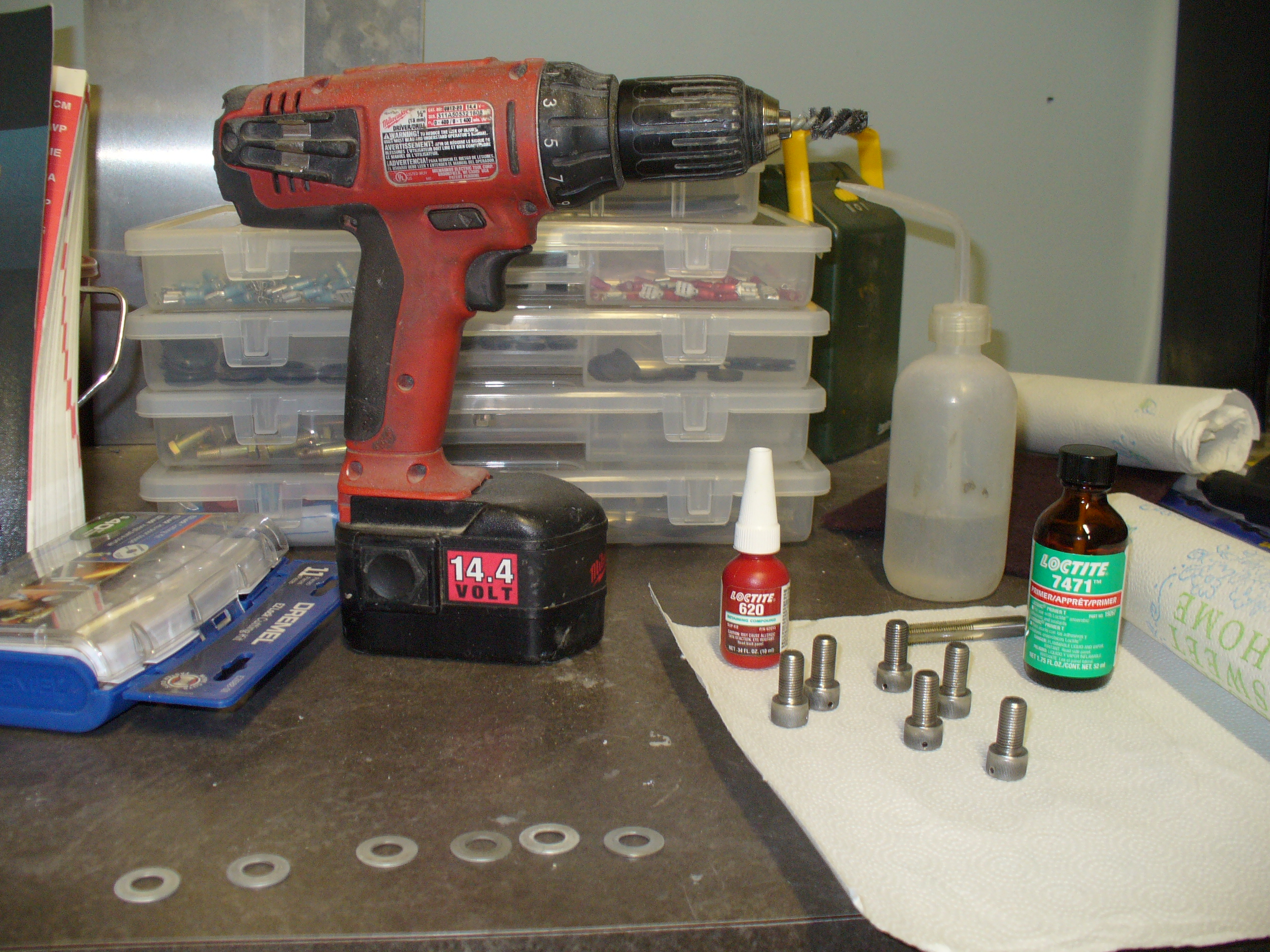

| Subject: | STUCK PROP FLANGE BOLT- HELP ME PLEASE |
You can grab the crank with a pipe wrench and a rag in between.
> Subject: JabiruEngine-List: STUCK PROP FLANGE BOLT- HELP ME PLEASE
> From: michaelherder@beckgroup.com
> Date: Sun=2C 28 Feb 2010 21:31:51 -0800
> To: jabiruengine-list@matronics.com
up.com>
> Guys I'm having a really crappy night.
> This evening I decided to prepare for the final installation of my 2.5" p
rop hub extension on my 3300. In strict accordance with the service bulleti
ns I heated the flange and bolts while protecting the rubber seals with a w
et rag and I safely removed all six bolts. SUCCESS... I thought.
> I thouroghly removed all of the loctite with a dental pick=2C then aceton
e on the female side. I then used a steel brush and cleaned the female thre
ads. I then cleaned the bolts with a wire brush on a wheel. Acetone 3 or fo
ur more times=2C cleaning very thuroghtly=2C making sure not to get oils fr
om my hands on the bolts. Cleaning=2C blowing with compressed air=2C aceton
e repeat... Maybe even too many times=2C but I was determined to not screw
this up!!!.
> As a final check I decided to make sure that all was well and hand screwe
d the bolt in to make sure that it went in smoothly. I used the same bolt o
n three holes and it went in pretty dang smooth. The third one was nearly a
ll the way in (about 1/8" less than all the way in (simulating prop flange
thickness)) and then it got stuck!! I thought surely it can't really be stu
ck=2C I'm not cross threaded and it went in smooth. So I got out my wrench
to back it out. Now it's stuck enough that it turns over the engine and I d
on't have the prop flange on so it's tricky to keep the engine from turning
over.
> I only have two theories as to how this could have happened.
> 1) A little bit of steel from my brush has lodged itself in between the t
hreads???
> 2) The cleaning action of my steel brush rounded off the threads a bit an
d is causing an extremely tight fit?
> 3) The loctite 620 that I thought was completely cleaned off was actually
still there in a residual form and the acetone that I thought was dry was
still a little wet and reactivated the 620?? This one is a long shot. As I
really cleaned these puppies.
> I need help and worst case scenarios here. I am going to have nightmares
about having to replace a crankshaft on account of this.
> What would a good machinist do to get this thing out?
> One Rivet at a Time!
> http://forums.matronics.com/viewtopic.php?p=288699#288699

Heres a couple photos
http://forums.matronics.com/viewtopic.php?p=288738#288738

MIchael,=0A=0AJust in case you have not tried it, See the NOTE at the botto
m of page 1 of JSB 022-1 dated 10/23/01:- -=0A=0A"NOTE:- To prevent c
rankshaft from turning, use a suitable tool & lock the crankshaft.- This
is done by positioing a tool on the ring gear teeth or with a bar under the
first set of flhywheel magnets & the reas set of magnets."=0A=0AI used a l
arge screwdriver wedged in-a ring gear tooth, and the same to check torqu
e at annuals.=0A=0A=0ATony Graziano=0A=0AN493TGl; 558 smooth running hrs on
- Jab3300A- #33A644=0A=0A=0A=0A________________________________=0AFrom:
MHerder <michaelherder@beckgroup.com>=0ATo: jabiruengine-list@matronics.co
m=0ASent: Sun, February 28, 2010 11:31:51 PM=0ASubject: JabiruEngine-List:
STUCK PROP FLANGE BOLT- HELP ME PLEASE=0A=0A--> JabiruEngine-List message p
osted by: "MHerder" <michaelherder@beckgroup.com>=0A=0AGuys I'm having a re
ally crappy night.=0A=0A=0AThis evening I decided to prepare for the final
installation of my 2.5" prop hub extension on my 3300.- In strict accorda
nce with the service bulletins I heated the flange and bolts while protecti
ng the rubber seals with a wet rag and I safely removed all six bolts.- S
UCCESS... I thought.=0A=0A=0AI thouroghly- removed all of the loctite wit
h a dental pick, then acetone on the female side.- I then used a steel br
ush and cleaned the female threads.- I then cleaned the bolts with a wire
brush on a wheel. Acetone 3 or four more times, cleaning very- thuroghtl
y, making sure not to get oils from my hands on the bolts.- Cleaning, blo
wing with compressed air, acetone repeat... Maybe even too many times, but
I was determined to not screw this up!!!.=0A=0AAs a final check I- decide
d to make sure that all was well and hand screwed the bolt in to make sure
that it went in smoothly.- I used the same bolt on three holes and it wen
t in pretty dang smooth.- The third one was nearly all the way in (about
1/8" less than all the way in (simulating prop flange thickness)) and then
it got stuck!!- I thought surely it can't really be stuck, I'm not cross
threaded and it went in smooth.- So I got out my wrench to back it out.
- Now it's stuck enough that it turns over the engine and I don't have th
e prop flange on so it's tricky to keep the engine from turning over.-
=0A=0AI only have two theories as to how this could have happened.=0A=0A1)
- A little bit of steel from my brush has lodged itself in between the th
reads???=0A=0A2)- The cleaning action of my steel brush rounded off the t
hreads a bit- and is causing an extremely tight fit?=0A=0A3)- The locti
te 620 that I thought was completely cleaned off was actually still there i
n a residual form and the acetone that I thought was dry was still a little
wet and reactivated the 620??- This one is a long shot.- As I really c
leaned these puppies.=0A=0AI need help and worst case scenarios here.- I
am going to have nightmares about having to replace a crankshaft on account
of this.- =0A=0AWhat would a good machinist do to get this thing out?=0A
=0A--------=0AOne Rivet at a Time!=0A=0A=0A=0A=0ARead this topic online her
e:=0A=0Ahttp://forums.matronics.com/viewtopic.php?p=288699#288699=0A=0A
