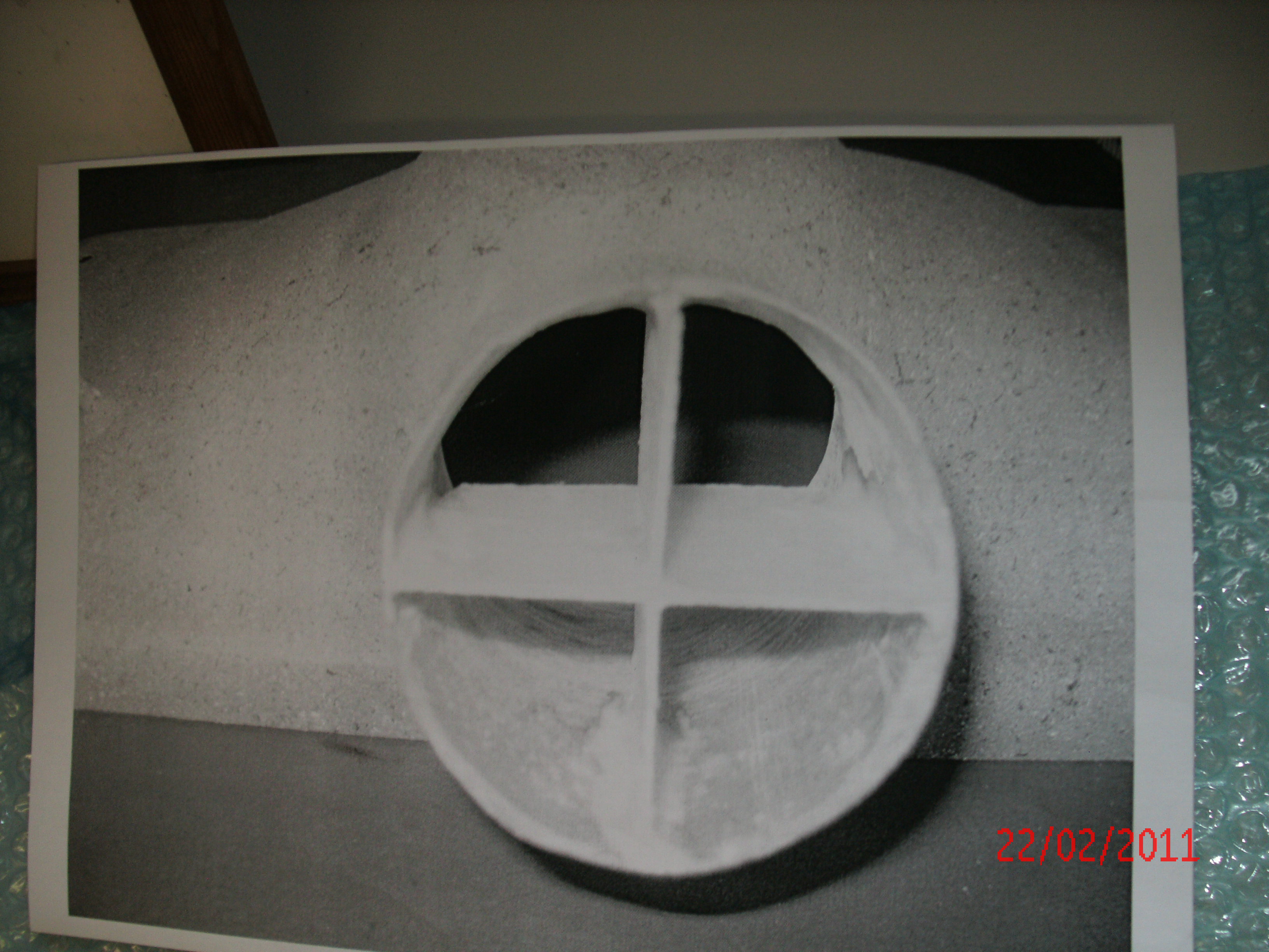

    Have you tried a cross insert in the airbox outlet pipe, this has helped a lot of people even out their EGT's. Just epoxy in some .5mm Al or use thin glass Read this topic online here: http://forums.matronics.com/viewtopic.php?p=333697#333697 Attachments: http://forums.matronics.com//files/gedc1043_106.jpg
