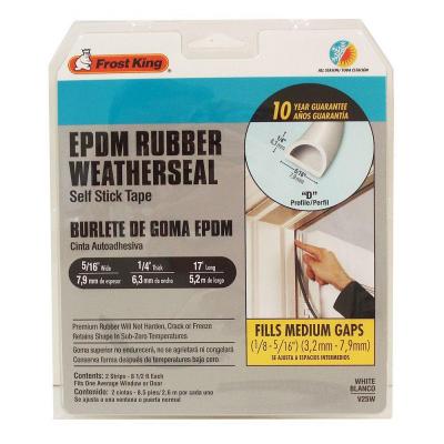

Oi Fabricio,
Most builders are using weather strip commonly found at the local home center or
hardware store. There are a variety of sizes, and shapes that will fill the
gap between the door, and door opening. Attached is the weather strip used on
my KIS TR-1. It has been in place for more than 20 years and seems to be holding
up.

Hello Fabricio, Shop for M-D Products 02576 white P profile tape.

Also comes in black which I am using. I stuck the weather seal on the door
and not the opening so it would be out of the way when entering and leaving
the cockpit.
To seal the bottom edge of the doors you will need a larger type
weatherstrip.

I just did a flox/micro release between the bottom of the door and the fusel
age. No detectable air leakage and no water leakage even in a downpour.
