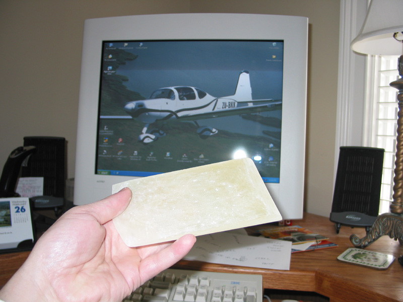

> Attached are two pics from R Reeds site of Harry Herst's TR-4 showing the
> width of the surface involved here. You see how wide the Butyl rubber pad
> is
> - two or three time the width of the radius block. I am pretty sure the
> radius block were developed for metal airplanes. A radius block could be
> custom designed for the TR-4 but it would be much cheaper to add another
> layer of rubber if you were that concerned about the gear being able to
> flex. The other pic shows what a good wedge should look like.
> Speaking of the main gear flexing...the term I use because I never
> considered aluminum to be springy - believe me these aluminum gears will
> flex a hellen. If you left the boots off, and hit hard enough you'd have
> black tire marks on the underside of the wings. Really!

Hard to tell with the bolts and washers in place.
There really should not be all that much load on the aft bolt even with the gear
leg slanted forward. Maybe the aft bolt is getting loaded by the rebound flex
of the center part of the gear leg. If this is the case radius blocks would
be a huge help. Not because of the radius but just because of the added space
and clearance on the center part if the gear box.

Galin,=C2-The amount of distortion on the washers both front and back on
both sides indicates a substantial pull on those bolts resulting either fro
m a twisting of the landing gear or from some rebound of the gear following
a landing.=C2- Were there rubber pads under all of those washers or were
they anchored directly against the fiberglass?=C2- If there were=C2-ru
bber pads under the washers, how thick were they?=C2- The ones that are t
here look rather thin and would not have allowed much=C2-compression.=C2
- =C2-I seem to remember that I had to order longer bolts to allow for
the length needed to include a 1/2 inch=C2-rubber pad under all four wash
ers and between the gear and the underside of the fuselage.=C2-After seei
ng those washers I am thinking the whole thing needs to be beefed up allow
compression of the pads without distortion of the washers by using either t
hicker washers or multiple washers.=C2-By the way, any information on vin
yl wraps from Sun-N-Fun?=C2-Bob Reed
