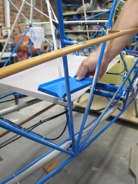

After many delays, I am finally ready to put the fabric on the KF4. I just need
another inspection to be done by our local RAAus inspector, and that's booked
for next Monday. I can't believe that its taken so long to get to this point
(its been 18mths since we brought the part finished kit home).
The last job I did in preparation for the inspection, was to remove the old rear-mounted
battery tray. The tray had been welded in place at the factory, between
three braces on the right side of the fuselage. There were two small weld
beads on each side of each brace, which I cut through using a very fine cutting
disk.
The fuselage had been powder-coated at the factory.
After removing the tray, I noticed that both the tray and the three braces showed
significant rust where they touched. The powder coating had not penetrated
or sealed those contact points, hence the surface was left unprotected, and oxidation
had started. The surface of the braces was pitted. Had I not discovered
this, the rust would have continued to the piont at which the integrity of these
braces may have been compromised. The kit had been stored for many years
in a very dry location prior to our purchasing it, hence this limited the progress
of the oxidation. Once the aircraft began operations however, the amoint
of moisture able to get into thease areas would have been much higher, so I believe
that the speed of oxidation would have increased significantly and, because
of its location, would not have been easily noticed.
I suggest that anyone with a battery tray that has been welded in place at the
factory, especially if their fuselage was also powder-coated, should check the
brace contact points closely. Standard spray painting would not guarantee that
these areas were properly coated either, due to their akward position.
The rust shown on the battery tray edge in photo #0121 is similar, but slightly
less than what I found on the brace where the tray contacted it. Sorry, but by
the time I thought of getting the camera, I had already cleaned and primed the
brace tubes.

Two ways to prevent rust in this location. 1) Use the plastic box in the kit which
has a closely fitting top with a vent to relocate the fumes from a flooded
cell battery. 2) Use a sealed battery. The sealed battery is especially good
as they use a plastic case which does not let battery vapors out from inside the
battery. In this case the Skystar plastic box is not necessary.
In any case a small amount of rubber vetween the battery or plastic box will keep
the paint from wearing off due to vibration.
Of course if you are criticizing the weld integrity then all the welds would be
subject to similar corrosion. I dont think the batt tray is peculiar to bad welds
where paint that did not seal the weld. Anyway It is my belief that battery
vapors is the root cause of corrosion. Otherwise other welds would have the
same problem.
BTW, Powder coating will not cover a weld defect. Any significant pin holes or
cracks would not be sealed by the process.

Colin,
That has always bothered me since I built my Fox. I remember hearing
rattling noises when I moved powder coated items like the horizontal
stabilizer and rudder. Of course they were powdercoated and I couldn't do
anything about it. I ordered a set of powdercoated wing support brackets so
I could tow my aircraft. As I was fabricating the supports to fit I tapped
them on the garage floor after I heard rattling. Out came all sorts of rust.
I don't know if anyone else has experienced that? I also wonder if the
factory treated the tubing with linseed oil before they sealed them? I built
my Fox 1993-1996. Jeff
> need another inspection to be done by our local RAAus inspector, and
> that's booked for next Monday. I can't believe that its taken so long to
> get to this point (its been 18mths since we brought the part finished kit
> home).
> old rear-mounted battery tray. The tray had been welded in place at the
> factory, between three braces on the right side of the fuselage. There
> were two small weld beads on each side of each brace, which I cut through
> using a very fine cutting disk.
> showed significant rust where they touched. The powder coating had not
> penetrated or sealed those contact points, hence the surface was left
> unprotected, and oxidation had started. The surface of the braces was
> pitted. Had I not discovered this, the rust would have continued to the
> piont at which the integrity of these braces may have been compromised.
> The kit had been stored for many years in a very dry location prior to our
> purchasing it, hence this limited the progress of the oxidation. Once the
> aircraft began operations however, the amoint of moisture able to get into
> thease areas would have been much higher, so I believe that the speed of
> oxidation would have increased significantly and, because of its location,
> the factory, especially if their fuselage was also powder-coated, should
> check the brace contact points closely. Standard spray painting would not
> guarantee that these areas were properly coated either, due to their
> akward position.
> slightly less than what I found on the brace where the tray contacted it.
> Sorry, but by the time I thought of getting the camera, I had already
> cleaned and primed the brace tubes.
