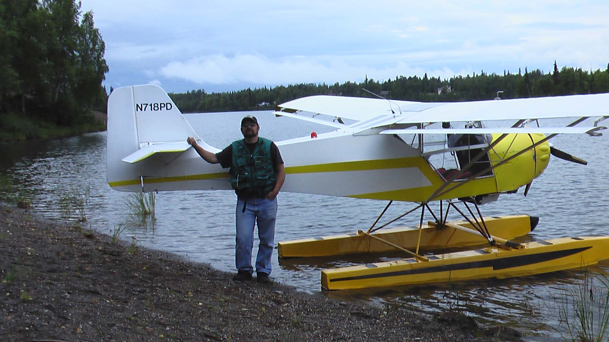

      the floats are a scaled down version of the northaires that were made of fiberglass.
      They are foam filled with no hatches or pump outs.. I am not fond of the
      foam filling or no pump outs, but they are on my brothers plane not mine!  I
      have a set of the northaire drawings, and will copy them in autocad, then scale
      them to the dimensions he has.  After that it will be easy to find the volume...
      now I just need time to model them in cad.
      I installed the floats on his plane last week and did the test flying.  solo it
      was great, but with 2 200+ guys, a full nose tank and 7 gallns in the wing, it
      was a bit of a slug to get off the water.  she sat a little low for my liking,
      but most beaver drivers up here will tell you that any float left sticking
      out of the water is wasted revenue (only partialy kidding here).
      > were made of fiberglass.  They are foam filled with no
      > hatches or pump outs.. I am not fond of the foam filling or
      > autocad, then scale them to the dimensions he has.  After
      > that it will be easy to find the volume... now I just need
      > test flying.  solo it was great, but with 2 200+ guys, a full
      > nose tank and 7 gallns in the wing, it was a bit of a slug to
      > get off the water.  she sat a little low for my liking, but
      > sticking out of the water is wasted revenue (only partialy
      > kidding here).
