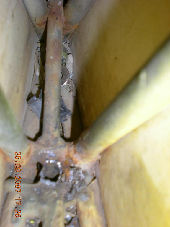

Hi everone,
When I made my landing sunday, I noticed I could not steer my Kitfox either left
or right and was unable to vacate the runway.
So, I stopped the engine, looked behind and saw the front bolt of the tailwheelspring
had broken. Of course, the rudder rested on the tailwheel, causing some
very little damage there.
I was horrified when I made a closer inspection with my camera.
The picture showed that not only the bolt was broken but a piece of the tubing
was also broken off.
I have no idea how this tube was exactly, so can anybody send me some good clear
pictures of this tail section (before covering) so that I can see how the fuselage
should be normally ?
Many thanks in advance.

> From: Michel Dierick [michel.dierick@skynet.be]
> tailwheelspring had broken.
Wow! That's really strange, Michel! I can't imagine how that bolt could break.
Was it pulled through? Sheared? How about the bracket and the two bolts that hold
the spring in place? Do you think it happened by an up-down force or by a
side force?
Sorry, I can't help you with the inside view, I didn't built my aircraft myself,
I am just puzzled but the breaking of that bolt. I didn't think it was possible
under normal circumstances. But then ... I still have lot to learn.
Cheers,
Michel Verheughe
Norway

| Subject: | Re: Tailwheel bolt went off.... and the rest |
looks like it has been repaired before?
Rusty too ?
whats up with that ?
Does not look too healthy .
> Rusty too ?
.... Okay, when I read Michel's email yesterday night, it was through
my ISP web interface and I didn't see the photos (plain-text-only
interface). Today, Dave's answer made me think there was some photos
attached. I went to the forum.matronics.com and saw them. Yes, there is
a bit of rust there but ... it brought a question to my mind.
My Kitfox model 3 was delivered and built with one spring leaf that
lasted about 950 landings before breaking. I have now a new main leaf
and a 'helper.' I read that most people (and John sells) a three-leafs
set. I see that it is what Michel has. Then I wonder. If the plane is
designed for one leaf and it is later changed to three ... is it wise?
I mean, three leaves doesn't reduce the load on the tail when landing
or taxiing on rough surface. If it prevents the spring to break,
doesn't it then invite rupture to happen somewhere else? Just
wondering.
Cheers,
Michel Verheughe
Norway
Kitfox 3 - Jabiru 2200

Message 12
Michel,
You could have a point there.
A other piece I want to change is the tail wheel self. This is for the moment one
of plain rubber/plastic, anyhow, very hard and absolutely not chock-absorbing
at all. I already decided to change this in a air-chamber like the one on
my glider, but this is only a minor problem now.
I'm afraid I will have to open the rear fuselage for the repair.
That's why I'd like to have some pictures of the tail section before covering.
