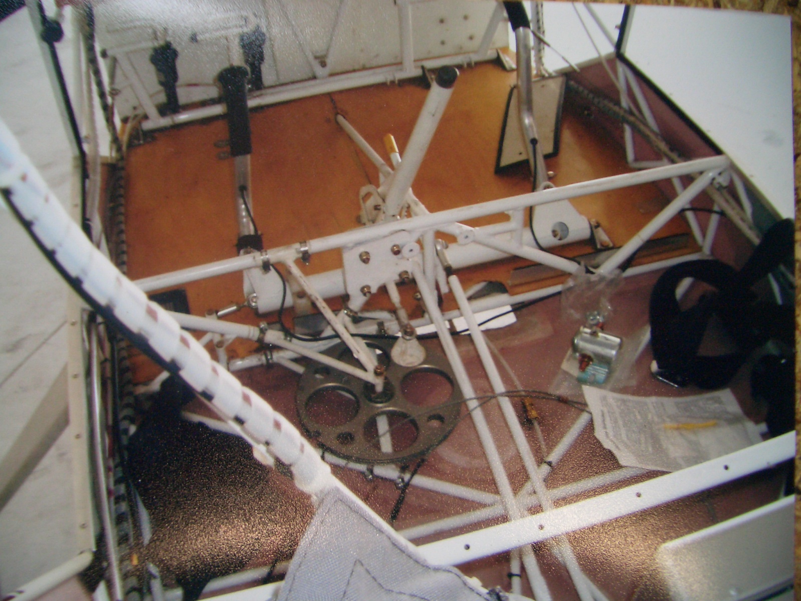

A few more...
http://forums.matronics.com/viewtopic.php?p=140213#140213
http://forums.matronics.com//files/cimg5510_109.jpg
http://forums.matronics.com//files/cimg5509_139.jpg
http://forums.matronics.com//files/cimg5507_153.jpg
