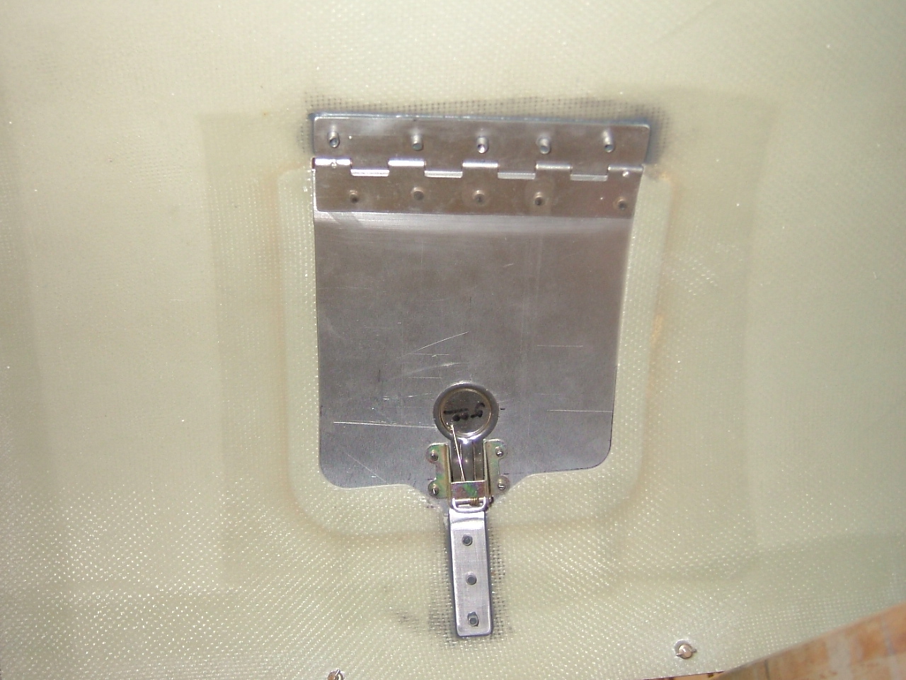

      I think  the one I used is the Camloc access door. p/n05-02124...
      $12.50 ea, page 107 of this year's Aircraft Spruce Catalog...and let
      me go on record as saying that the Spruce cat. has to be one of the
      MOST frustrating to try to find anything...like this....in!  You've
      got to paw through the pages as opposed to going to the going to the
      index, because either they don't know what to call something, or they
      assign a page number to it, and it's not there, or even close to
      there.......ok, rant over, if you persevere, you'll find it, I'm sure.
      Lynn Matteson
      Grass Lake, Michigan
      Kitfox IV Speedster  w/Jabiru 2200
      flying w/440+ hrs
      On Nov 27, 2007, at 11:45 PM, Guy Buchanan wrote:
      > At 07:19 AM 11/27/2007, you wrote:
      >>   Can anyone tell me how to make access hole through the
      >> fiberglass for the oil or where I can buy one to install, this
      >> would be for 582 oil injector tank
      >  Attach the door with a short piano hinge and use a Cessna oil door
      > latch to latch it. (I tried finding the latch at ACS and via Google
      > and had no luck. I'm sure it's available after-market. I found a
      > bunch of Cessna parts at www.broadiesaircraft.com.)
      > Guy Buchanan
      > San Diego, CA
      > K-IV 1200 / 582-C / Warp / 100% done, thanks mostly to Bob Ducar.

| Subject:  | Re: access cover for oil |
      Jerry,
      The Series 7 has a molded impression for the oil door which is cut out and an aluminum
      cover is hand bent to shape and installed with an aluminum piano hinge.
      The Kitfox manual has you secure the latch using winged camlocs but I like
      the flush latch closure better.  If your cowl doesn't have the molded impression,
      simply fabricate a latch cover from a piece of aluminum that is the same thickness
      as your cowl then bend it to shape.  Once you are satisfied with the
      shape, you can place this cover on the cowl and trace it.  Then carefully cut
      and sand/file the opening to shape allowing for a 1/16 clearance on each side.
      Then glue and rivet strips of aluminum under the cowl for the latch to rest
      against and finish the install by gluing and riveting the piano hinge on.  The
      piano hinge knuckles will require a bit more than 1/16" clearance so trial fit
      this and trim as necessary.  See my installation for ideas.  This is a good,
      functional installation and looks good to.  Hope this helps.
      Darin Hawkes
      Series 7 (under Construction)
      914 Turbo
      Ogden, Utah
      http://forums.matronics.com/viewtopic.php?p=149225#149225
      As Guy said, the piece you cut out of the cowling makes a perfect
      door, there's no need to fabricate one.  On my Model IV I had to put
      the opening directly in the center to align with the oil tank and it
      would have been tricky to precisely bend a piece of aluminum to the
      shape of the cowl which had a ridge down the middle.
      I cut an aluminum frame to go under the opening to act as the stop
      for the door and to reinforce the fiberglass.  A piano hinge, a flush
      latch, and some filler were all that was needed to make for a very
      functional and attractive installation.
      Mike G.
      N728KF
      Phoenix, AZ
