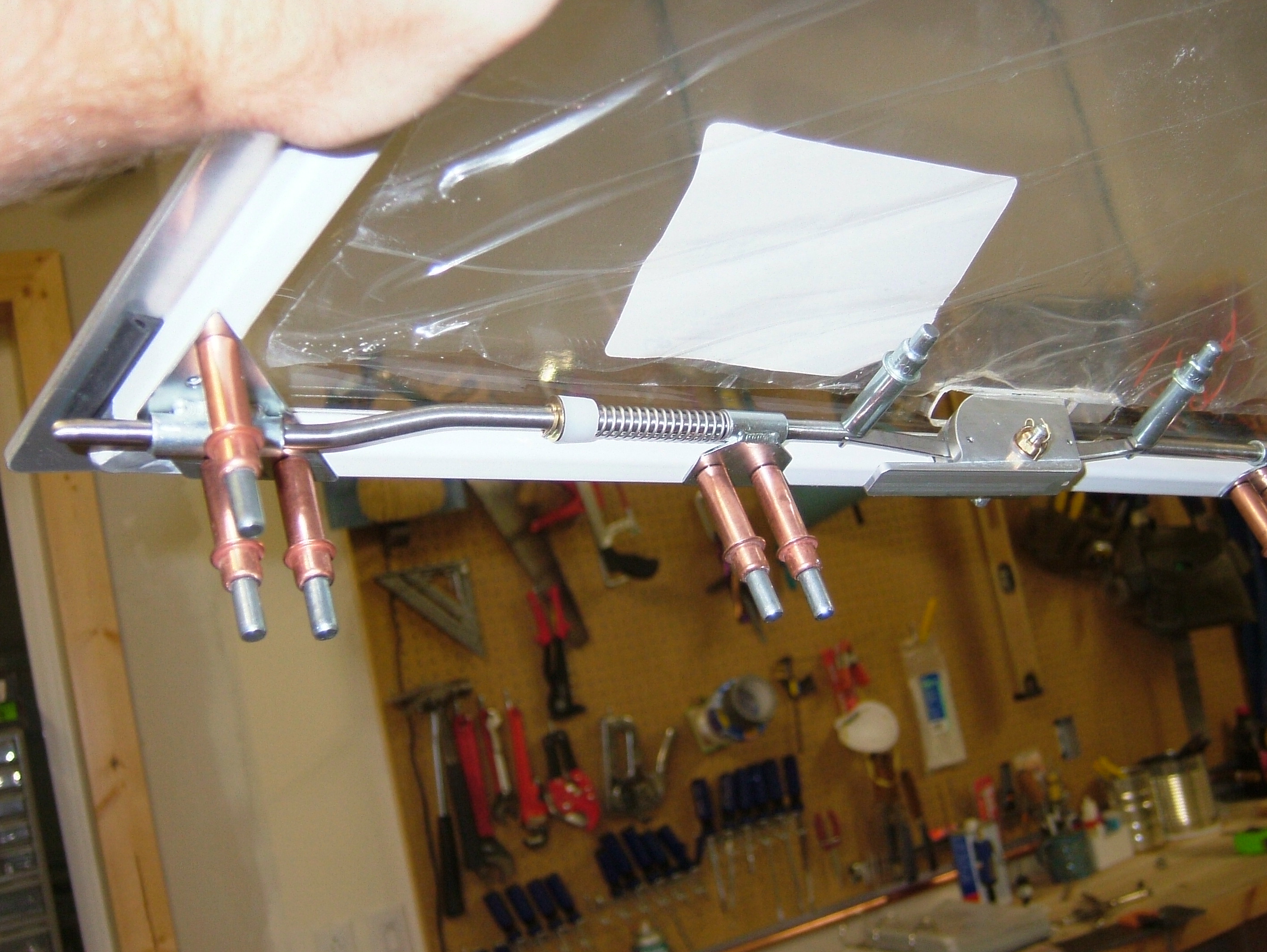

Message 19
| Subject:  | Re: Door Latching you really Like? |
      Lee,
      Here is how my Series 7 latches are done.  Don't know what model you have but something
      like this could be fitted to any door with some thought.  These are the
      optional door latches that Skystar supplied with the kits...I would assume
      John McBean is still using this same setup and so you could get them from him.
      Darin Hawkes
      Series 7 (under Construction)
      914 Turbo
      Kaysville, Utah
      http://forums.matronics.com/viewtopic.php?p=164513#164513
      http://forums.matronics.com//files/dscf1530_203.jpg
Message 20
      Lynn, Thanks for the pics. I don't have the double tube in the center of th
      e door. But, when I saw the bell crank the lights came on. I closed up the
      legs on a 3" pc of 1/16th x 1 1/2"  alum angle to grip the sides of my sing
      le mid door bar, drilled a hole in it, installed a 10-24 rivet nut for a 1/
      4" shoulder bolt for the bell crank pivot and riveted it to that mid door b
      ar 6 1/4 " back from the existing sprung front door latch. The bell crank i
      s 1/4"x 1" alumninum stock. I left it 4" longer on the bottom, bent it in t
      o match the door angle and drilled it full of lightening holes to use as th
      e interior door handle. I'll run 1/8 x 3/4 aluminum actuator rods fore and
      aft after I drill them full of lightening holes, and add a pin in the botto
      m of the handle sticking out a slot in the door for an exterior knob.
      Us old guys that cut our teeth fabricating motorcycle, streetrod, and racer
      car parts have it easy with these experimental airplanes, don't we?
      Old cars are fun, motorcycles are crazy, but airplanes they"re insane!
      Lovin it in Rockford!
      Pat Reilly
