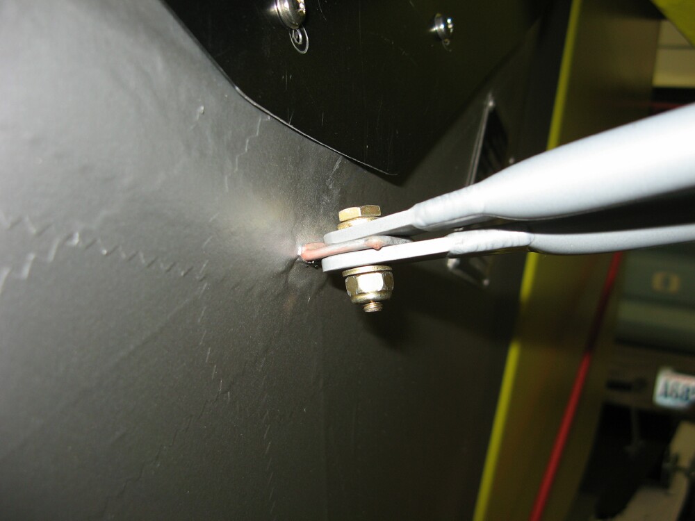

    Subject: Re: horizontal stabilizer
    From: "Tom Jones" <nahsikhs@elltel.net>
    > I attached the rod ends to the horizontal stabilizer but when I tried to attach the struts to the fuseledge tab the rounded portions of the struts touched preventing the flattened areas to go together. I suppose I could add washers to fix this problem but I would think the flattened areas of the struts should go together and touch the tab. > > Any suggestions? Mike, the front strut goes on top of the fuselage tab and the bottom strut goes on the bottom of the fuselage tab. Mine do not touch each other but if they did I would install washer(s) for clearance. You may need to use a longer bolt if you need the extra washers. Also, the single piece V struts were the original struts. The modifications are the Two piece for each side (4 total) with two rod ends on each side for the outboard ends (front and rear). Picture of inboard ends attached. -------- Tom Jones Classic IV, Phase one 503 Rotax, 72 inch Two blade Warp Ellensburg, WA Read this topic online here: http://forums.matronics.com/viewtopic.php?p=164636#164636 Attachments: http://forums.matronics.com//files/horizontal_stab_strut_160.jpg

    From: Guy Buchanan <bnn@nethere.com>
    At 05:58 PM 2/16/2008, you wrote: >I suppose I could add washers to fix this problem but I would think >the flattened areas of the struts should go together and touch the tab. Two possibilities: 1. Bend the outboard edges of the fuselage tab up to conform to the struts using a crescent wrench. 2. Grind the fuselage tab back. You only require one full hole diameter of metal outside the hole for full strength. (Probably 3/16") Guy Buchanan San Diego, CA K-IV 1200 / 582-C / Warp / 100% done, thanks mostly to Bob Ducar.
