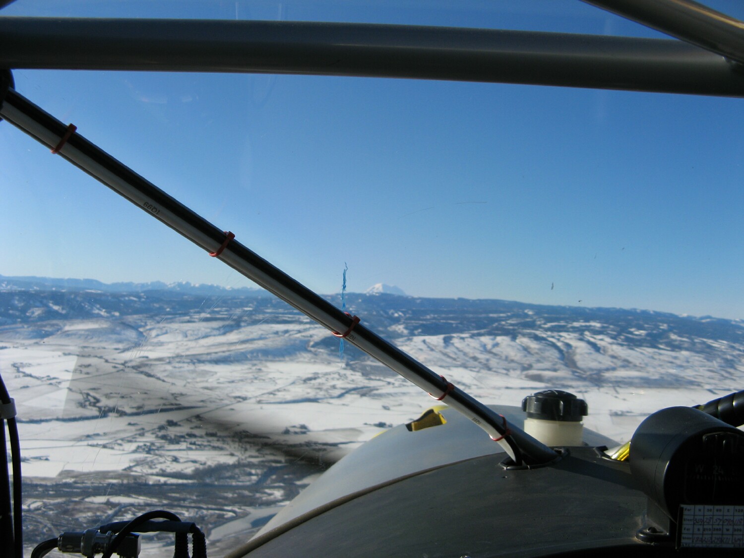

corbob13 wrote:
> Guys,
> I recent bought and, just on Sunday, started flying a Kitfox Model II. I've
flown in it a few times, but no take-offs or landings. On Sunday I was out with
my instructor (working on my tailwheel endorsement) and on our first landing
the left side gear leg collapsed during roll out. The field was soft, as was
the landing, but the plane just tipped onto its side. Luckily no damage other
than the gear.
> I assume it is the result of fatigue from earlier poor landings. I looked the
plane over quite thoroughly before buying and noticed nothing, as well as during
the preflight. Has there been an issue with the gear on the Model IIs?
Cory,
Is your instructor experienced with landing the Kitfox. The tube gear is prone
to breaking if the plane is landed in a crab. The engine cowl tapers significantly
from the rear to the nose and gives the pilot the impression the plane
is in a crab when it is straight and vise versa. being a relatively new kitfox
pilot myself I can attest that this illusion is real. There was a post a few
years ago from a Kitfox owner that was taking a flight review in his own kitfox
and had to make a few landings to convince his instructor and even then the
instructor tried to touch down with the plane in a crab.
Before I flew my kitfox the first time I stood behind it and lined the centerline
up with a water tower about 200 yards away. I then sat in the seat and made
a mark on the windshield that lined up on the water tower. When landing this
line must be lined up on the runway centerline.
A picture of my "Kitfox landing site line is attached".
Tom Jones
Classic IV
Ellensburg, WA
http://forums.matronics.com/viewtopic.php?p=174570#174570
http://forums.matronics.com//files/kitfox_landing_sight_line_292.jpg

If you could post some pictures of the broken gear it may help others
when we double check our own gear legs for problems.
Dave Wahlquist
centerline up with a water tower about 200 yards away. I then sat in
the seat and made a mark on the windshield that lined up on the water
tower. When landing this line must be lined up on the runway
centerline.
Tom Jones
Classic IV
Ellensburg, WA

Message 9
| Subject: | Desert Fox Squadron Fly-in Photos |
> From: Lynn Matteson [lynnmatt@jps.net]
> Nice...I'm jealous!
So am I. And, Mike, can you send me some of that blue stuff over the horizon and
the yellow disk in it. We haven't seen that for weeks, over here! :-(
Cheers,
Michel Verheughe
Norway
Kitfox 3 - Jabiru 2200
</b></font></pre></body></html>
Message 10
Michel sez:
>...And, Mike, can you send me some of that blue stuff over the
>horizon and the yellow disk in it. We haven't seen that for weeks,
>over here! :-(
For you, Michel, anything!
Mike G.
N728KF
Phoenix, AZ
