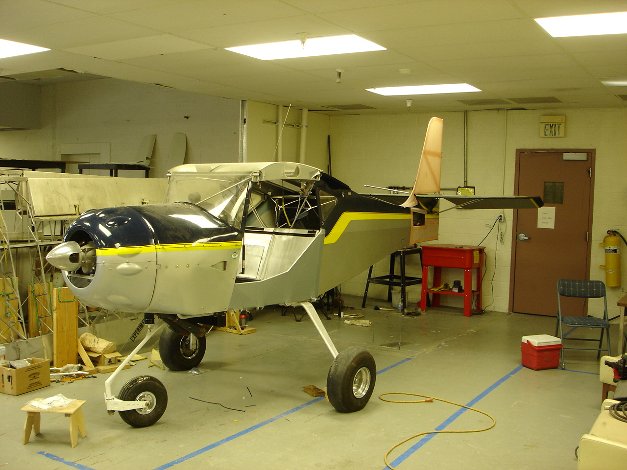

Message 16
When I did my rebuild, I needed to add weight to the tail to offset the weight
from the added nose wheel. I moved the battery to the tail section and welded
in a plate with two upright bolts for holding ballast. I used lead weights for
ballast with two holes drilled through them which line up with the two upright
bolts. Wing nuts hold the lead ballast tightly in place. Note the open access
under the horizontal stabilizer in the attached photo. We built a sheet
metal plate to cover the access.
Steve Wilson
Huntsville, UT
Kitfox I-IV 85DD
912A / 3 Blade Warp Drive
Convertable Nosewheel & Tailwheel
http://forums.matronics.com/viewtopic.php?p=180605#180605
http://forums.matronics.com//files/10_29_2007_462.jpg
