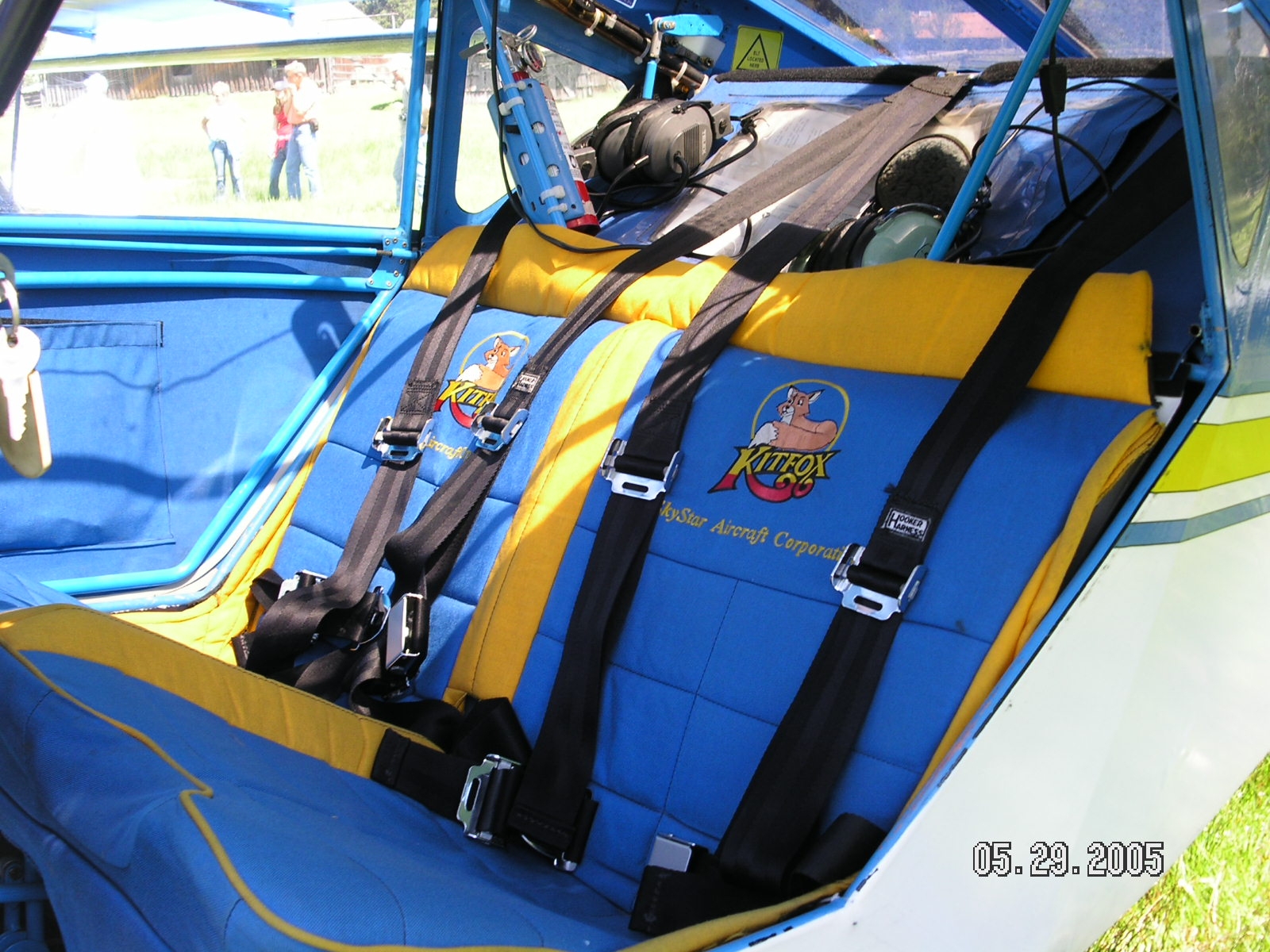

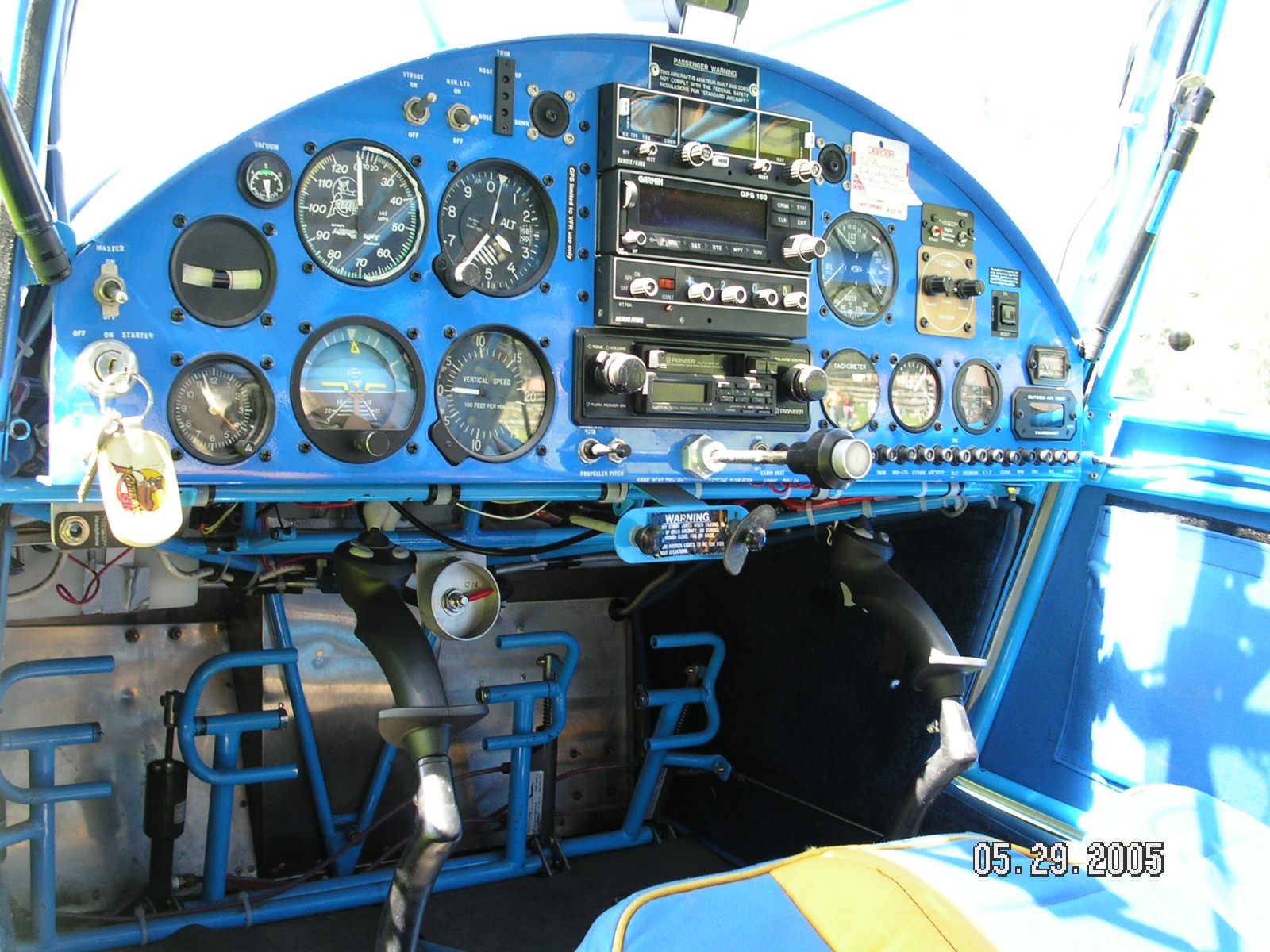

Message 17
| Subject:  | Kitfox for sale: Model IV 1200 with 912UL |
      I love my Kitfox but my wife wants me to upgrade to a four seater so that we can
      use it for family vacations. Who am I to argue? Posting here first. I'll put
      it up on Barnstormers after a bit. Asking $31K. Here are some details and a couple
      of pictures:
      912UL with 320 hours.
      IVO in flight adjustable prop
      Grove Gear with Tundra tires & Maule tail wheel
      Wing and under seat lockers
      Bendix/King navcom and transponder with mode C
      Garmin GPS 150
      Belly storage pod
      Luis Rodriguez
      Model IV 1200
      Rotax 912UL
      Flying Weekly
      Laurens, SC (34A)
      http://forums.matronics.com/viewtopic.php?p 0354#200354
      http://forums.matronics.com//files/dscn0639_163.jpg
      http://forums.matronics.com//files/scaled_6a56_800x600_a80042p1348685681orig_181.jpg
      http://forums.matronics.com//files/scaled_fa6c_800x600_a80042p1369227780orig_194.jpg
