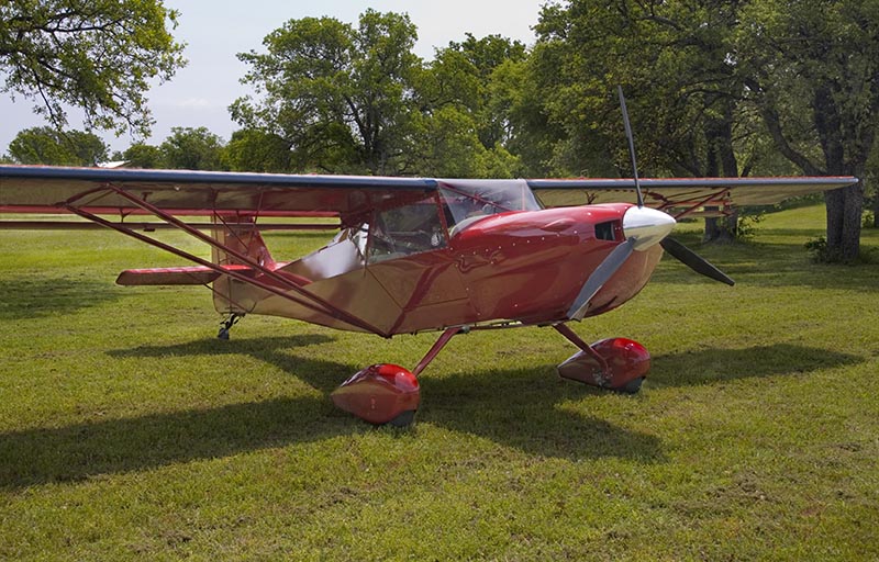

| Subject: | Re: My Series 5 - Testing picture upload |
That works, and looks good, John.
Lynn Matteson
Jabiru 2200, #2062, 600.2 hrs
Sensenich 62x46
New skis done and flying
On Jan 30, 2009, at 11:28 PM, jbonewitz wrote:
> Just testing out the posting of photos to the forum. Here's a shot
> of my Series 5.
> John Bonewitz
> http://forums.matronics.com/viewtopic.php?p=227820#227820
> http://forums.matronics.com//files/fox_at_keizer_112.jpg

Message 8
WOOOOOHHHH ! is that a beautiful plane !!!! I am going to take mine back to
the "soap box derby" Dick Maddux
Pensacola,Fl

Message 10
It looks too shiny to be Poly-tone to me. I'd hazard a guess of
Aerothane or automobile paint.
Lynn Matteson
Sensenich 62x46
On Jan 31, 2009, at 5:09 AM, Paul Franz - Merlin GT wrote:
> <paul@eucleides.com>
>> of my Series 5.
> Nice looking. Is that Polytone? Obviously you mastered posting.
> Nice way to use the
> Kitfox List.
> Paul A. Franz
> Registration/Aircraft - N14UW/Merlin GT
> Engine/Prop - Rotax 914/NSI CAP
> Bellevue WA
> 425.241.1618 Cell

Message 15
Great looking machine! Your located in Grapevine,TX? Is the plane near by?
That I saw on one of your posts that you keep it at the Arlington airport.---Leon
Morris/Classic 4 Speedster/65%/Flower Mound, TX
---- jbonewitz <bonewitz@gmail.com> wrote:
> Just testing out the posting of photos to the forum. Here's a shot of my Series
5.
> John Bonewitz

Message 19
Close. It's AirTech, which is a two-part polyurethane material.
John Bonewitz
On Sat, Jan 31, 2009 at 11:03 AM, Lynn Matteson <lynnmatt@jps.net> wrote:
> It looks too shiny to be Poly-tone to me. I'd hazard a guess of Aerothane
> Lynn Matteson
> Kitfox IV Speedster, taildragger
> Sensenich 62x46
> Electroair direct-fire ignition system
> do not archive
>> paul@eucleides.com>
>>> Series 5.
>> Nice looking. Is that Polytone? Obviously you mastered posting. Nice way
>> to use the
>> Kitfox List.
>> Paul A. Franz
>> Bellevue WA
>> 425.241.1618 Cell
