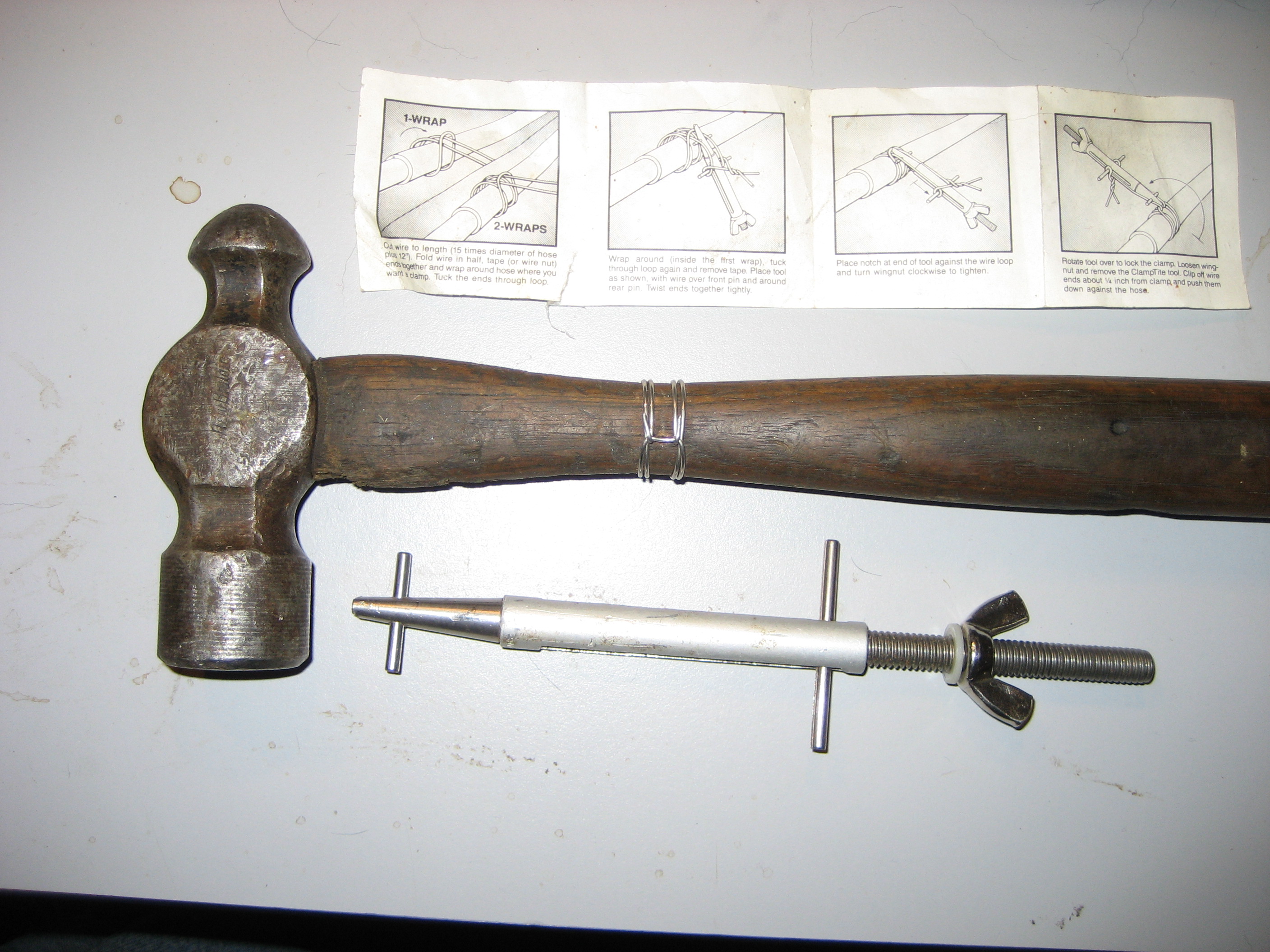

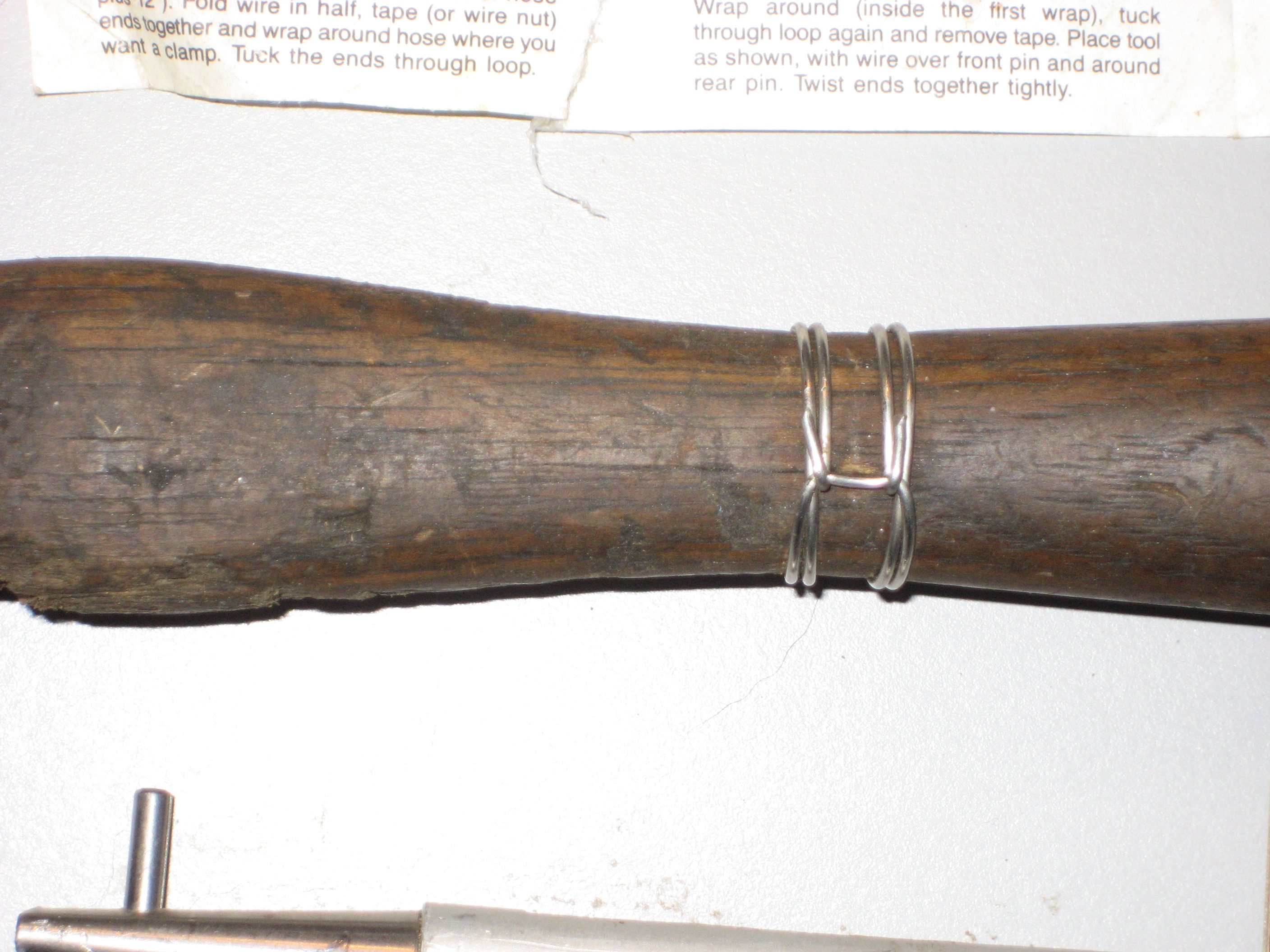

The tool I used to fasten the two ends of a bungee cord together and for many other
things I first saw at an air show but didn't buy it. Later I wished I had
and then did a great deal of searching and found the source. Regretfully, I don't
have that information easily at hand anymore.
The first picture shows the tool and a broken hammer handle I fixed with it using
safety wire.
The next photo is a closeup of the safety wire repair. You can make as many wraps
as you like. I made 6 wraps on bungee cords which is 12 strands. I think 3
wraps (6 strands) is plenty.
The last photo is a scan of the instructions that came with the tool. The repair
job was my first trial with the tool. I've been using that hammer for years
since making the repair and it is tight and holds together like new.

http://www.clamptitetools.com/ Watch the video in the instructions section.
Best price $27.50 http://www.gemplers.com/product/HC8/Clamptite-Tool-Standard-4-3-4
read about it on the Supercub.org http://www.supercub.org/phpbb2/viewtopic.php?t=17955&highlight=safety+wire+tool

I saw something very similar to that in a GarrettWade catalog....
(lurker wishing he had a kitfox...)

Oops. I screwed up the picture posting. Left off the instructions and somehow posted
two pictures of the same thing. Here's the instructions. Here they are.

That's a "clamp-tite" tool. Get 'em cheapest on e-bay. Handy device, once y
ou get the hang of using it.
ny
other things I first saw at an air show but didn't buy it. Later I wished I
had and then did a great deal of searching and found the source. Regretfull
y, I
don't have that information easily at hand anymore.
using safety wire.
wraps as you like. I made 6 wraps on bungee cords which is 12 strands. I th
ink 3
repair job was my first trial with the tool. I've been using that hammer fo
r
years since making the repair and it is tight and holds together like new.
