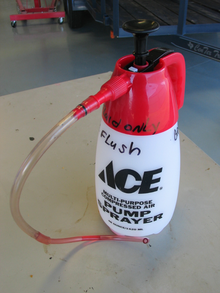

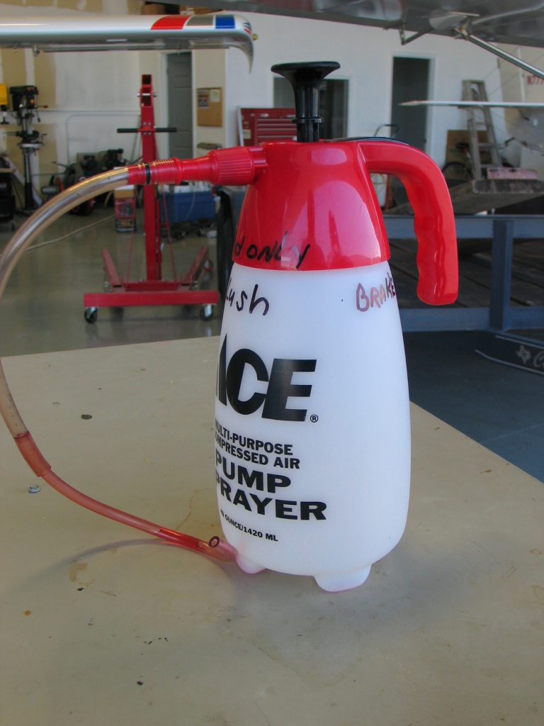

here is what I use for a brake bleeder. works like a charm. and it is only about
$10. I picked it up at Ace Hardware. One of the best things I ever bought. It
makes bleeding brakes very easy and fast. It blows out all the air bubbles.
Roger Lee
Tucson, Az.
Light Sport Repairman - Maintenance Rated
Rotax Repair Center
520-574-1080
