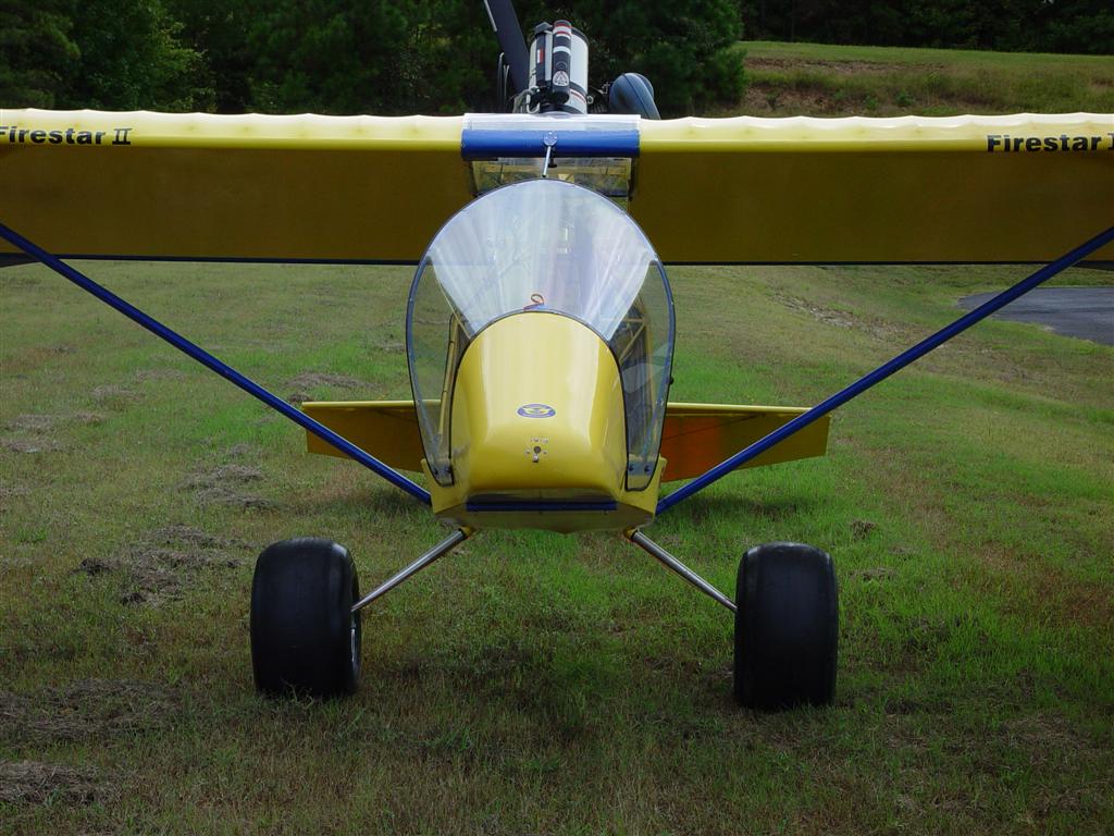

Would they fit on a rim that currently has 600x6 tires on it? How tall are
they?
-----Original Message-----
From: owner-kitfox-list-server@matronics.com
[mailto:owner-kitfox-list-server@matronics.com] On Behalf Of Carolina Flyer
Sent: Wednesday, October 06, 2010 10:31 PM
Subject: Kitfox-List: Tundra Tires
Hello Everyone,
I have seen many people have the Carlisle golf cart tires on a 6" rim and
call them Tundra Tires.... They are Heavy and Stiff, and the size is all I
see that is close to being what is referred to as a Tundra Tire.....The
Carlisle Tire is a very good tire, but I do not think it Preforms like Real
Tundra Tires do....These Tires I have are Soft and only use between 5 and 10
pounds of air, and they are Light Weight........... They act like the Big
Boys Tundra Tires in Alaska...... The Rims I have are 8" in Diameter, and
fit on Black Max and Hegar wheel hubs, and maybe others..... Anyway I would
like your input on what you think about my Tire and Wheel Combo........ If
anyone thinks they would like to have a set for their Kitfox send me an
e-mail..... These work Fantastic on my Kolb, and I even sold a set to Rotax
Rick that is on Barnstormers..... He is a Rotax Repair Center down in
Florida.... Anyway he has a set on his Quicksilver that has a Rotax 670, and
he loves them. I thin!
k these have been the best mod I have done on my Kolb Firestar II.......
Joe
Kolb Firestar II
503 C-Box / RK400 Clutch
Phantom
503 B-Box
http://forums.matronics.com/viewtopic.php?p=314991#314991

Message 6
| Subject: | Re: Tundra Tires |
The Nanking or "KingFox" tires are for an 8" (ATV-type) wheel.
Av8r3400
Kitfox Model IV-1200 W/912UL & IVO
Kitfox Model IV-1050 W/912UL & Warp
http://forums.matronics.com/viewtopic.php?p=315074#315074
Message 7
It is Correct that these tires will only fit on a Wheel that has a 8" Diameter,
and the preferred rim needs to be 8" to 9" wide.... However the Wheels I have
have been made especially for this type of tire....... They are not ATV Wheels,
and they are one piece tubeless rims that will fit the Black Max Brake System,
and also the Hegar Wheel Hubs...... The Wheels have a 3 bolt pattern, and
ATV wheels have 4 lugs....... As I said these wheels have been Custom Made for
me. I am also a Black Max Dealer. and can supply the Brakes and whatever else
is needed. These wheels are even Heat Treated......... The Tire and Wheel combo
I am offering will be shipped already mounted, and filled with air.....Any
more questions please send me an E-Mail
Kolb Firestar II
Phantom
503 B-Box
Location : Buffalo South Carolina

Message 8
Dick,
What you said about the Tires is so TURE, These Tires are Awesome, and I am sure
you agree with me on that. I have a Phantom, and a Kolb Firestar, and I try
to keep everything as light as possible. I have been looking around for the past
couple of years for the Best Tire, Wheel and Brake Combination. I agree with
you that the Nanco Tire is the best Bang for the Buck. However I also wanted
the Best and Lightest Wheel and Brake Combination I could find. When I was looking
for Bakes the Black Max System was the Best and Lightest System I could
find, and Black Max Brakes have readily available parts.. It is a very Light and
Simple Set-Up thats easy to install, but there were no 3 bolt pattern wheels
that would fit the Black Max System, and that the 21" x 12" x 8" Nanco tire
would fit..... So I had to have the Wheels Custom made.... I feel that what I
have put together is the Best and Lightest Tundra Tire System for my needs. Everyone
that has seen my Kolb just loves my Tires and Wheels, and everyone that
has bought this Set-up has loved them...... I am just trying to offer People
something that Light and Simple and Trouble Free...............Thanks...... Joe
Kolb Firestar II
Phantom
503 B-Box
http://forums.matronics.com/viewtopic.php?p=315085#315085
http://forums.matronics.com//files/dsc00446_large_206.jpg
