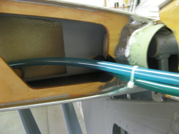

    Hello Fellow Kitfox Drivers, I re-sloshed my wing tanks last summer. I had to cut off the old brass elbow fitting with a dremel tool so I could get the finger strainer out. Now I have been looking to get the whole assembly back together. I cannot seem to find a swivel fitting that will allow me to use the original finger strainer (3/8 NPT). I need a 1/4 NPT male swivel 90 degree low profile. Or some sort of banjo fitting (already tried the ANDAIR BANJO FITTING FML 1/4"). This is too long. I only have 1.25" from the wing tank to the inside of the first rib. What are the rest of you guys using after the tank have been installed? Thanks, Kirk N198KM

    Kirk, my kit came with a straight fitting to attach to the finger strainer. The manual says to notch the rib to clear the fitting and fuel line. You will probably have to notch the butt rib also. picture attached. -------- Tom Jones Classic IV 503 Rotax, 72 inch Two blade Warp Ellensburg, WA Read this topic online here: http://forums.matronics.com/viewtopic.php?p=330931#330931 Attachments: http://forums.matronics.com//files/tank_fitting_129.jpg

    Kirk, You can use a street elbow in the finger strainer pointed whichever way you want then put a straight male fitting in the elbow. Worked for me. Available at your local hardware store. Jay S-6 290-D2 Lyc. AR. ----- Original Message ----- From: Kitfoxkirk To: kitfox-list@matronics.com Sent: Sunday, February 13, 2011 2:59 PM Subject: Kitfox-List: Wing Tank Fitting Hello Fellow Kitfox Drivers, I re-sloshed my wing tanks last summer. I had to cut off the old brass elbow fitting with a dremel tool so I could get the finger strainer out. Now I have been looking to get the whole assembly back together. I cannot seem to find a swivel fitting that will allow me to use the original finger strainer (3/8 NPT). I need a 1/4 NPT male swivel 90 degree low profile. Or some sort of banjo fitting (already tried the ANDAIR BANJO FITTING FML 1/4"). This is too long. I only have 1.25" from the wing tank to the inside of the first rib. What are the rest of you guys using after the tank have been installed? Thanks, Kirk N198KM
