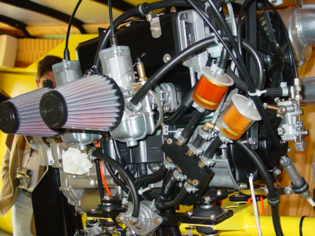

    --> Kolb-List message posted by: "Jeffrey Jones" <jeffrey.jones@fuse.net> ________________________________ Message 15 ____________________________________ Time: 01:50:48 PM PST US From: "Johann G." <johann-g@talnet.is> Subject: Re: Kolb-List: Re: Kolb-List Digest: 30 Msgs - 01/09/03 --> Kolb-List message posted by: "Johann G." <johann-g@talnet.is> Hello Jeff. I would like to ask you about the E type gearbox on your 503 Firestar. Did you or the builder have to do any modifications to the engine mount to fit the E-box ? I had heard that this was required. Very interested to add the electric starter on the back instead of the front side of engine. I also have the VLS BRS system in the front of engine, and no space for the standard recoil electric starter from Rotax. Best regards, Johann G. Iceland. Firestar II. http://www.gi.is/fis/ Do not Archive Johann, Yes, the engine mount plate is not from Kolb. A new plate was made to move the engine back 1" to clear the starter. The changes in the weight and balance is compensated by placing the battery in the nose cone. If you didn't notice, the pull starter is still installed which could be beneficial sometime down the road. The nose cone is from a Slingshot being it is deeper and allowing more room for the battery. The moment changes and battery location worked out great by keeping the bird within the envelope. http://www.matronics.com/photoshare/beauford@tampabay.rr.com.A.10.12.2002/dsc00584.jpg http://www.matronics.com/photoshare/beauford@tampabay.rr.com.A.10.12.2002/dsc00585.jpg http://www.matronics.com/photoshare/beauford@tampabay.rr.com.A.10.12.2002/dsc00580.jpg Take Care, Jeff Burlington KY
