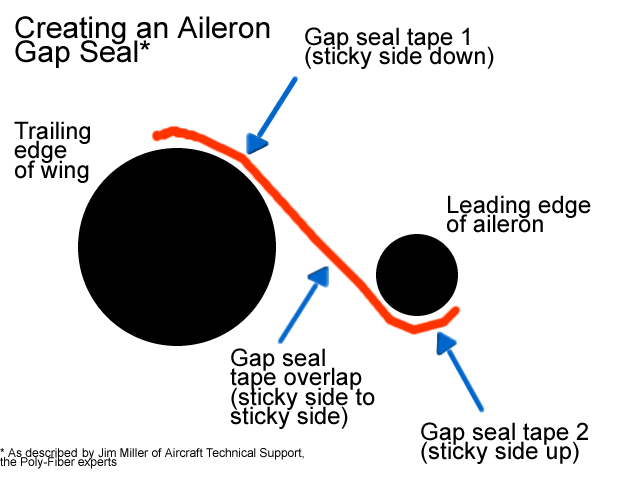

--> Kolb-List message posted by: "woody" <duesouth@govital.net>
Why does everybody ignore the advice in the instruction manual to use some
of the
extra stits fabric you have already cut off or some stits reinforcing tape?
It's free and dosn't have to be ordered.
I have always used it and I don't have to replace it every few years and it
can be painted with the airplane. KISS
----- Original Message -----
From: "Mike Pierzina" <planecrazzzy@yahoo.com>
Subject: Kolb-List: Gaffers Tape
> --> Kolb-List message posted by: Mike Pierzina <planecrazzzy@yahoo.com>
> Hey Guys,
> I was going to order some of that gaffers tape in white
for my aileron Gap seal.....But I don't put my credit
> card number on the computer.....So I called them , single rolls HAVE TO BE
ORDERED BY COMPUTER....
> Phone orders are a minimum of 6 rolls......
> If I did order 1 roll ....after shipping and handling it would be $20
bucks ( 1 ROLL )
> I'll be lookin for a different way to do this......Painting Duct tape
doesn't sound so bad right now...
> Gotta Fly...
> Mike
in MN

I'd take a long, close look at duct tape before I used it on a plane. It
doesn't take too long for it to begin delaminating and falling apart. Of
course, that may be due in part to the delicate warmth of the climate in
Furnace Springs. :-) Lar.

> Hey Guys,
> I have an address that K Fackler posted along time
> ago....it's a detail of the gap seal approved by Jim Miller of Aircraft
> Technical Support...The Poly-fiber experts...
> http://www.matronics.com/photoshare/kfackler@ameritech.net.10.03.2002/gap_seals.gif
> I found some 3M vinyl tape(white) that I'm gonna try.....otherwise I'll
> look for the colored duct tape at Walmart like somebody suggested on the
> "list"
> Gotta Fly...
> Mike in MN
> do not archive
> SNIP>>>>>>>>>>>--> Kolb-List message posted by: Mhqqqqq@aol.comlook
> around, you can find white duct tape. BUT I found some strong clear tape
> at mills fleet farm that worked well. what I did was put the tape on
> forthe gapseal and then put some tape on the other side of that (sticky
> side together) to keep the dirt from sticking to it.
