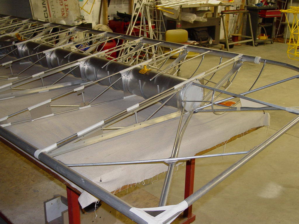

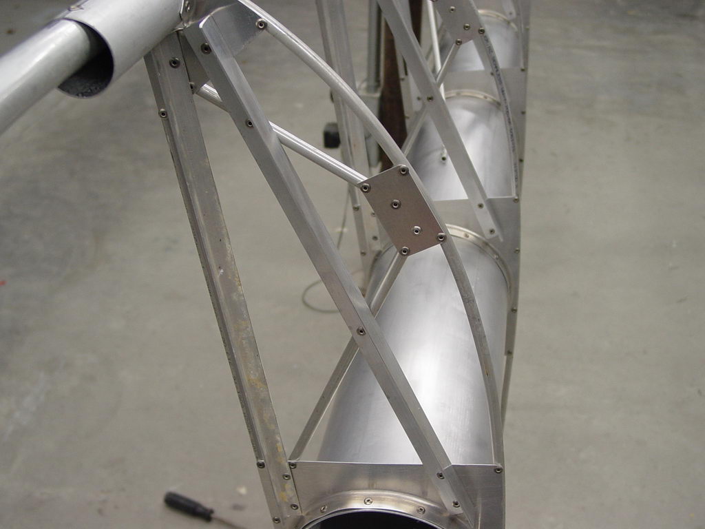

I am rebuilding the wingtips of the firestar, and will be using 3/8" tubing for
all of the bracing, false rib, instead of the 5/16" and 1/4"
Does anyone have any pics or suggestions from old archives, that show improvements,
such as the aluminum renforcing angles on the outboard ribs etc.
Thanks, Chris

Hi Chris,
Really good move streingthening all those areas. It only adds a few pounds and
adds a huge amount of streingth and stiffness. Here are some pictures of my
MK 3 wing with the streingthening you talk about.
John Hawk is also an expert on improving the streingth and stiffnes of the wings,
he is the one I that suggested this to me.
Dont forget to streingthen the wingtips also. There have been some cases where
the weak tips start to flutter and are just very fragile all around. Hope this
helps you out.

I really like the idea of douling the number of ribs in the wing. That will only
add a few pounds and will make it a lot stronger.
If more ribs becomes to daunting a task, streingthening the existing ribs is also
a possibility. Attached are some pictures of my MK-III wing with rib streingthening.
I would also suggest streingthening the wingtips while you are at it. There have
been a few reports of wingtip flutter at high speeds, and also that is just
a fragile area that gets a lot of abuse and handling. Streingthening that area
is just a good idea.
