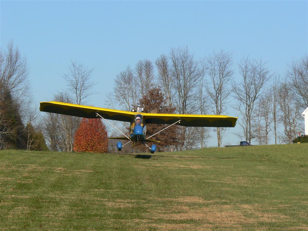

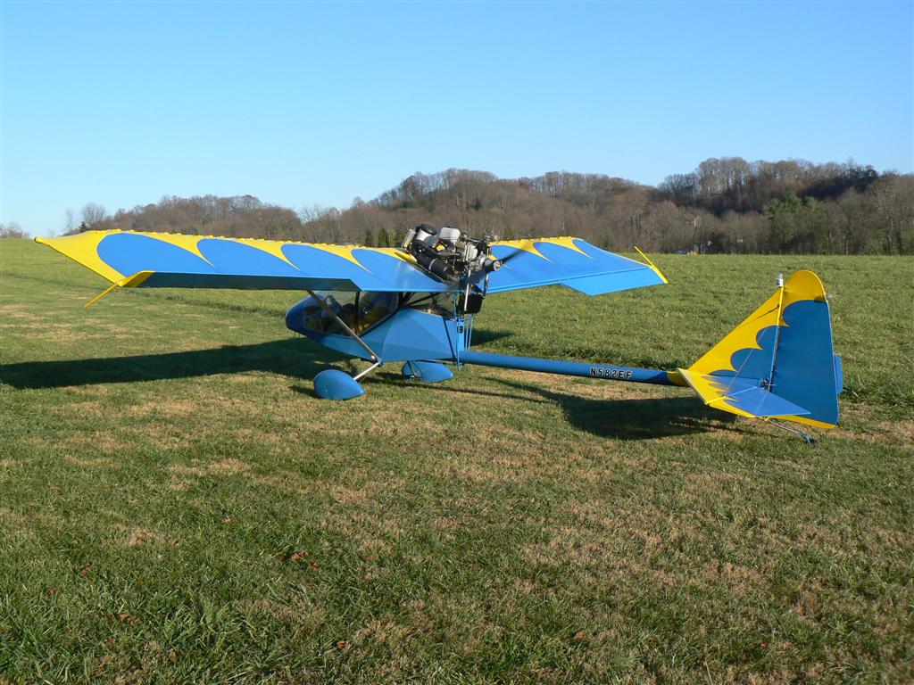

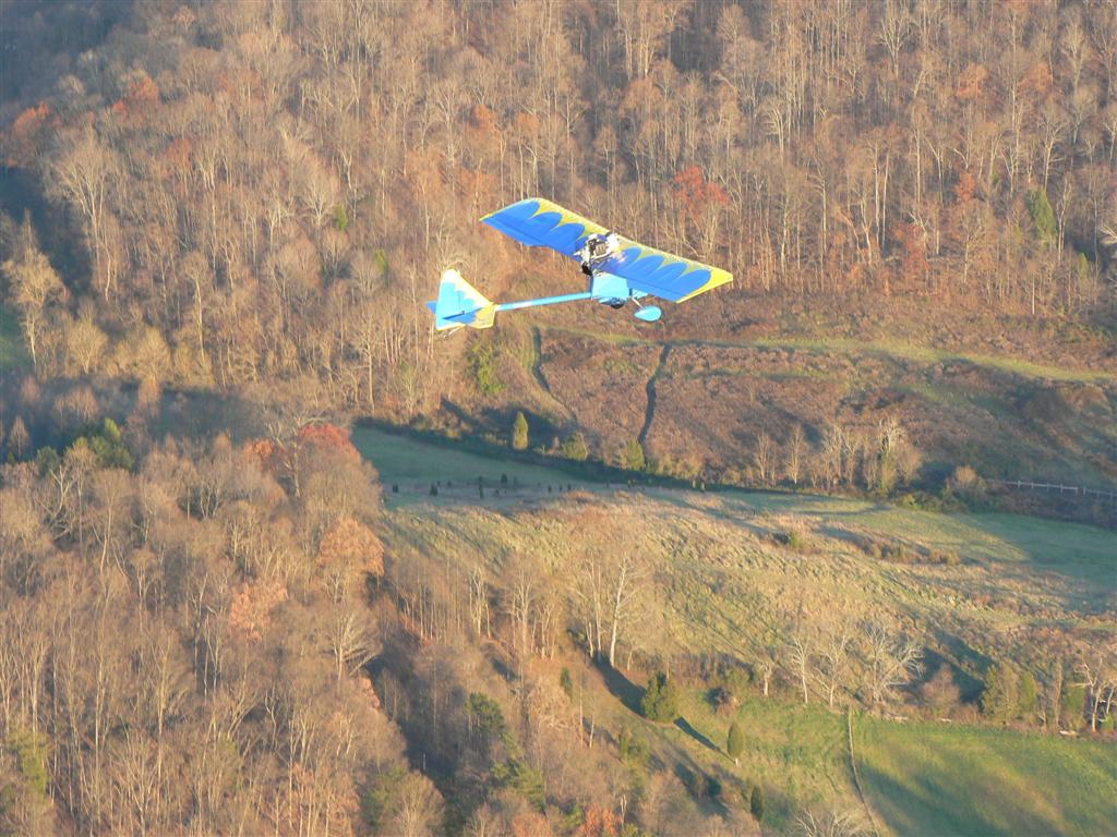

It flies hands off, you can drive it around with rudder only, and it seems
to handle very well. Flown it like that for a year, no negatives. I put my
MKIII in the garage yesterday, it is getting longer wing struts and we'll
see how it does.

> Hi Richard
> Thanks for posting the pics...I am amazed at how much dihedral there is on
> the wings.

>> Took some pictures of Ed's Firestar II this afternoon, some of them came
>> out pretty good.
>> After we got back on the ground, took my MKIII apart and put it in the
>> garage, time for some winter maintenance, fix that cranky radio that quit
>> working, and put some dihedral in the wings. Going to see if the MKIII
>> can be made to fly hands off like the FSII does.
>> Richard Pike
>> MKIII N420P (420ldPoops)
>see how it does.
Richard,
It seems like it would require additional rudder to side or forward slip.
This could be a factor for cross wind landings. Have you noticed any
difference? What is the actual dihedral in degrees? Has it influenced
roll rate?
Jack B. Hart FF004

Oops... Aren't Kolbs supposed to have dihedral?... Mine does, although
I've never measured how many degrees...

My FS II flies perfect with just a little bit of dihedral. I used to own
a TO-Bird, which had a lot of dihedral, I could fly it "hands off" but I
paid for it with a lot of adverse Yaw, meaning if I give it left rudder
the nose would go right.
